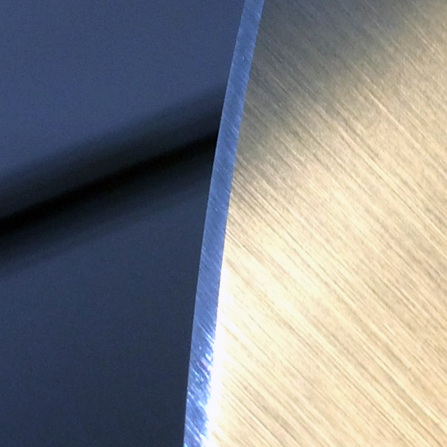

Edge (coarse side) after sharpening (Spydiechef, LC200N), showing scratches made by the #320 stone mostly intact.
Grit Progression from #150 to diamond suspension (1 micron) on the polished side of S35VN (Boker Exskelibur). The other side retains most of the scratches from #320 (not shown).
(This edge is over-polished with the diamond-loaded film to show the effectiveness)
