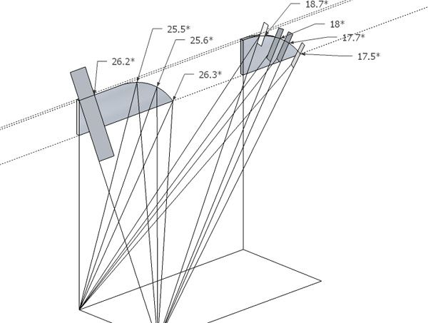

Hi,
Im having problem with polishing the edge. Im not sure If Im the problem or the stone.. I tried cleaning the stone and it also seems that it does not need to be flattened. The angle is also the same. I took a picture of the scratches. After couple of strokes they disappear and appear somewhere else. What could be wrong? :grumpy:
Did you adjust the edgepro for the new stone's thickness?
What are you using to wet the stones/clean them?
Do you adjust the knife's position on the platform when you do different areas of the blade?
Did you lap the stones previously?
Go back to the last grit and do the entire edge again. Then do just one pass with the next stone. Look to see where it ground the steel. Use a sharpie if needed.
In my experience those are the result of uneven pressure and angle. While the Edge Pro does help to control the angle, there is a small amount of "wobble" in the arm. The amount of pressure you use throughout your stroke can also change and cause these to occur.

As you can see in this diagram though...
(this is actually the same knife clamped at two different locations)
... the angle does change as soon as the stone starts tracking around the belly of a knife (and rather quickly depending on where it's clamped), which is why placement to follow the belly toward the tip is important.

5) I just did that and found out that those scrathes are there also from the 600 stone :-(
Ok, I think this could be my fault because sometimes the knife moves just a little bit. Do you guys have any idea how to make sure the knife does not move and always eds up in the same spot? With some knives it is no problem but for example this Rat-1 is quite difficult due to the blade geometry.

Yes, lap as in flatten. Most of the questions were to make sure you weren't contaminating the stones. You may still have a slight convex to the edge causing you to hit spots randomly. Try magnets on the bottom to help stabilize the blade.
Okay.
I was experimenting how to make it more accurate and this is what I devised. It could work - the blade is very stable and harder to move. Maybe I can find something better than cardboard.
You are on the right track. I would adjust the blade guide so the edge barely clears the table, and use the magnet. I made blade shims like your, but out of plastic drawer dividers.

To be even more clear, I'm talking about the fact that if you wanted to keep the angles precisely the same (in order to avoid those small artifacts referenced by the OP) you have two obstacles:
1. The "wobble" of the arm of the system (e.g. on my Edge Pro the plastic piece that the arm moves back and forth through allows a small amount of up and down movement). Lagrangian, who you referenced, also has an interesting thread discussing the rigidity of guided systems.
2. That as the blade curves along its length (blade length), the arc length of the blade changes as the blade is moved either closer or further from the base of the arm (that is, where the arm attaches to the guided system). On an Edge Pro, after dialing in the angle and screwing it stopped, you can change the angle (even when measured by Angle Cube) by moving the blade closer to the base, or further away from the base. To put it another way, if you change the distance from which the blade is clamped onto the system, since the point that the arm is attached doesn't move, then the angle changes as the adjacent and hypotenuse change.

Ah. A better explanation, thanks. Most of that really doesn't matter though, just be consistent in what you do.
I think the problem with the knife in the original post, is not setting a good bevel, then not spending enough time going thru the stones to clean up the edge. A resharpening with the shim he created, and working thru the stones again will most likely solve the problem (a path he was headed down anyway, so didn't think it was worth mentioning).
