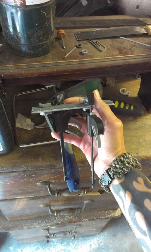

Hey guys. As I was using my 120 grit stone it fell away from the aluminum blank.
What should I use to re-attach it? The glue that's on there is stretchy, stringy stuff.
Also, any reason in particular that this happened? I use a normal amount of mineral oil with it, so I'm sure that the oil soaked in and got to the adhesive but I would think that they are put together with this in mind.
All I have for adhesives are super glue, 2 part 30 minute epoxy, wood glue, contact cement, spray glue and "quick grip" which I'm thinking is the best choice.
Help.
Pretty sure the mineral oil was the cause of the separation. I think they use rubber cement on the stock stones. Perfectly fine with water, But not so much with oil.
The 2 part epoxy will probably be your best bet to reattach the stone, But I don't think that will stick to an oil soaked stone.
Try gorilla super glue. It's a strong glue, activate by water. Make sure the clamp the stone to the blank until the glue done with initial cure.

I hope you don't think that I'm an a-hole for asking for advice then going my own way, but I decided to use this.
Sorry the pic is sideways.
I realized after re-reading the label, and from past experience that that was probably the best choice from what I had to choose from. The 2 part would have probably been great, but I didn't want to sand the blank. The quick grip, and I'm only even writing this in case someone searches someday, is really strong in my experience, apparently it's waterproof too and flexible so it might be somewhat similar to what they use at the shop where they assemble them.
Anyway the stone is boiled and glued up and in clamps now. I'll report back tomorrow to let you guys know how it turns out.

I only leaned toward epoxy because of the oil. I have a similar product to quick grip called E-6000. One of my chosera stones is starting to separate from the stainless base. The metal itself is warped. So I'm going to pull the stone off, take it to work and straighten it in a 6 inch machine vise. Hooray for being a machinist and having access to tools! I'll get it to within .001 before I glue it back down.
