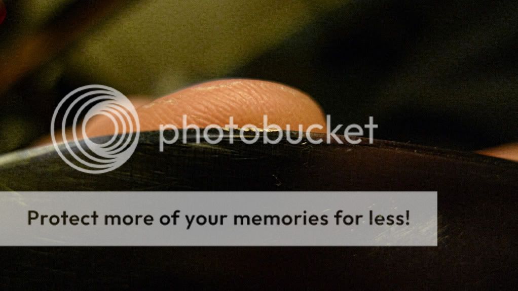

There's not a whole lot to look at, it looks about the same as when it was convex. Because it's thin at the edge the bevel remains small, unlike the massive relief bevel I used to get the boss jack down to a reasonable edge thickness (last picture in this post).
This is my method of testing the edge (besides visual inspection). You can't even see the skin that was lifted up in this image after the knife was taken away, it's equivalent to the scratches you'd get from picking up a sharp rock or doing yard work, but it allows me to feel minute variation in the edge. Because i can feel the difference between a 200, 600 and 2000 grit edge I can tell if I've missed a portion of the actual cutting edge with a given stone as I move from 120 to 600.
