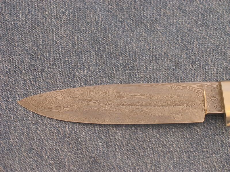

I don't know if this has been discussed here before or not, but I would like some opinions. What are some of the folks here thoughts about this. I know a lot of top name makers do this, and I understand the hard edge , soft back concept, but I personally don't care for it as I feel it detracts from a well made damascus pattern. I love the clay coated blades with the wild hamons in plain carbon steel like those of Don Hanson and others, but to my eye it does nothing for me on damascus blades. Any thoughts here?

Joe, here's an example of a distinct hardening line on Jerry's "dogstar" pattern damascus, which actually designed around highlighting the line.

As Joe said it depends on the knife and the pattern. Personally, I usually do not have a pronounced hardening line on damascus blades. I fully quench the blade and draw the spine back, but no distinct line. Of course there are exceptions. So it is personal preference as Roger says. Basically it comes down to what the customer wants and I will try my best to do it.

imo, hardening lines on damascus blades look ugly. all of the knives shown above would be MUCH more appealing without hardening lines (actually, i even think they ar not attractive at all...). either damascus or hardening line, never both on the same blade. but to each his own!
hans

well, the exception proves the rule! :o :foot:
these knives are too cool! :thumbup:

Don, that third one is awesome!
Personally, I don't like differentially heat treated damascus. Generally speaking, :barf:
I have seen some that I liked, but I would have liked them way more if they were not.
