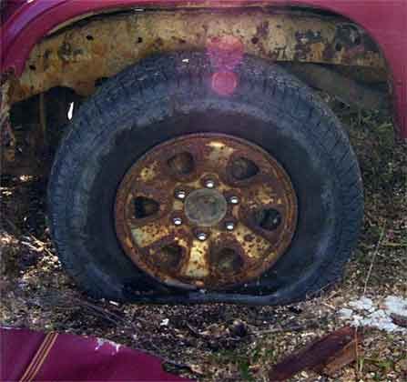

I needed some rubber for firestarters / signals and so :
http://i7.photobucket.com/albums/y269/CliffStamp/Spyderco/Salt/tire_flat.jpg

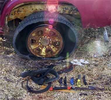

was utilized. I had a bunch of knives and this was quickly discovered :
1) The UK Pen cut well, but putting the point through the material as well as cutting could cause the blade to fold if you were in a hurry or didn't use a lot of care. I removed a strip without problems, but based on working with it and making it fold intentionally to see how difficult it would be, I would want a locking folder.
2) Sharpness made more of a difference than profile. Once the initial cut is made it isn't difficult to get the rubber to seperate and thus a Delica cut just as well as the Pen or Poliwog, and I had reprofiled the Pen to a 10 degree edge bevel.
3) You want a sharp point to start the cuts, the Dodo went in easily and it was the only knife that didn't even need a slice. Just press and pull and the side of the tire was gone. The Alantic Salt aggressively cut through the side, but starting a cut took some time.
4) You can actually cut it with a fine saw, assuming you can open a hole anyway, it is was less effective than a knife, it chews it up more than cuts it, basically the entire length of the saw blade would cut as much as the Delica with one slice each and it took a lot more force with the saw.

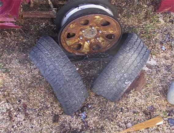

Cutting the tire into pieces was much harder, they are reinforced with steel wires and the plain edges blades could make no headway, just a few slices, and the edges were all reflecting light, VG-10 or S30V made no difference. However the Alantic Salt chewed through it :
http://i7.photobucket.com/albums/y269/CliffStamp/Spyderco/Salt/tire_sectioned.jpg
This took about five minutes and I had to stop three times, it needed a fair amount of force to cut through all the metal, the rubber in contrast was really easy.

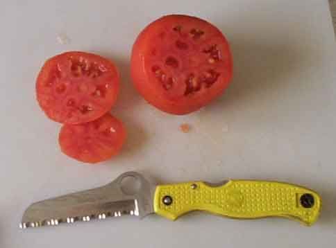

At the low right of the picture you see a piece of wood which is pointed ,that was done with the Salt after the tire cut, the knife could still readily cut woods, in fact did so better than the plain edged knives and yes :
http://i7.photobucket.com/albums/y269/CliffStamp/Spyderco/Salt/alantic_salt_tomato.jpg
This steel cutting however did put a fair amount of wear on the Salt, mainly it rounded the points, however there was still a lot of cutting left in the knife.
