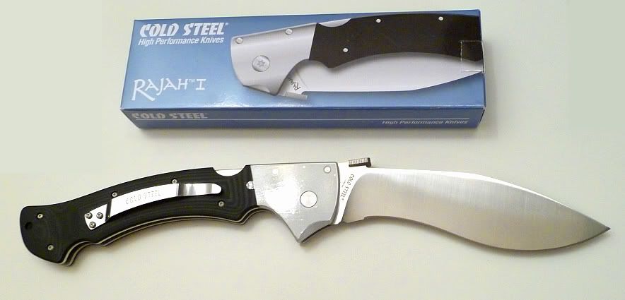

The Cold Steel Rajah is probably the strongest folding knife ever made. It's a great
survival knife and, again, it has an AUS 8 blade.
