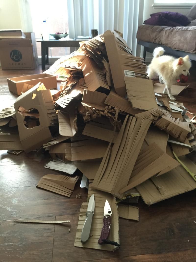

Hey guys,
A few weeks ago I finished up a second test run of my S30V Spyderco Paramilitary vs my S30V Michael Raymond Estrella with Michael's personal heat treat. Michael's custom heat treat involves the full gamut -- Cryo in Liquid Nitrogen, Oil Quenching, etc.
Obviously the heat treat is going to be better on the Michael Raymond vs the Spyderco but just how much of a difference? I tested both knives side by side and used both blades to cut the same pieces of cardboard to minimize variables. Both knives are at 30 degrees primary with 40 degree microbevels. Both knives cut along 2.5 inches of edge.

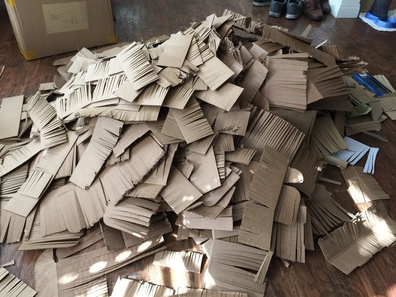

On the first test run cutting cardboard the Raymond blew the Spyderco away, it was not even close. On the second test run the result was the same. I did not need to cut very much cardboard before the Raymond started pulling away in holding its edge.
Because the edge retention on the Raymond was so impressive, I decided to test it vs my Spyderco Calypso Jr in ZDP189, something I had never considered doing since ZDP189's edge retention should obviously be better than S30V. The ZDP189 on the Spyderco I believe is ~65-67RC, much harder than Michael's S30V at only 60.5 RC. This test should also be more fair compared to the one vs the Paramilitary since both the Calypso and Raymond have thinly ground edges. On the first test run the S30V Raymond actually held its edge longer than the ZDP189 although it was very close. I did the test again, and the second time, both steels were even closer. I had to cut a LOT of cardboard for both of these runs but the second run is taking much longer since both knives are still so close in edge retention. When the test is done I will update this thread but needless to say S30V with a custom heat treat is a true performer!

Hi Arty, both knives were sharpened to 30 degrees and have 40 degree microbevels. I tried to keep all the variables as consistent as possible. Both knives are still cutting through cardboard, I plan to finish the second run hopefully in the next day or so.

Both knives were given microbevels on the sharpmaker browns. After the first run, 25 passes per side with medium progressing to light pressure. Both knives were deburred by lightly cutting into the stone at a high angle then extremely light passes on both sides 2-3 passes unto the knife will readily shave my very fine arm hairs on both sides of the edge. I have never tried to get the edge to whittle head hair simply off the sharpmaker brown stones, I have done that off the white stones. Will definitely try to get the edge to whittle hair off browns in the future.

The cardboard was pretty mixed but pretty clean cardboard. For each piece of cardboard, both knvies made equal cuts on each piece.

I don't have a good way of determining which knife is sharper except by feeling with the skin of my thumb. On the first run of the ZDP189 vs S30V, the S30V was far enough ahead, that I felt like I could end the test although you are correct in that there have been times where I noticed one steel will feel ahead of the other then change back so it is possible that I ended the first run too early. The second run, I plan to just keep cutting until one of the knives will tear the cardboard even with a slicing motion. Suggestions would surely be welcome as to a better way to determine when to stop the test to determine a winner.

I finally finished the second run of cardboard cutting and on the second run, the S30V Estrella edged out the ZDP189 Calypso Jr again, but this time by a very slim margin. I had to keep cutting because both steels were so close all the way through the test. Towards the end of the test, the Estrella was able to whittle a wooden chopstick whereas the Calypso Jr would slip, albiet the difference was very minor. Both knives cut through a ton of cardboard and at the end of the test, both were still cutting the cardboard cleanly.
