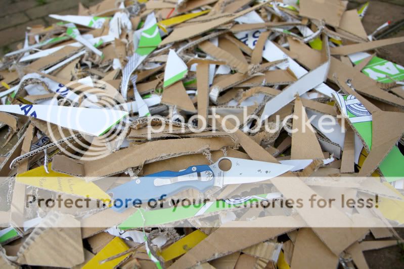

Cardboard demolition:
Clearly not my forte- though the knife sliced really well (I stuck to going across the corrugations, the more demanding way.) One box had a load of gluey stuff in the seams and was much harder than all the others. Luckily no staples.

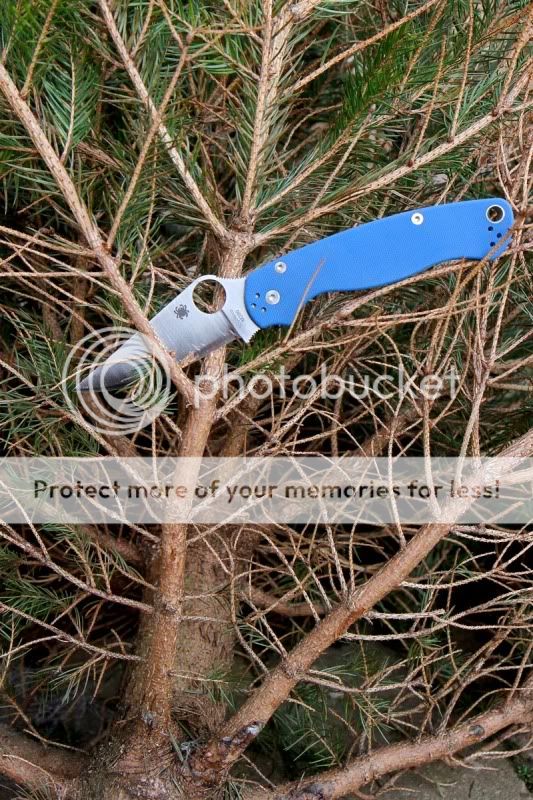

Christmas tree demolition:

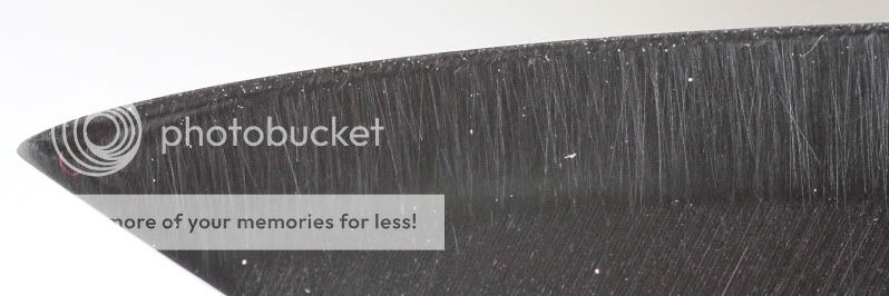

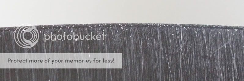

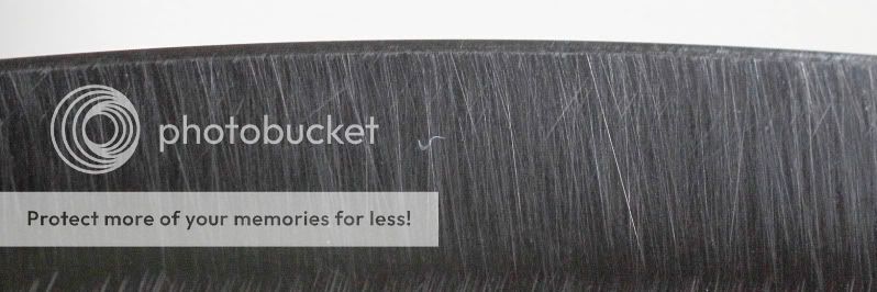

Edge after EDC:

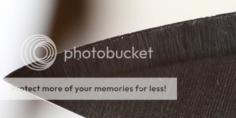

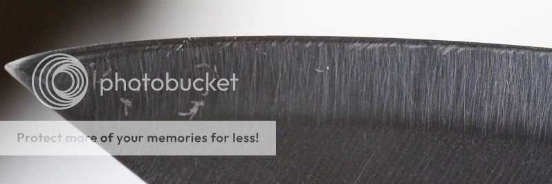

Edge after EDC and card:

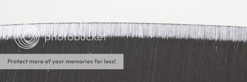

Edge after EDC and card and tree: Subtle Micro-chipping in a few places.

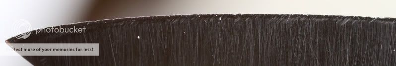

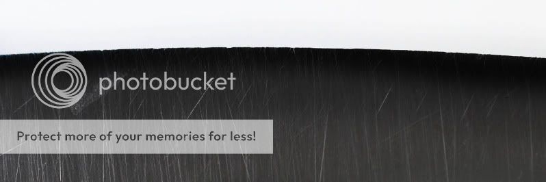

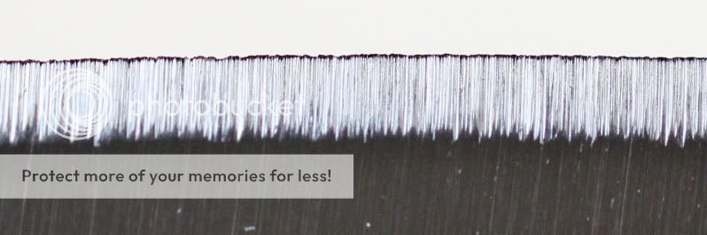

In comparison- Unused factory edge:
The knife still feels sharp to the pulp of a finger dragged perpendicular to the blade and it will still slice free-edge of printer paper but without that silky, resistance-free glide it had before. It won't shave forearm hair but is cutting well in realistic tasks.
In short, I am impressed with how well this edge has held up to my EDC tasks (and more). Personally, I do not need a knife to rip up plaster board and I wouldn't choose a folder for this task; I doubt this edge would stand that sort of use for long.

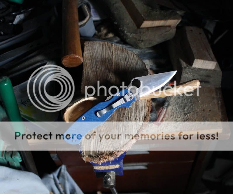

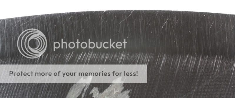

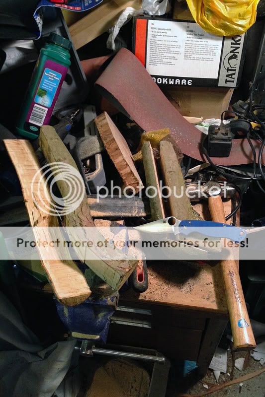

As suggested in my original post, I put a 30deg microbevel on the PM2. The knife has been used for lots of cutting since, in particular I carved some ebony and a spoon from spalted hawthorn (I think?):

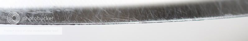

Unused edge after microbevel:
After Ebony carving:

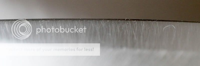

After spoon carving:
Clearly there has been some edge damage but the knife still cuts well and feels sharp. This was a serious work out for the knife and for me as I didn't rough out the spoon shape with an axe or saw (apart from splitting the round in half.)
After protracted carving (3+ hours) the handle was feeling pretty uncomfortable but no actual blisters and no cuts. Pretty good for a slimline folder.
