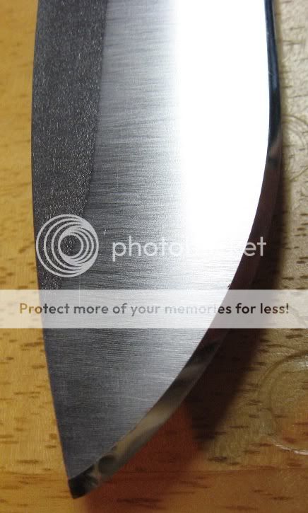

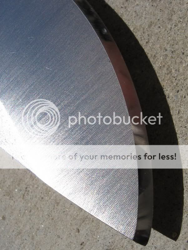

I just used the Edge Pro on my BATAC and it didn't take much work to get back to being scary sharp.
TL... you're part of what prompted this thread. ;)
That's some edge you put on that BA... very nice!!!

Thanks and it is only made possible via an Edge Pro. Freehand, on the other hand, I need some practice. :o
Ya know, TL - you'd have an easier time if you'd stop hammering that Badger into stuff.
Where'd be the fun in that. ;) Seriously, I think my Badger has done its duty. Back to regular chores and on to the next victim. :)
I do that to some of my users with an Edge Pro. Then for some time, depending on usage, I just steel them or hit them with a strop and they come right back. Overall though, I greatly prefer a full convex edge. :thumbup:
