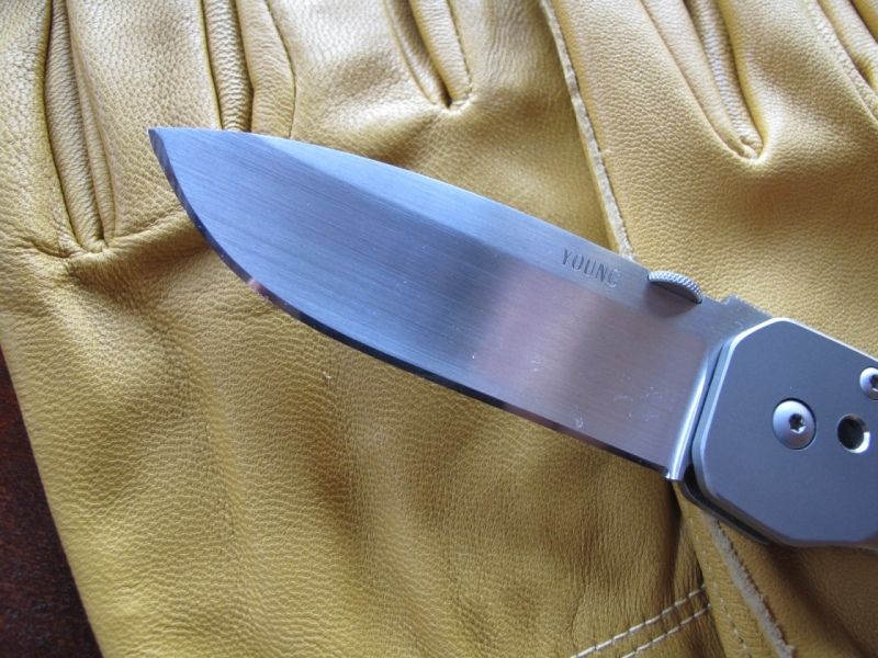

This is a Marty Young folder of CPM-154. Great knife, that I felt could benefit from a re-profile to get the most out of the steel.

I found this earlier shot of the Marty Young:
And the reverse side:

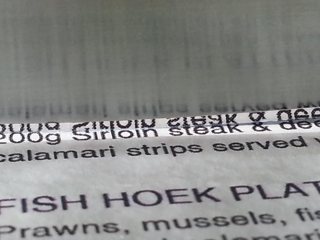

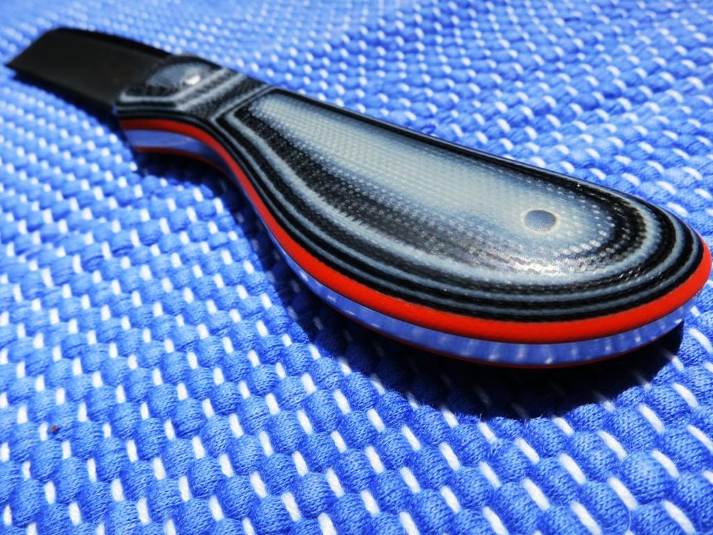

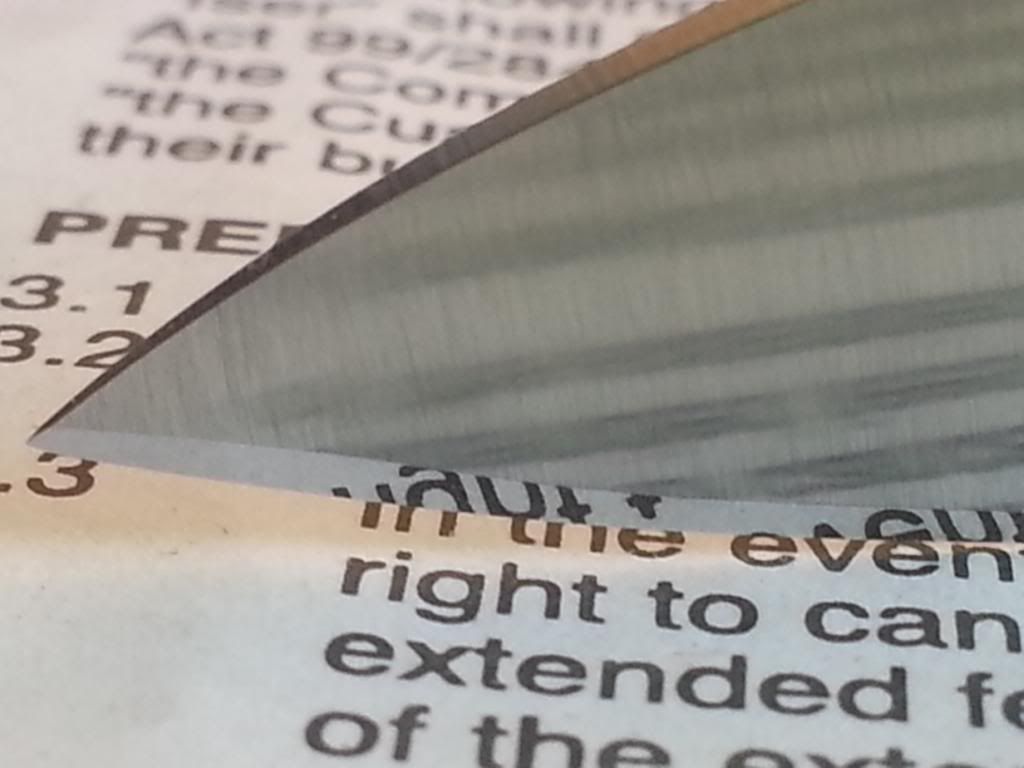

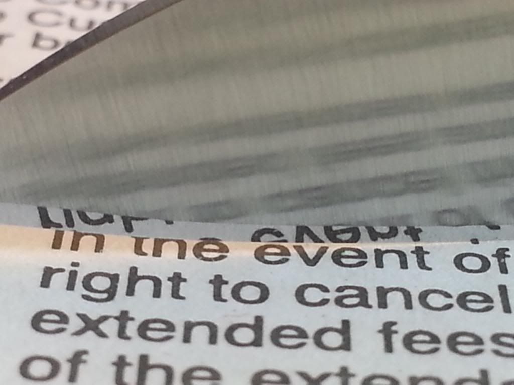

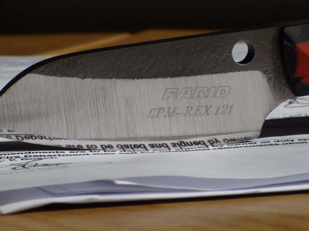

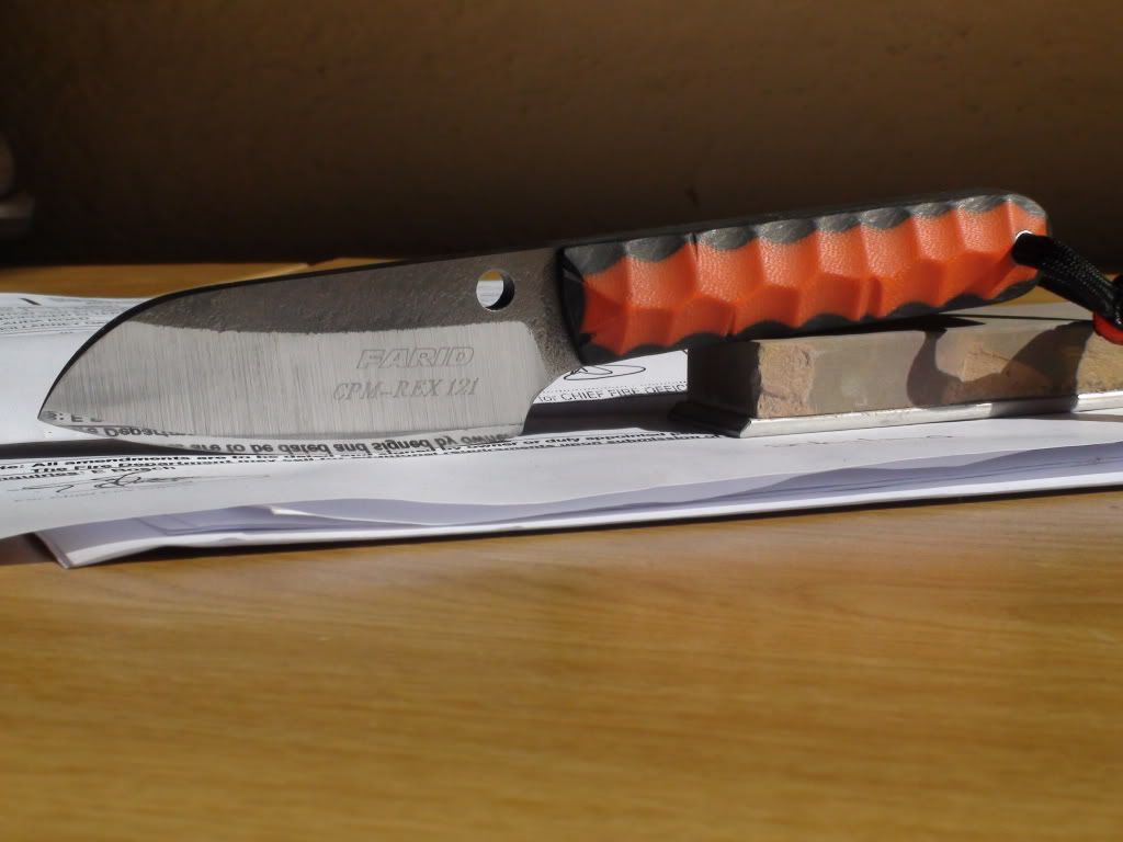

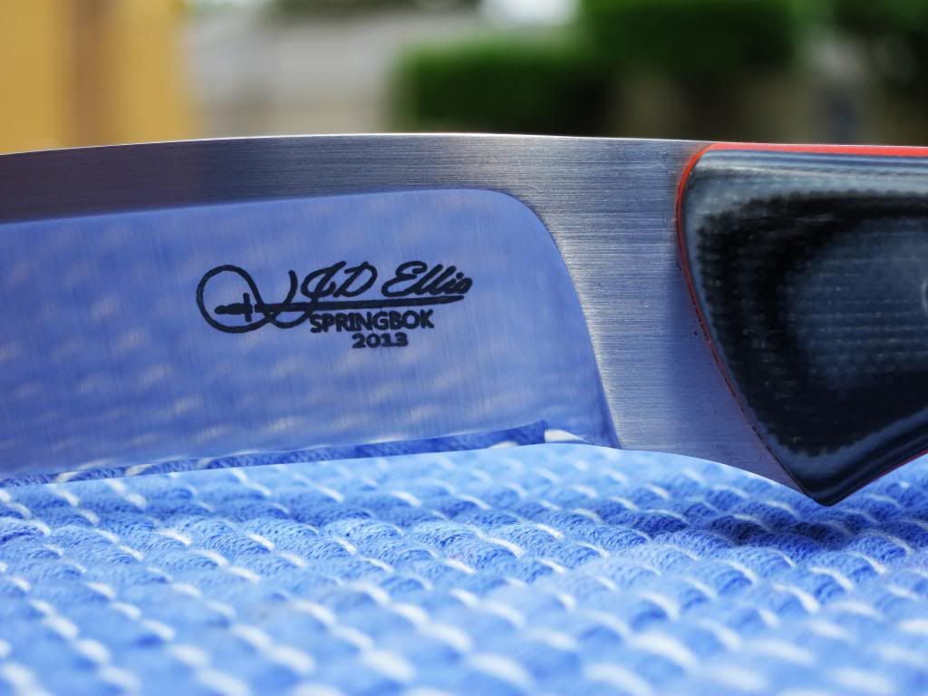

...and a couple of stills....
All the blades in the vids & pics are my own blades and are either S90V, S110V, M390, CPM-Rex 121 or K390 - I like the hard, abrasion resistant steels with phenomenal edge retention.

MR, those still shots are really something. I don't know whether to be inspired or depressed (that I'll never come close to that!).
Beautiful work in any event. :thumbup:
Andrew
Those are great pictures.... Your edges look very similar to mine, except mine aren't very shiny, even or sharp :D
Thanks for shedding some light on your processes and equipment Rook, those pics are mind-blowing dude...
