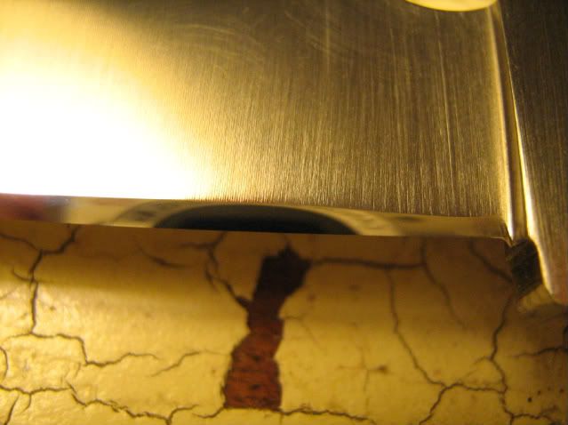

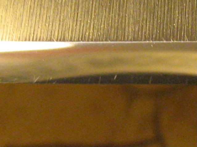

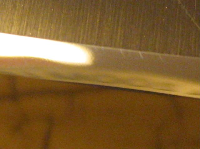

Not all the pic's are that clear, its hard to take a pic of a polished edge without the right lighting. A little step by step that I did on a S90V millie.
Spyderco UF ceramic
1 micron diamond paste
0.5 micron diamond paste
and a little backed out view
Amazing pictures knifenut1013 :thumbup:
