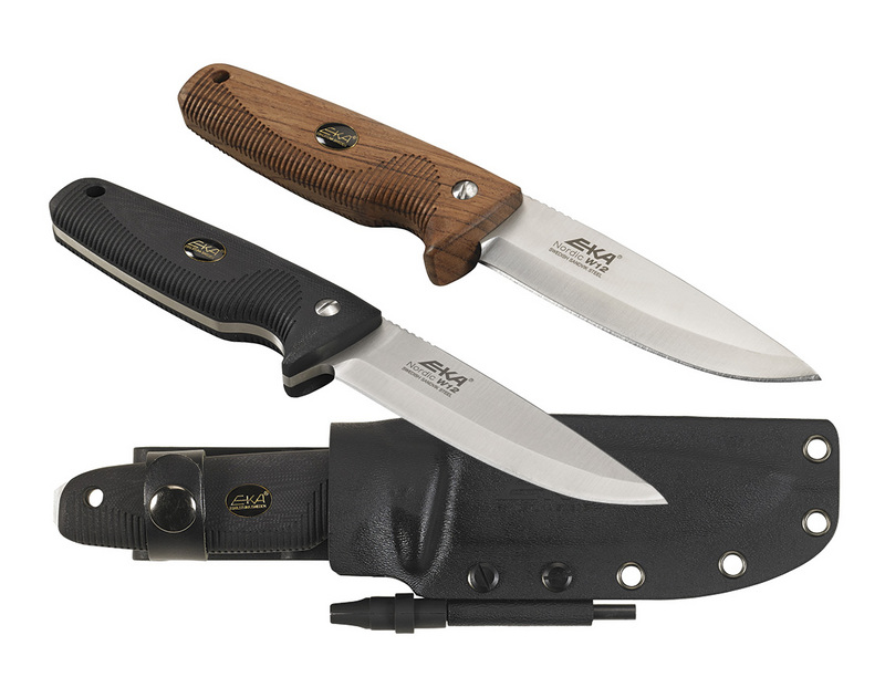

Hi, does anyone know if the tang is different on the wood handled version than the g10? I assume it must be because the wooden version is morticed tang, whereas the g10 version is a visible tang.
Also, has anyone tried these knives?
I'm pretty sure the tang and the blade are the same for the two models, but the wooden one has a slightly beefier handle that covers the guard and the tang.
Hi! At the time of my purchase, a couple of years ago, there were no differences between the models, beside the one correctly pointed out by Larcivs Lepidvs. The tang it’s exposed in both versions in the same way.

I got the G10 model. I studied both it and the wood handled model close up and realiced the wood model simply can`t have the full tang of the G10. There is no tang in the belly or fingerguard of the wood handle.

I am certain the two tangs are different. Getting wood to fit around the tang of the synthetic version would be a minor wood working miracle.
If anything, it is probably a semi-full tang, as used in the Helle Temegami:
In this pattern, the single piece wood handle is slotted on top and the blade slid down into it, then secured with cross pins or screws.
I honestly do not see how it would matter, as it appears the steel disappearing into the wood handle version is stouter than the area where the plunge line meets the fuller. If the blade were to ever break in hard use, it is more likely there on either version than under the handles.
So if you are asking out of strength concern, I would say there is no important difference in strength and buy the handle you like better. The wood one would be more comfortable if the knife gets very hot or cold since it has less exposed metal.

Actually not. because the back of the tang is still exposed, so the fitting of the wooden handle is simple.
As anyone could see, the wooden handle is wider than the G10 scales, so it covers part of the tang. is this so difficult to understand?
RX-79G, that`s just how the tang seem to be. The g10 and wood handles is of the same size, there is no way the wood can cover the tang of the g10 model. Looking closely on the photos above show how the tang is different where it dissapear into the handles.
My only worry with the wood handle is the, small but real, possibility for the fingerguard, without tang inside it, to break.
I don't see why it would. That is a pretty stout finger guard, finger guards don't receive much (or any) force, and the worst that could happen is that you wouldn't have a finger guard until you fixed or replaced the handle. But the knife would be fully functional even if it happened.
Wood is not as tough as steel and plastic, so if you need a bombproof knife, go with the synthetic. But I would happily take the wood one into the wild with me. Eka knows what they are doing.
