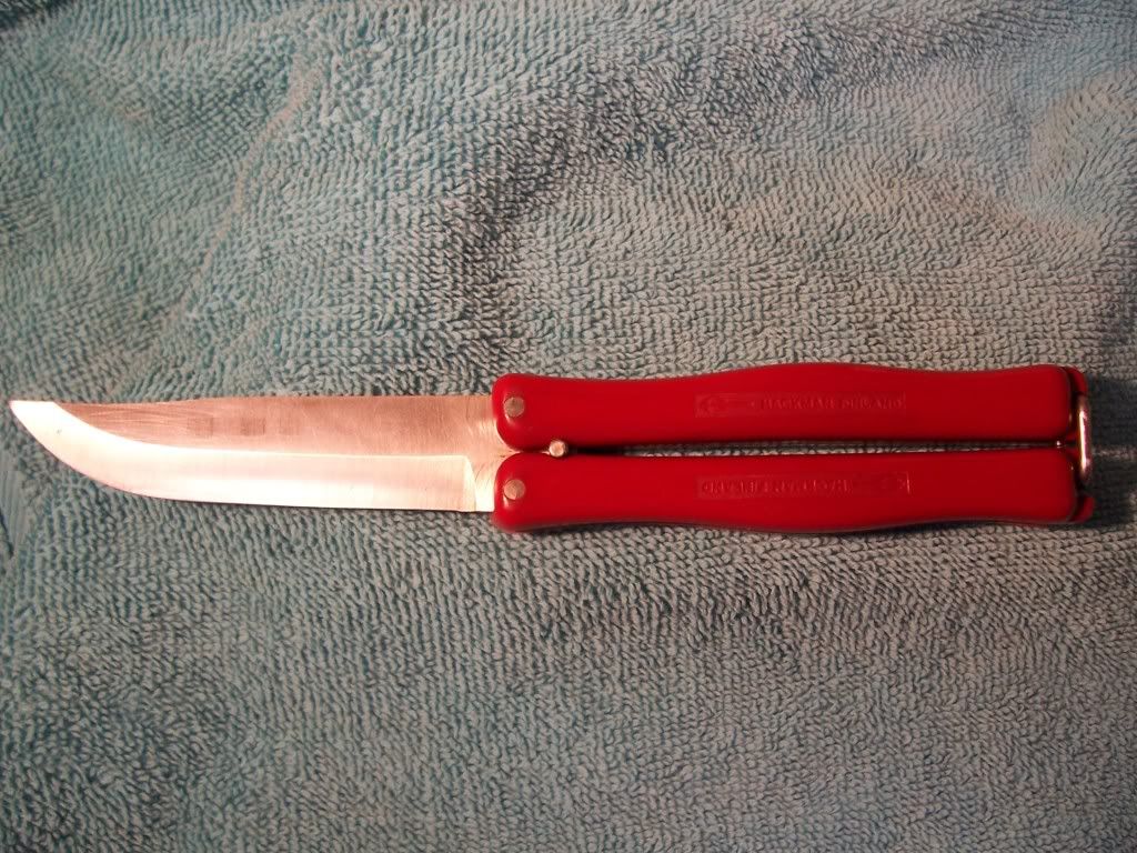

I have one that looks exactly the same that I got in the '60's. I cannot remember the price.
Mine is labeled
HACKMAN FINLAND
I have no idea of the alloy, but it holds an edge nicely.
I carried a lot at one time.
I'll see if I can't fire up the scanner and get a pic.
ADD: Forgot. Scanner has no depth of field.
Camera pic is not good but will have to do.
The old Hackman and the current Ahti were made by the same manufacturer. The handles are exactly the same size. The current version blade is slightly thinner, which is why they put that spacer in at the tang, not for smoothness.
