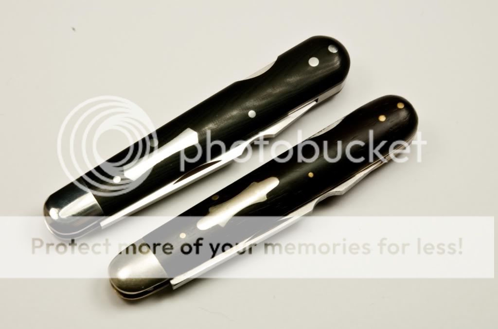

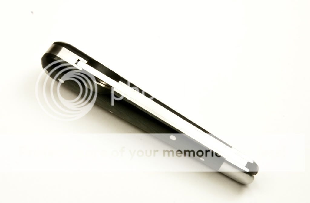

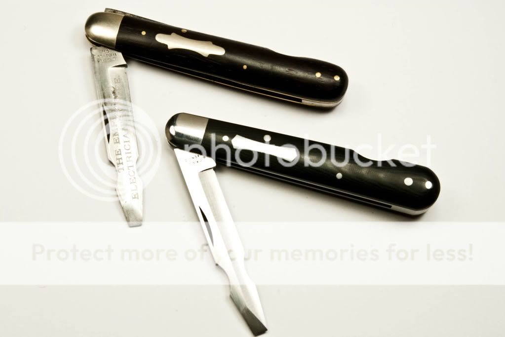

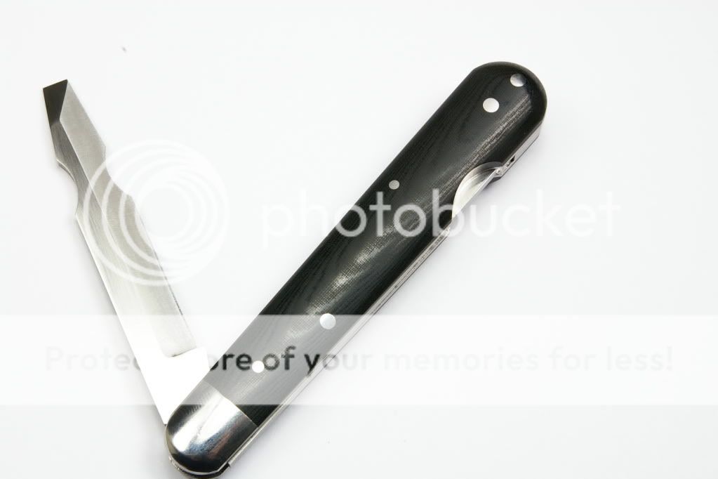

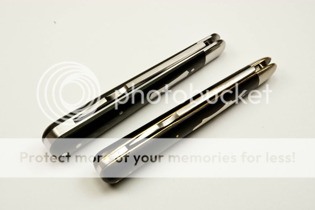

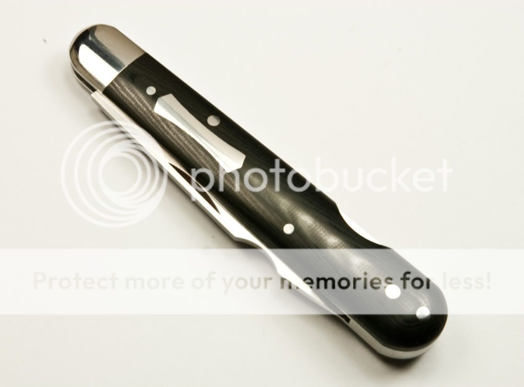

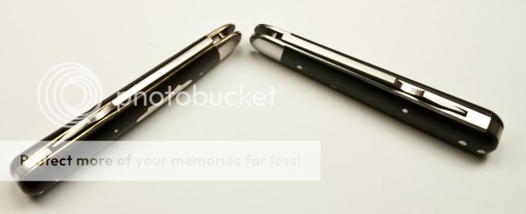

Recently I was given the opportunity to examine a collection of vintage knives. One of the knives caught my interest for a few reasons. I think it is a neat pattern, a working knife and one seldom seen in the handmade realm. While this knife is not available (going to Blade) I wanted to share here. I know this knife is out of the "norm" for handmade traditional knives but thought it deserved some attention.
This knife is based on an Empire Electricians knife. 3 5/8 inches, lockback, Ebony with a screwdriver/wire stripper blade. My rendition comes pretty close although I chose to scale in black linen Micarta. I used D2 for the blade lockbar and spring. I also installed a shield that is common on Empire branded knives.
Thanks for looking, comments welcome.
That is darn cool. :thumbup:
I used to work as an electronics tech, and I would've LOVED to have that in my pocket at work.
Very nice.
That's a darn useful looking setup. Thanks for sharing it.
Very cool! The micarta and Empire shield are great touches. I'd love to see more custom tool knives!

Ken it really ,really looks perfect.
Did you see the Empire version,where a blade just like on yours,locks open,but un locks by depressing a second spearpoint type main blade ?

Fair warning - if Ken's version matches the strongly tapered and rounded hafting of the original Empire version - and it certainly appears to - then picking this knife up may be dangerous. You won't want to put it down. A beautiful rendition of a great old knife in a great working steel - D2. :thumbup: Somewhere off in the distance I think I can hear Charlie breaking into his piggie bank. :D
A weird thing about most of the old Empire Signal Corps two blade style was that the blade nail nick was on the opposite side - most makers sensibly placed the blade nail nick accessible thru the top wire stripper notch instead. Pressing down on the blade actually lifted up the screwdriver blade's spring to unlock it -- the lock tab there was very similar to a lockback's, but it had to be a shallow notch since the spring wasn't lifted much.
