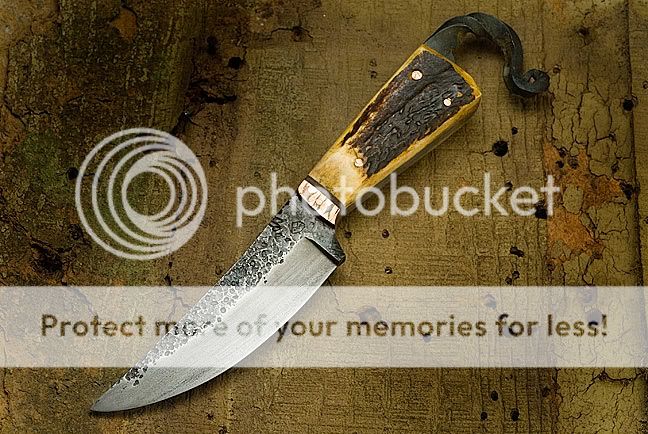

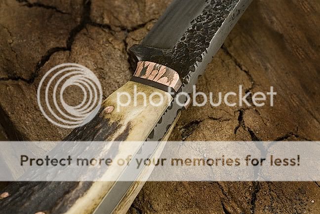

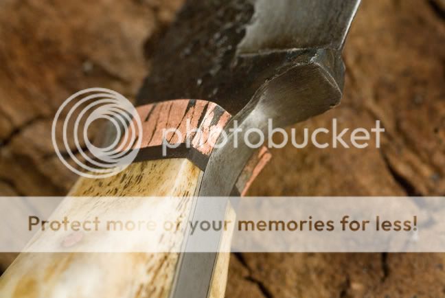

I had a scrap piece of Aldo's 1084 with a long, thin piece hanging off the end from something I cut off so I forged it into a rat tail. Then I forged the knife into what I like to call a 'longhunter' with a swept back tip. I had some elk antler sitting around so I threw that on there with some nickel silver liners. Scratched in some filework. Wasn't sure what to do about bolsters. I wanted to do something different. So I took a 1" square tube filled it with some copper braid and 1084 powder and threw it in the forge to see what it would do. Well I got copper braid with 1084 filler is what I got and made some bolsters spaced by birch bark.

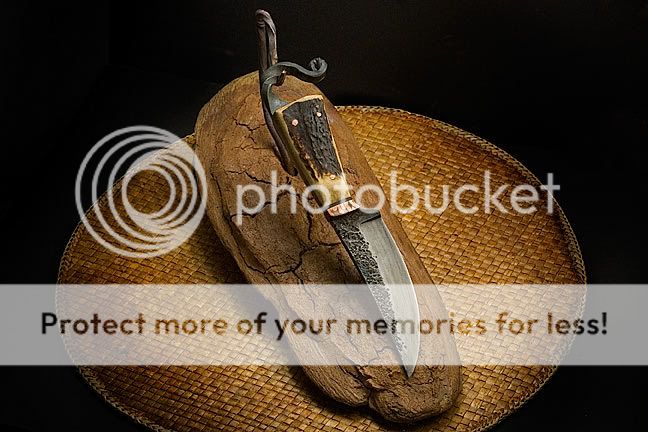

Then I figured I needed something to put this knife on. So I took some micaceous clay, mixed it with some water, strands of sheep wool and wood ash and baked it onto some driftwood and shellacked it. I went on to forge some copper into a stand that would fit through a hole in the driftwood.
This is what came out...
(I apologize for not sharpening it before photographing!)
