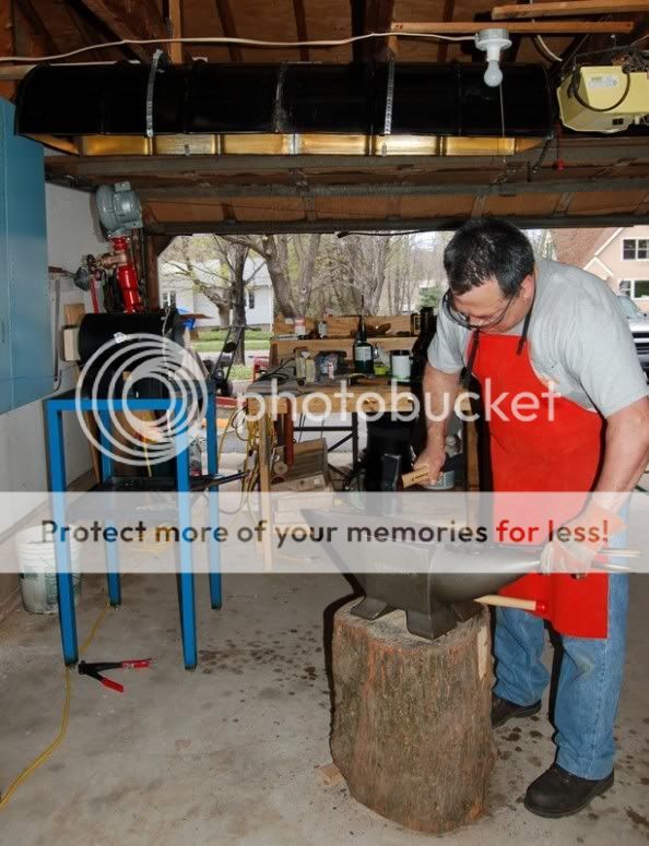

Today was the first day I used my new 8x13" blower type forge by Darren.
I do not have many hours forging blades but I would like to comment on Darrens forge.
It is pretty easy to setup. (directions are good).
It does reach forging temp.
The blower he recomends cost about $135. but there are others out there.
The thermocouple he recomends works good and if you get the protector tube
it will fit in the thermocouple pipe if you scrape the pipe out with a long drill bit or a file. ( I would recomend doing this befor lining the forge as to not damage the lining.)
A 20lb tank is good for a test run but I plan to have a larger tank installed.
Here is some pics of my set up.

Hi Dave,
Looks great! With that blower, that forge will get screaming hot, you'll never wish you had a better blower. You can also Tee off of it and put an air dam on the forge if you want to, it's got more than enough cfm to do both. :)
One suggestion, rotate that burner down so it hangs off of the end of your forge table, that's the orientation it's built up for, the controls will be easier to access then.
Thanks for the feedback on the forge, Dave, I appreciate it! :)
-Darren

loussharp1 - There is another good reason to turn the blower arm downward on that rig. When you shut it off the hot gasses will go up into the blower. This can be very bad if the power fails while the unit is running,as there will also be gas rising in the blower pipe.
Stacy
