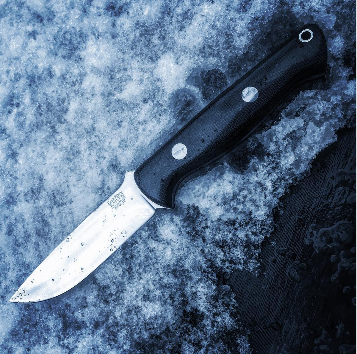

if I could I would choose a few different steels before this one as a fixed blade camp knife but right now I'm limited to stainless because I'm impatient and don't want to wait forever for another knife.. is elmax a good steel for a fixed blade? Will the edge chip out if used to baton things? I'm not worried about breaking the knife just worried about chipping the edge really. How would you compare elmax to an esee knife in toughness?
I'm looking at the elmax gunny.. if I were patient I'd wait for another run of the 3v but I'm not.
For stainless, Elmax is about as tough as it gets. It makes for a great fixed blade. Toughness means resistance to chipping and breaking.

elmax has pretty good toughness, but heat treat, geometry and thickness is what will make it work or fail for those tasks.....more than which steel.
yea I've read some bad things ab Mike Stewart and brk.. I'm sure every big production company has bad stories somewhere.. I guess the question I should be asking is how is bark rivers elmax steel in terms of toughness
If it is heat treated properly and has good blade geometry, you will have no problems. People, myself included, have fixed blades in M390 and 20CV, that get batoned a lot.

Elmax really shines for toughness. AEB-L will be a very tough non-powder stainless, too.

The blade is like 4 and a quarter.. overall I know it's 8 1/4 so maybe the blade is a little smaller... .156 think.. I'm set on another gunny actually.. love the desert ironwood handles

the 1095 esee uses is not the toughest in my experience. I have chipped it and its decently soft in comparison to elmax. I would say aside from it being easy to sharpen elmax wins out in ever regard compared to an esee 1095. For a Bark River try to score a cruwear. It is some awesome stuff and out cuts 3v which rules. I would go 3v over the elmax. 3v isnt a true stainless but, I use mine in wet weather camping and cooking with zero rust or spotting issues. Edge retentions excellent and its very tough stuff.
