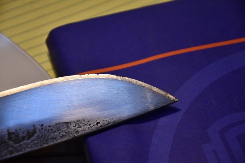

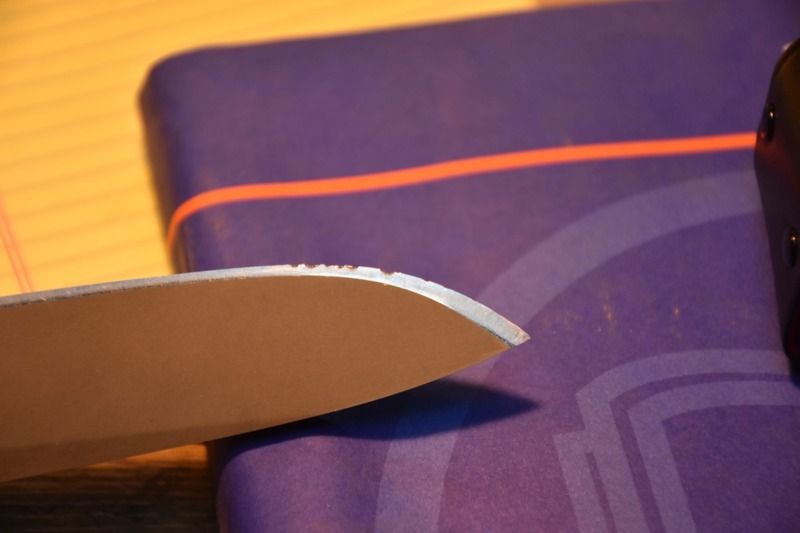

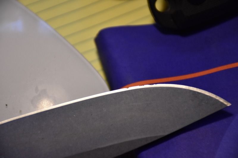

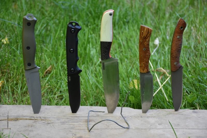

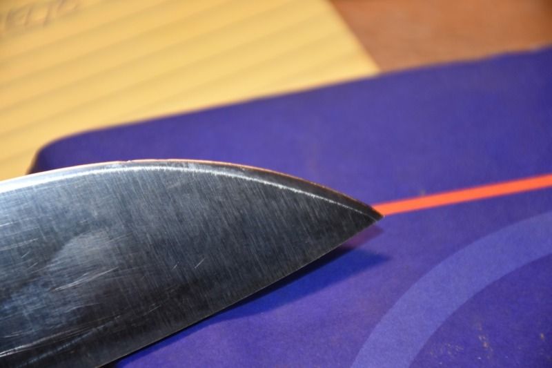

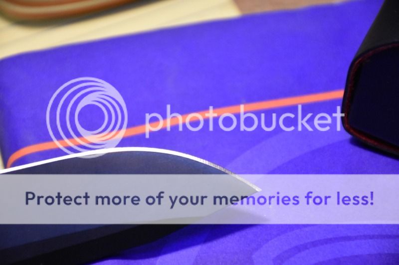

In testing some high-hardness choppers, I came across a test that really separated knife steels/heat treats with good edge stability from those with poor edge stability. It’s an abusive test, but the better steels can handle it. It involves chopping bailing wire on a big block of Douglas fir.
Here is a custom knife in Elmas at 60 Rc:
Here’s a hand-forged blade in 1095 at about 60 Rc:
Here’s a 3V blade at 60.5 Rc:
Here’s an M4 blade at 64 Rc by Gillson, which is almost untouched:
Here’s a Zero Tolerance in Vanadis 4E (unknown hardness) that is barely damaged:
Here are the players:
