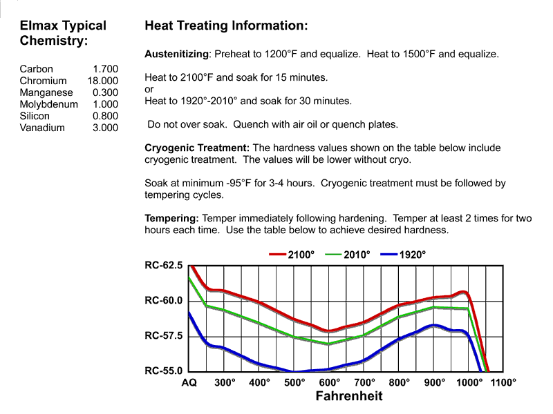

Has anyone had issues with getting Elmax to harden? I have tried several times with several methods, and I think I have just trashed 8 blades and about 20 hours of hand sanding. I give up. Here's what I've tried....
First attempt: Ramped up to 1500 and let it sit there for 15 minutes, then ramped up to 1975 and held for 30 minutes. Blades were foil wrapped. Pulled out and immediately put between a couple of 1" thick aluminum plates and blew compressed air on them until cool enough to handle. Removed foil and lowered them in acetone/dry ice bath for 4 hours. Removed from subzero bath and put them on aluminum plates until they came to room temp, then placed them back in the evenheat oven at 500 for 2 hours. Removed and put on aluminum plates until room temp again. Put back in cryo for 4 hours, removed, let them warm back to room temp, then back to temper for another 2 hours at 500. Went to run an RC55 file across them, and it dug right in. Ground away some metal on the handle, tested again, dug right in. Took my softest test file, rc40, and still scratched it. It didn't harden at all.

According to the guy from B-U that I talked to a Blade a couple of years ago, dry ice does not get cold enough for Elmax. it also may required faster quench. Have you tried slow oil?
The guy from B-U said it requires LN, so that may mean 95C. My recollection form the chart they had at Blade was that it needs a minimum of -120F. I specifically asked hi if dry ice got cold enough and he said no. I am not sure than any commonly use blade steel actually needs 3-4 hours unless you are trying to form those strange little eta (?) carbides. IIRC, Roman Landes says that the conversion of RA is almost instantaneous once you hit the proper temperature. B-U and others say that Elmax is almost a totally different steel when you get up around 61-62 and has like 75-80% of the abrasion resistance of the crazy streets like M390 or CPM90V without the cost or some of the quirks.
I was reading on Alpha Knife Supply that it needs a minimum of -95F for 3-4 hours.
I think it would be hard to do 3-4 hours with dry ice unless you added some during the process. I've only done it once in a cooler with denatured alcohol and got maybe 2 hours out of it. Maybe I was doing it wrong?

The only big difference I use is I skip the preheat step. I program my oven to the temp I want. At around 1500 I put the blades in and let them come to temp with the oven. I use this step as my preheat. My notes show a 15 minute soak at 2100 and then plate quench between 1" thick aluminum. This has given me a consistent 64+ out of quench. I then use Dry Ice and acetone for a cryo. Not sure if that is cold enough or not, but I just tested a knife I made for my wife from ELMAX and it tested at 62 Rc after 350 degree tempers. The knife was made about a year ago using the process I just described.
I am pretty sure though that if you are going to oil quench you need to get the blade out of the foil. The stainless wrap will prevent good heat transfer from blade to oil.

Big Chris, I tempered them in the heat treat oven. And the second attempt was tested right after quench, before tempering at all. As I stated, I did heat treat S35VN and had the blades tested and they cam out exactly what they should have according to the data sheets I have read. Now for the good news....... I had one of the blades tested that I was scratching with the files on a rockwell tester, and it read 57-58. Why I can scratch it with the files and the S35vn won't, I don't know. I broke 3 of the blades to check the grain, and it's about the finest grain I have ever seen. So, maybe I just need to start tweaking the heat treat till I get it where I want with this oven (brand new Evenheat KF22.5). BTW, I also just got a 10 liter Dewar delivered today, and the local welding supply carries liquid nitrogen and is 5 minutes away, so no more dry ice and acetone for me. Thanks for everyone's replies. I have a few more elmax blades to try out, hope I can get it down. This stuff is way too expensive to waste.
