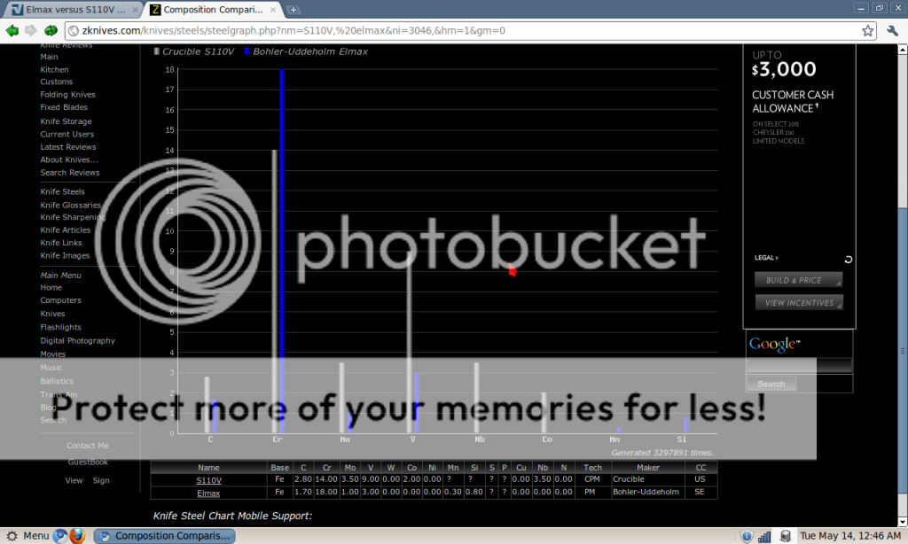

I don't have one in S110v but I can tell you the S110v will have better edge retention by quite a bit. If you're fascinated by steel composition like I am, you may enjoy this comparison graph.

I wasn't saying to make your decision based on the composition. I was just putting the info up there for those that might find it interesting or helpful. Heat treat would definitely play a huge role.
