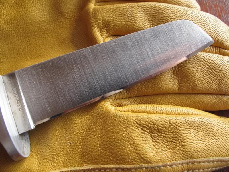

Like Marthinus said, the higher the hardness the more brittle the steel becomes. You can keep it at reasonable levels and still get great performance. I have a S90V knife that's around 60 HRC which was re-profiled to a thinner edge and it does great.
Knife is a Scott Gossman UFK.
