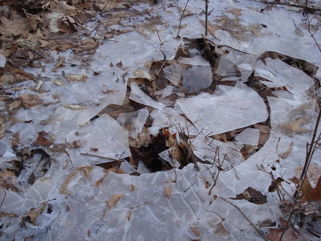

You can see that it was a bit cool. Looks like maybe a deer broke through this ice, judging by the size of the holes on the left.

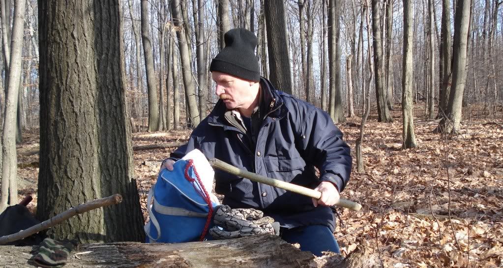

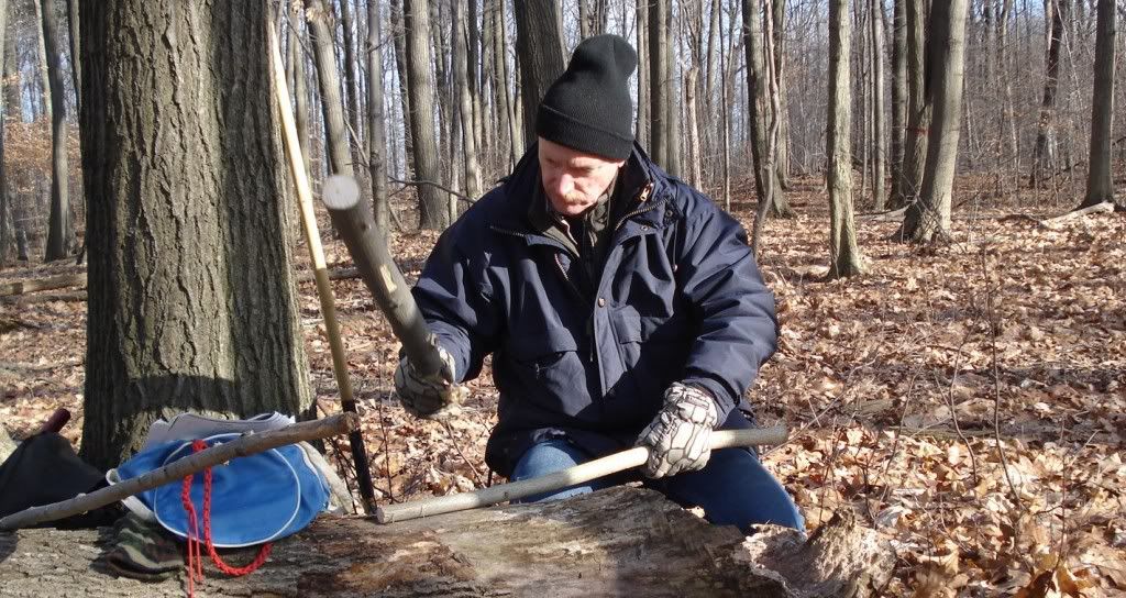

We finally managed to find a couple of saplings (2 different species) with the desired characteristics - 'somewhat straight, preferably with no branches, scars, dead spots or any such flaws that interrupt the bark fibers, should be about 3 feet long and at least thumb thickness'. One of the techniques involve beating on the bark to loosen it from the wood.
Here you can see the end of the wood splitting from being whacked. You have to strike fairly hard to get some action, but not so hard that you damage the bark.

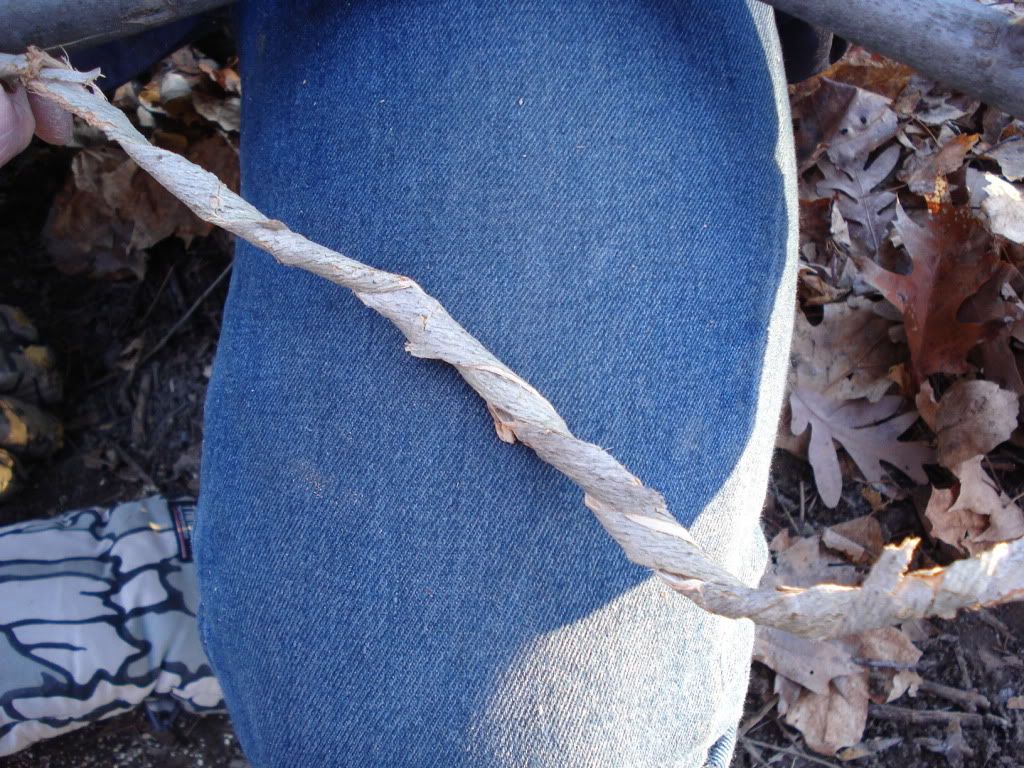

In the article, Barry talks about securing the bark strip at one end of the bow, then twisting the bark so that the bark is on the outside, with the 'wood' side enclosed within.
We tried this on the bow and it worked for several strokes but it quickly broke down. I want to say at this point, that this failure was due to the wrong type bark, our poor technique or some other short comings on our part - not in any way related to Mr. Keegan.

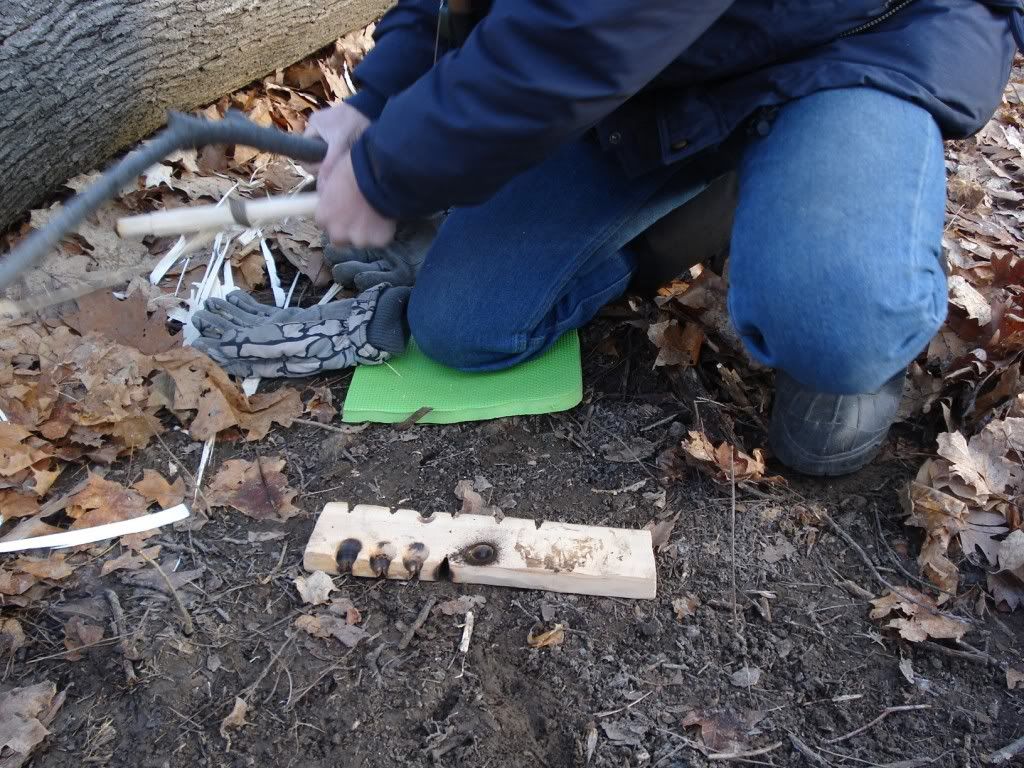

Here, Phil is burning in the divot.
The divot.

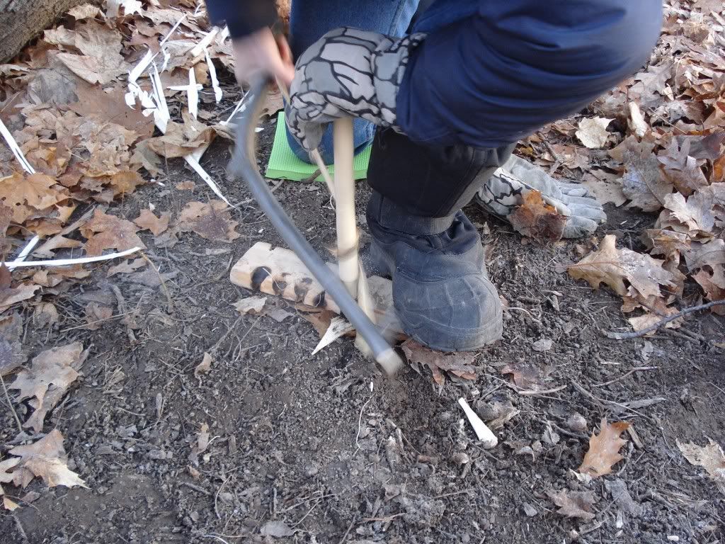

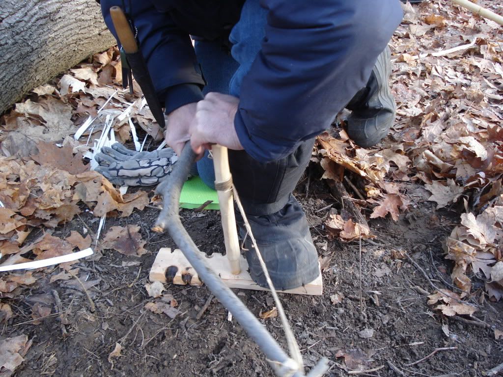

Everything arranged, going for the coal.

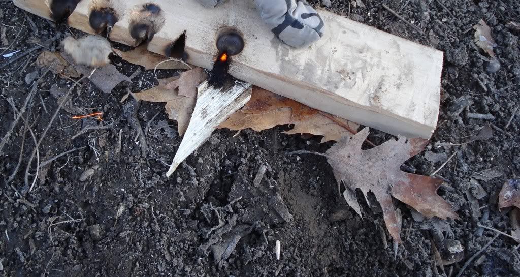

SHE'S SMOKING!
Can it be?
Sho 'nuff! :D

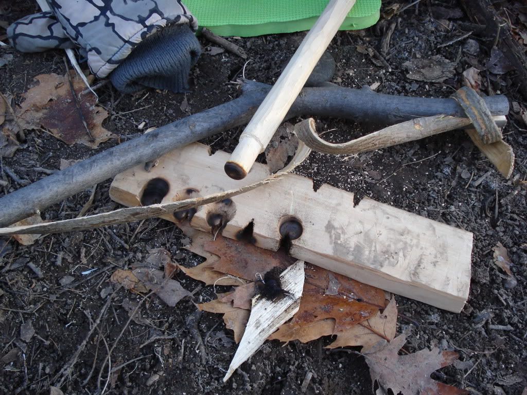

And a close-up of the tools.
As you can see the string is still in great shape, so Phil whipped off another coal, which I didn't get a picture of.

Doc, that was awesome. what was that wood type you used and got the coals with?
Bryan
Hi Bryan. The drill (mine) was Basswood (Tilia americana) and the hearth (Phil's) was also Basswood he thinks, but I'm not sure. As far as the saplings - no idea.

The first part is using the twisted bark which didn't stand up too well. In retrospect, if the drill diameter had been larger, the string might have fared better.
