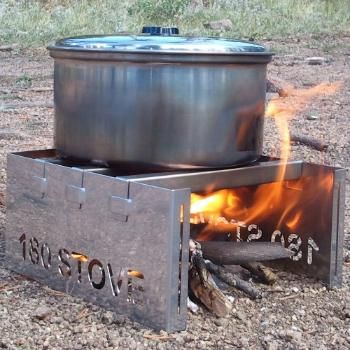

Does anyone have one (or both) of these stoves?

The only thing that has me considering the 180 stove is that you can purchase (I could probably make one) a 1 or 2 piece ash pan that keeps the fire off the ground and doubles as a griddle. I also like the large opening to feed fuel into. The only thing that stopped me from just choosing the 180 (which is easily the most important and will probably the reason I go with the emberlit) is the lack of air flow (improper air/fuel mixture) Thanks for your input guys
The Emberlit also has an internal baseplate that keeps the fire, coals and ash off the ground. Like the 108 stove though, it is a part of the structure. I guess it could be used over a fire as a griddle if one wanted to, but I use other cookware since I am not a fanatic about weight. Look at the 108 burn video on youtube. Even with repeated editing, it takes longer to establish a usable fire than with the Emberlit. Granted, he does his demo on a windy day with no windscreen (turn down the sound or wind noise will drive you batty).
