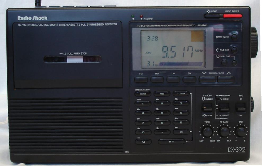

I've had a Radio Shack DX392
Since 1999 , got it for myself for Christmas because the "world" was supposed to "end" on Jan 1st - 2000.
Not exactly portable, as in stuff it in your ditty bag and run but, it works like a champ !
Make sure whatever radio you get it has SSB capability ( I cant recall why , but I remember hearing this was an important feature on a quality SW radio )
