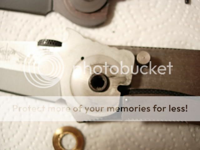

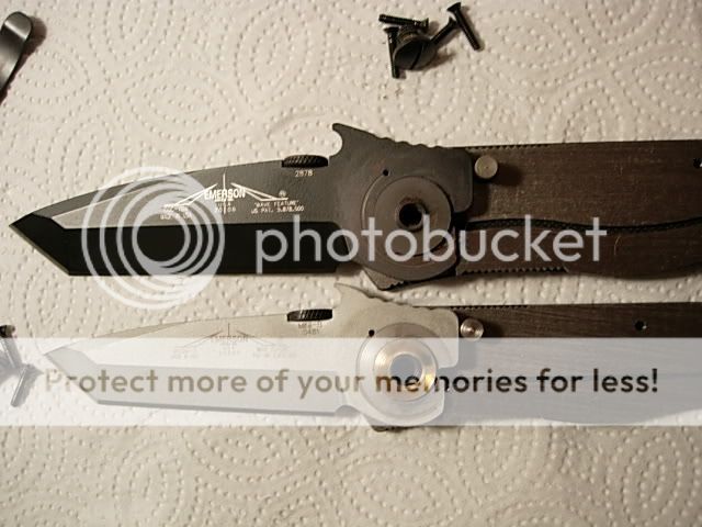

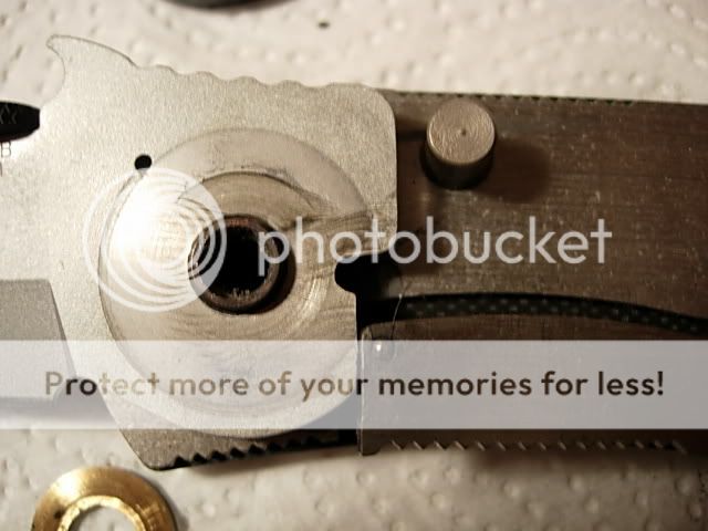

Here is photographic evidence. It looks like, I'm sorry to say, it will not work.
Mini and Standard CQC-7's with one scale revoved:
Small (mini) blade mounted on standard handle (notice the space around the lock and stop pin. Also look at the blade position.
Finally, the mini blade aligned with the lock closed position (notice the space between the stop pin and blade. This means that the small blade will not lock in the large handle.
Just my 2 cents. Others may disagree.
