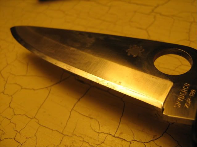

I found an Endura 4 with ZDP-189 for $78 bucks. I know this steel has been discussed b4 here, but has anyone had experience with it? One possible disadvantage I can envision is corrosion resistance. However, I live in the high desert, where humidity is extremely low. And, I take care of my knives, that's one of the joys of owning them, in my opinion.
Not having owned a super-premium steel blade, I'm looking forward to owning this knife. Can anyone provide feedback on the Spydie E4? Thanks in advance!

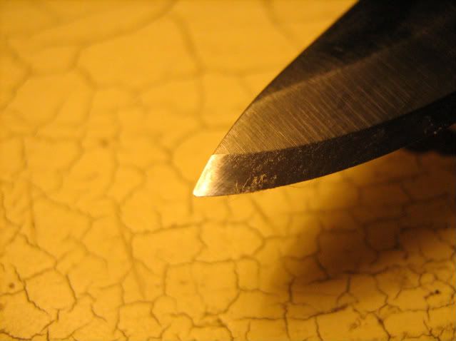

The edge has held its own to my dad's abuseful uses though micro-chipping has become the most common type of damage. I think this is due to the steels high Rc and tough use it goes through every day. I started using a microbevel and that has seemed to resolve the micro chipping for now but it will be a few weeks before I know for sure.
Overall it has proved itself to be a extremely rugged knife with top notch edge retention. Its not the easiest to sharpen and will take a few times to get use to how hard the steel is, it makes you want to use excessive pressure on the stones. It also seem to respond the best to diamond or waterstones and for finishing, diamond compounds on a strop.
To add to the abuse he has also broken the tip 3 times :eek: and even today its not in the best of shape but its still holding up much better than I ever though it would.

I've had mine for about a week so other than the usual great fit, finish, and initial sharpness from spyderco I can only add that I've been using it everyday in (freshwater) and haven't had any issues with corrosion.
The blade stains pretty easy...if that's an issue??? other than that mine has held up great, I don't really use it that much though...mine rides in my notebook case.
