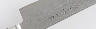

hey guys....i had a question.....i attached a pic of what i am talking about.....at what point do you engrave kanji like this on a blade?.....is it before /after heat treating.....i would assume after because if u grind over it it would wipe it out.....no?.....any help would be appreciated.....also what kind of tools would be easiest to accomplish this?.....any ideas.....thanks alot.....ryan

After, they take a tool like a small cold work chisel and a small hammer. They then continuously tap the chisel until they get the stroke they want. Most knife shops in Japan allow for personalization in this way.

Oddly, no one has answered the question yet. Whether it is a Han, Kanji, Hanja, or other language wasn't the point. I would think that the initial strokes were performed pre-ht, and maybe re-defined lightly post-ht. From my understanding there shouldn't be much grinding post-ht, just some light hand sanding/blasting.

this is what i was wondering....and i reaslize it wouldbe different on many japanese knives because alot of times there is a softer outside layer....but what about say a regular knife...no cladding out of say 1095?....ryan

Its a tool like a cold work chisel and is done after HT, like I said in the first reply. Its pretty clear that the name is likely the owner's, and not the maker's so it is almost certain that it was done post HT. These is also a fair amount of grinding post heat treat to avoid warping on thin knives, and most high end Japanese chef knives are thin. A large stone water cooled wheel is standard equipment in a knife making shop in Japan which helps them from not messing with the temper. Kana is the term that includes both hiragana and katakana, and romaji is the romanization.

Those are usually stamped before heat treat or etched.

The engraving techniques we use are a unique traditional Japanese technique. This is available only on our laminated blades, such as our kitchen knives, because they have a soft wrought-iron layer. Western knives, solid stainless knives and solid carbon steel knives are not able to have any extra engravings due to the hardness of the metal. Please enjoy our fine traditional Japanese craftsmanship! You will love showing off your hand-engraved knife at every chance you get!
Evidently post-HT, although you can't just do it to any metal. If prepped properly, I would think you could do it pre-HT. Maybe touch it up with the diamond wheel dremel post-ht.

If you harden your blade with clay then you can still engrave with a chisel
the unhardened portion.
Standard "V" or lozenge gravers could be used, either pushed by hand, or hammer driven.
