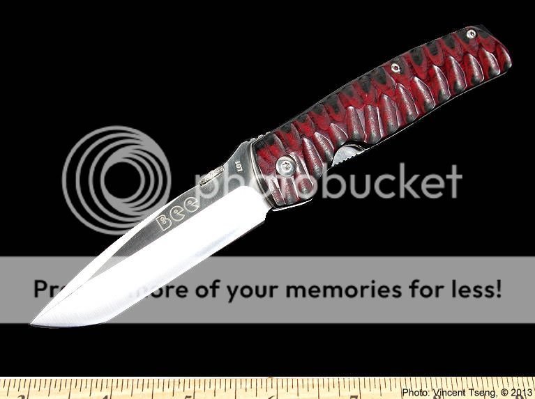

Enlan Bee L01-MCT
Feb 15, 2003
2,575
Enlan is new to me - there has been a lot of talk on BF about this budget brand from China using 8Cr13MoV.
So I did a little investigating and found they were pretty inexpensive via places like eBay.
Just after I receive this Enlan Bee L01-MCT - I saw a new Review: Enlan EL-02 -
I picked the L01-MCT mainly because of the very attractive (to me) handle - described as "Red+Black Micarta"
Even though I did enhance the photo to bring out the red details and contrast -
in real life the coloring changes with different lighting -
in some ways it can be even more attractive.
In some ways the handle reminded me of the resin black cord wrap that was popular a few years back over red ray skin underneath.
Anyway frivolous reasons aside the knife is functional -
this is the handle without any extra enhancement -
it is still pretty vivid.
It is a tanto point - but done cheaply - in that it is merely sharpened - and there isn't any special grind for the tanto point, other than a turn/different direction for the hollow grind -
having said that, it is still functional and strong - due to the thick back/spine blade false edge at the point.

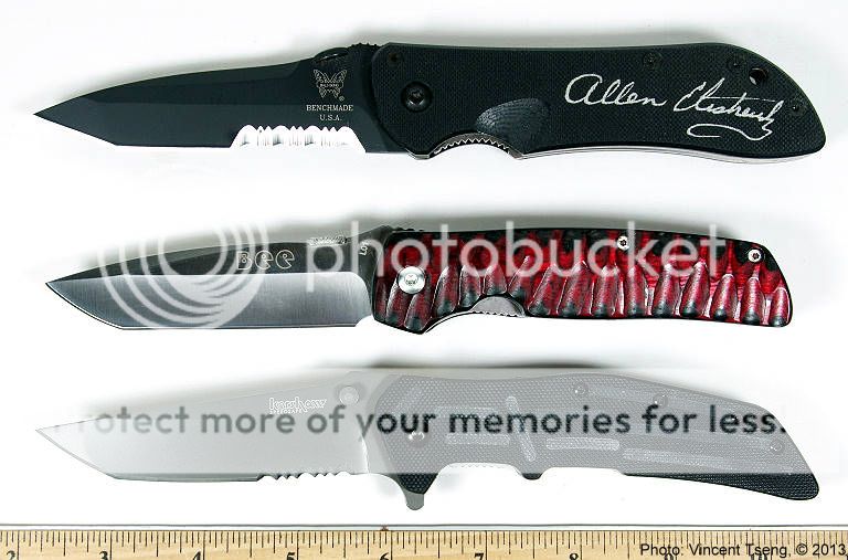

Size comparison with the Kershaw RJ Martin RJI (link to review) and an old Benchmade Elishewitz Stryker.
Size comparison with an old Kershaw Ken Onion Whirlwind and CRKT Ken Onion Ripple Aluminum (link to review)
size comparison closed with a standard 91mm sized SAK (Swiss Army Knife)

The blade steel is 8Cr13MoV - which has been compared favorably with AUS-8 -
and claimed hardness of 57HRC - other ads vary in the range of 56-60HRC (upper end looks optimistic and probably 57 is a good guess)
Blade is very sharp out of the box and the edge looks good.
cheapo usb microscope picture at about ~110x magnification of the edge.
Secondary cutting point/transition of the edge -
The grind lines and finish are all pretty good - not absolutely premium - but good -
especially for a knife that cost me all of $12.99 shipping included.
The opening is a disc and it is a liner lock - which is actually very well done, action is very smooth -
much, much better than I expected.
blade is very well centered.
liner locks up well and it is pretty substantial.
Detent is positive the blade will only come out if snapped/shaken hard.
But the blade opens easily as intended using the disc.
Lock-up is solid with no play in the blade - and everything is aligned well -
All in all I am very impressed with this knife - and handle is outstanding for my tastes -
it is very functional being grippy without being tough on the hands (like real resin cord wrap)
The steel seems from reputation to be more than just respectable. The blade is sharp and works well.
I am not too enamored with tanto points -
but can see their use.
I think it's a great knife - it may not have premium refinements and finishing touches -
but it is well finished without any rough-spots....
Best of all it was very inexpensive -
and arrived very quickly all the way from Hong Kong.
