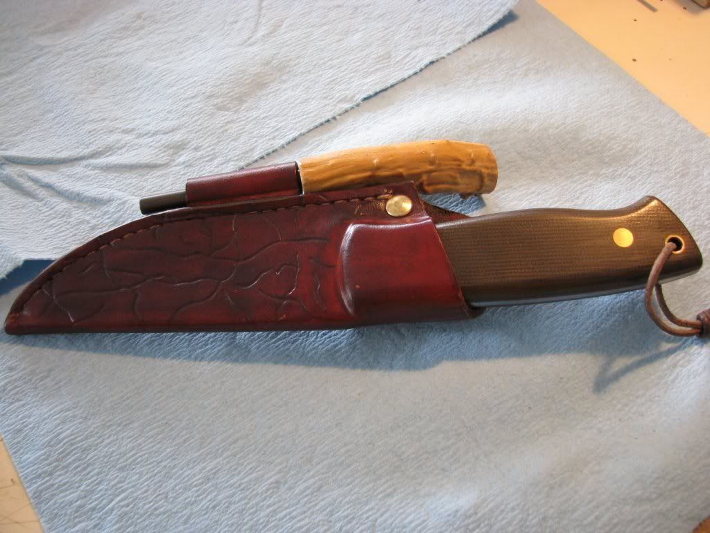

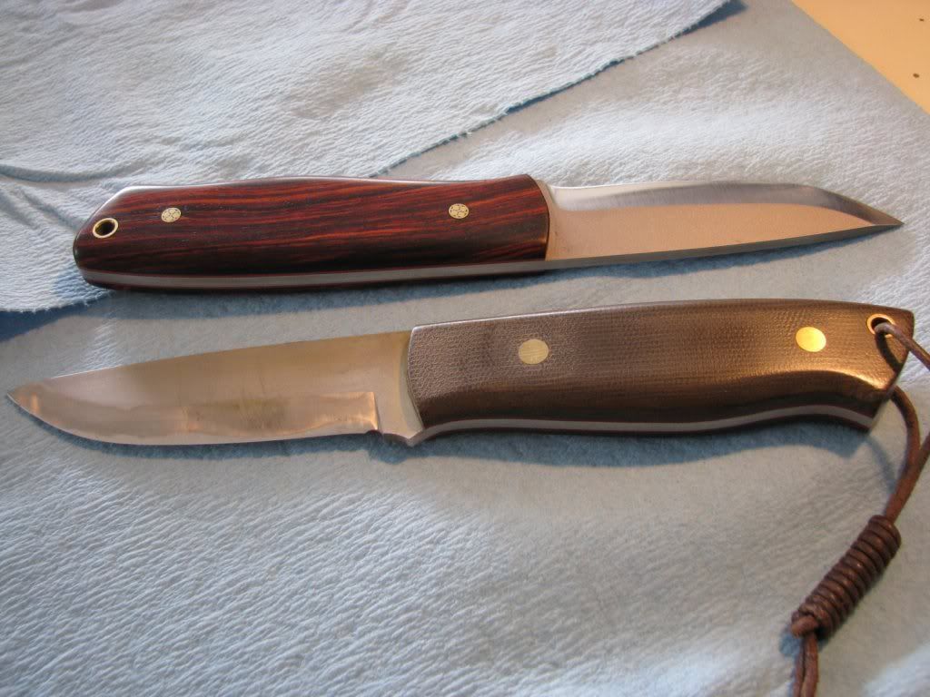

Both of these are Enzo blades. The full tang is the Trapper, and the other is the Nordic. I really like these blades. I used natural canvas micarta for the scales on the Trapper. It has been a great knife. Perfect size for bushcraft and edc. My only beef with it is that the tip is a bit thick for detail work, but I use the crap out of it (both of them, actually.) If you are handy at all, it is a real bargain to buy just the blade and then put some scales on it, yourself.

I have 01, as I find D2 a bit troubling to sharpen in the field. If you get the kit, you might think about getting some vulcanized fiber (or equivalent) to put under the scales. I have heard that Enzo's scales are a bit thin for some folks. I bought just the bare blades, and used materials I had on hand for the scales.

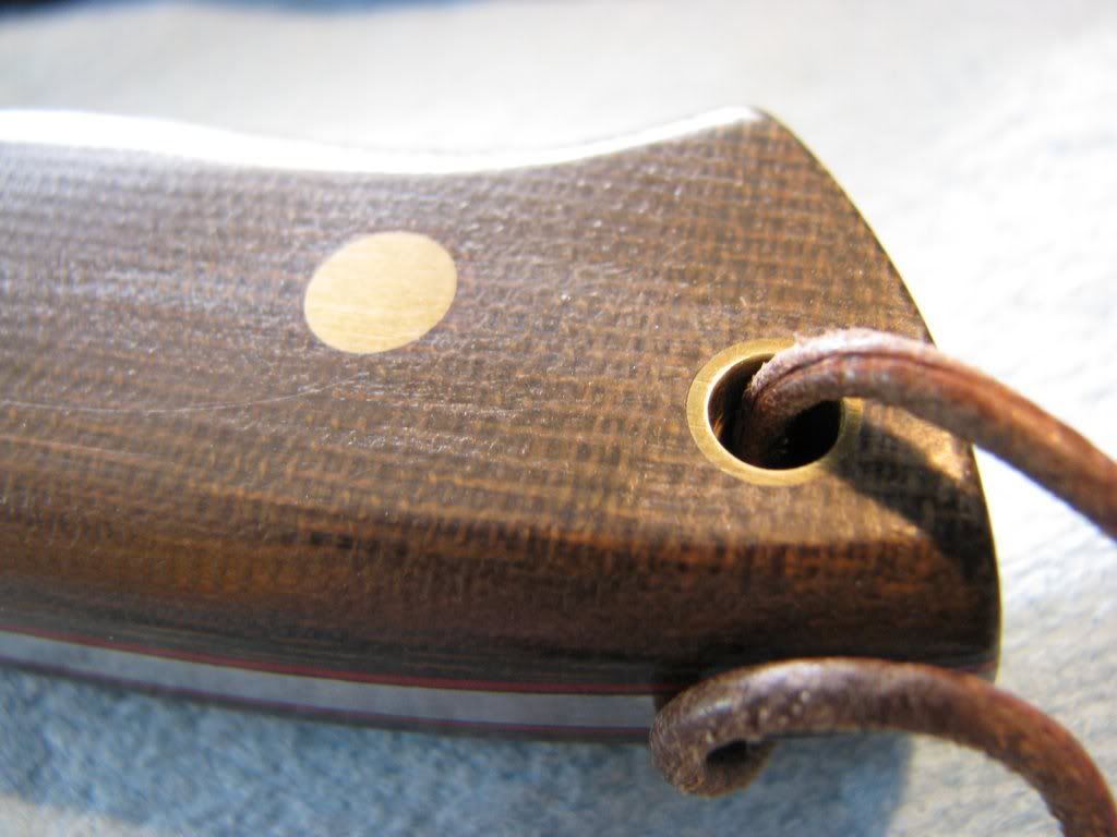

I made a few EnZo's, most of them from Ben's Backwoods. Ny first two were a kits. I gave one away and kept a green Micarta. Since then, I order only the blades, and scale them myself. What I like to do is extend the scales out further toward the ricasso, and I add a lanyard tube, which is very difficult to do (properly) in a kit knife if the scales are already pre-formed. I managed to do it on the green micarta, but it took a special home-made jig and lots of time so there was no slop around the tube.
Here's the green micarta knife. It's an EDC.

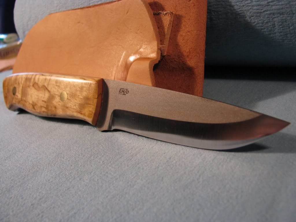

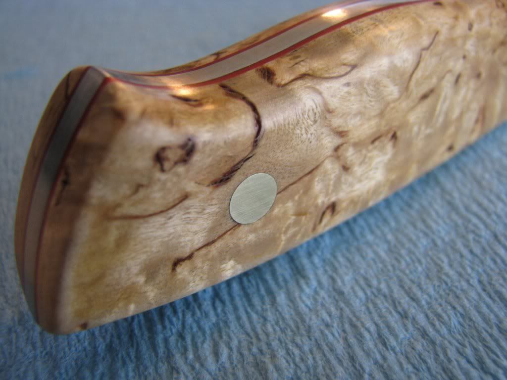

This is a curly birch kit. My very first EnZo.

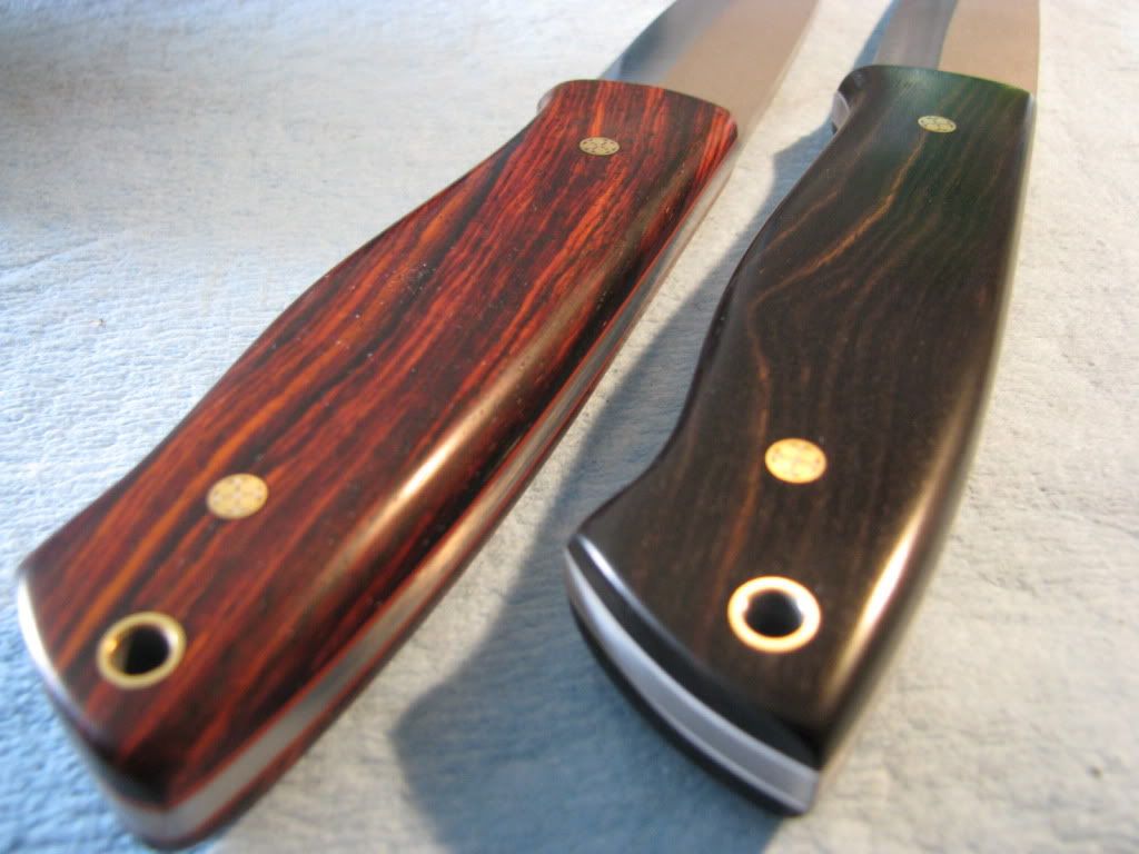

Here are a couple of EnZo Elver knives. They are very nice little blades, even though they are D2 steel. Standard v-grind is all that was available until recently, when they introduced a D2 Elver with a scandi ground-to-zero blade. Thompson's has them.
