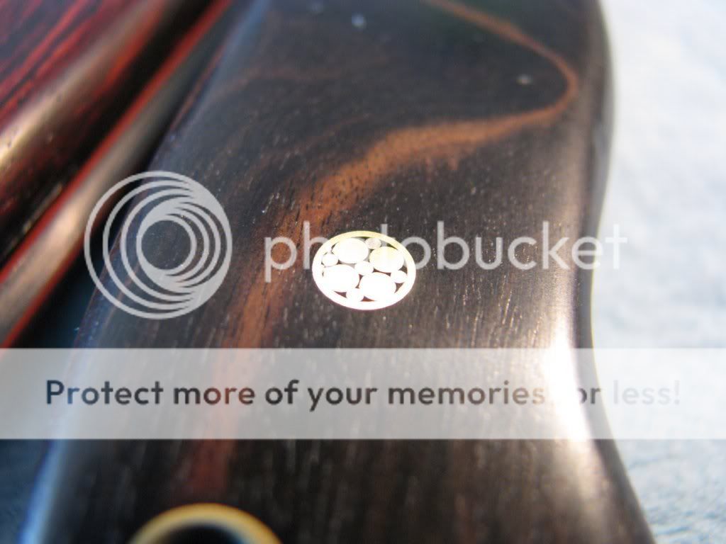

After those two, I started making my own scales, adding length toward the ricasso. Here's an ebony and cocobolo pair, with mosaic pins:

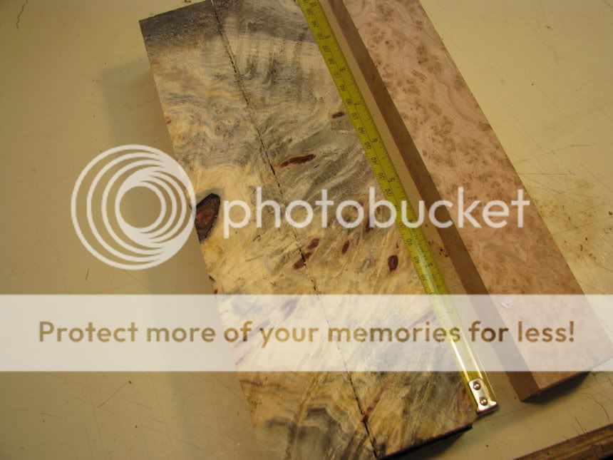

These scales are for an upcoming Trapper, Scz0. The wood is buckeye burl from an online source. I stabilized the wood with a specific MinWax hardener product.

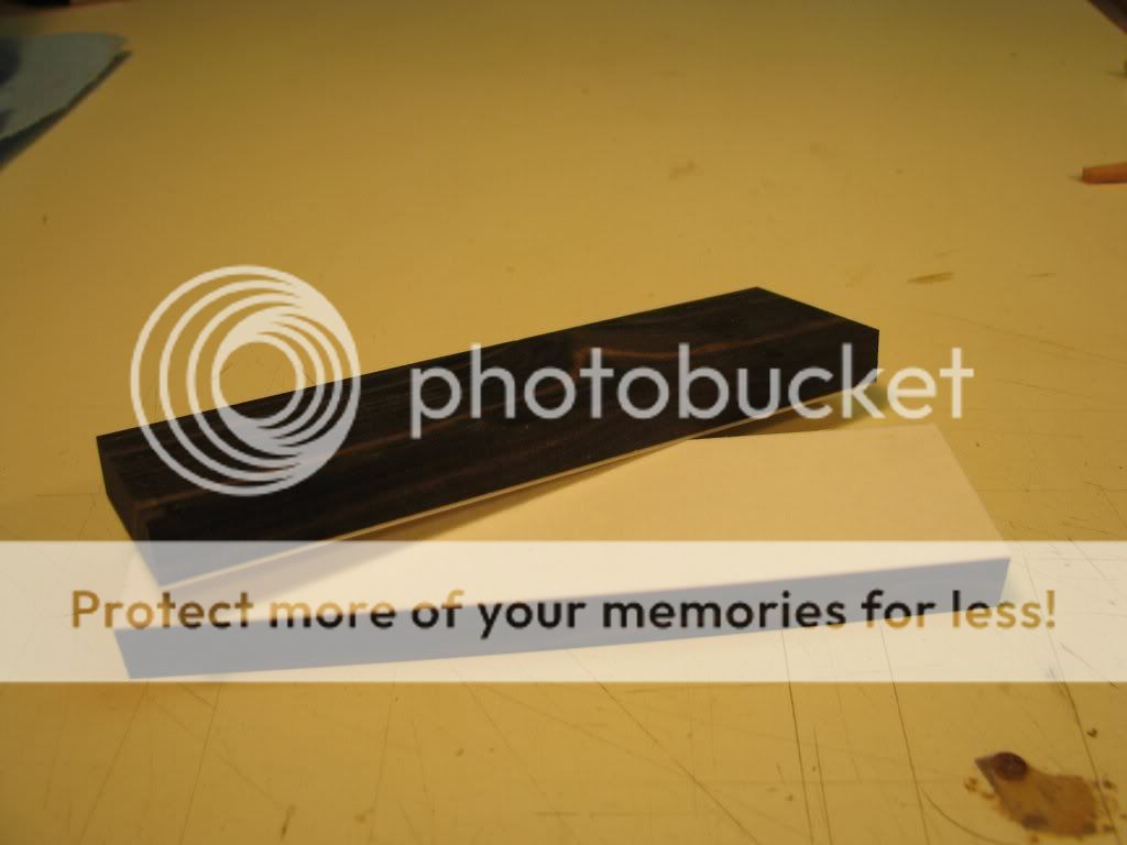

The scales are smooth and coplanar, and the liners are glued on:

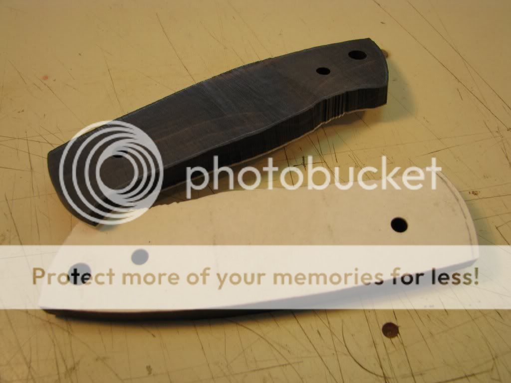

Holes are drilled and the scales have a basic shape:

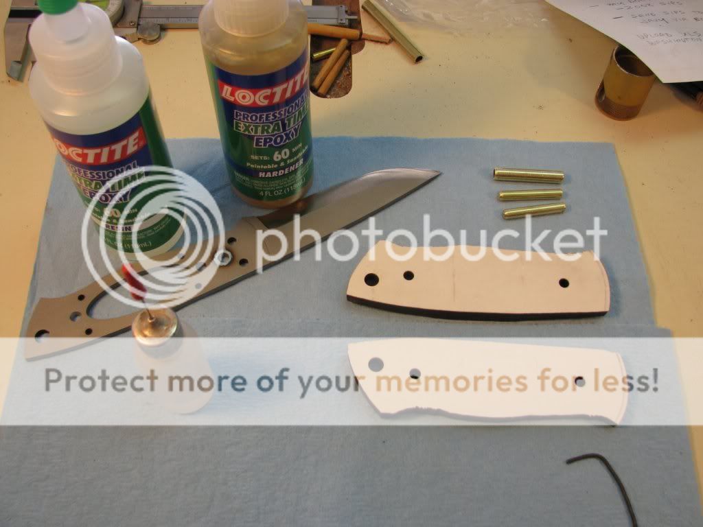

Ready for glue-up:

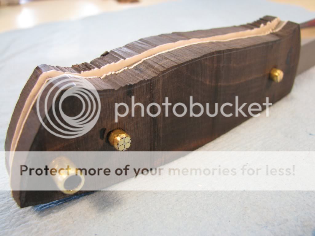

Pins and tube are in, scales are glued to the blade, and clamps are about to go on:

Making sure there are no gaps around the pins and tube:

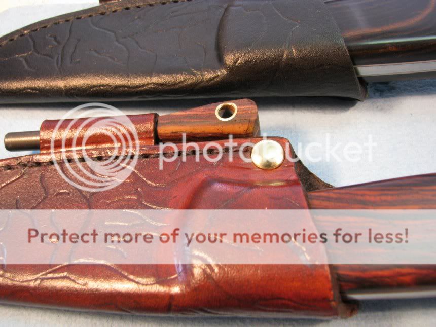

The ebony is in the black sheath at the top of the photo:

I got some wood from BurlSource I think it was. They have a website where they show each individual piece you'll be buying. I called the guy anyway and told him the lengths, widths, and thicknesses of the pieces I'd need. Not only did he send what I needed, he threw in quite a bit of free stuff too - some ash scales and some madrone burl. It was a very good experience dealing with the guy. The buckeye stuff is my favorite though. VERY figured, but not so loud as to be unruly on these scandi blades. The ebony, cocobolo, and rosewood stuff I've had for years - that didn;t come from BurlSource.

Could someone explain how the lanyard tube is inserted into the blank scales? I don’t get why it would be harder to insert on into a scale that was in a kit than into a blank scale. Maybe I don’t understand the proper way to drill and assemble the handles when you are making your own scales.
Well, when you drill scales for pins or a tube, the scales are drilled together. This ensures that the drilled hole is straight all the way through. If it's off, even a little (we're talking thousandths of an inch), you won;t be able to get the pin or tube through.
Remember too that you have a full tang on these particular blades. There is a lanyard hole already drilled in the tang of the blade. So now, when you drill, the scales AND the blade have to be together.
Now here's the biggest part of the problem: if the scales are already pre-shaped, how will you get them perfectly level on the press table, or at a perfect right angle to the drill bit? You pretty much can;t. A jig is in order here.
It's difficult to explain in words how to do this, but the jig will be a coplanar piece of wood about 3/4" thick, 1-1/4" wide, and longer than the knife scales. The blade blank is pinned to the jig (I use doube-sided carpet tape) and the holes are drilled on the drill press. Now, with the drill bit still in the lanyard hole, clamp the jig to the table without moving it. Raise the quill, set one of the scales on it (liner side down), insert the pins in the pin holes to align the scale with the blade, then drill the lanyard hole. Do the same for the other scale by flipping the jig and resetting the drill press. With patience, attention to detail, and some luck, the holes will all align.
Now, when you're making your own scales, things are much easier. I use the bandsaw to resaw a block of wood, making it about 5/16" x 1-1/4" x 10" long. These 10" long pieces can then be run through the planer to bring them down to about 1/4" and ensure they are coplanar. Now, you can cut them to length, glue on liners, pin the blade (carpet tape), drill the holes, and then shape the scales and glue them up. One word of caution: always check that your pins and lanyard tube will fit into the holes on the blade. In every single EnZo blade I've made, the holes had to be enlarged a little. I use a flexible shaft drill and a chainsaw sharpening stone to do this. Drilling the holes is out of the question unless you have the proper bits, skill, and knowledge. Even O1 steel is hard stuff! Take a look at the picture above where everything is setup and ready to be glued. You can see on the blade blank where I drilled out one of the pin holes. I used a special hardened bit, and it still burned the blade blank. The biggest danger is having your clamp let loose and having a razor sharp blade spiining around on the press table!

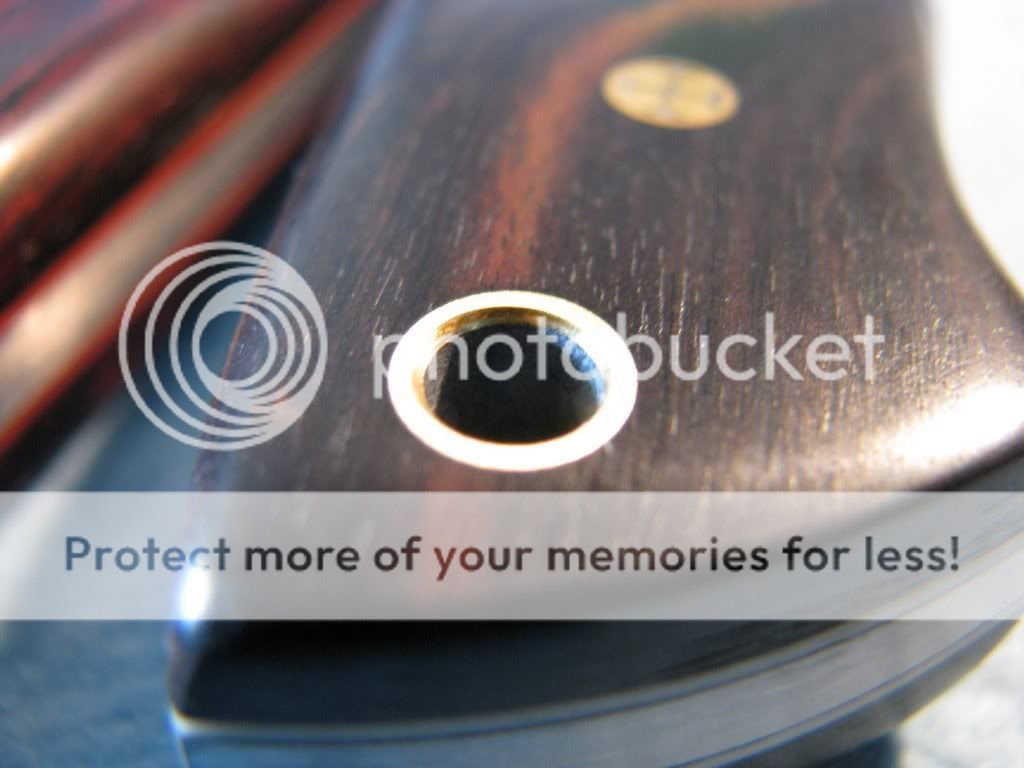

when you put in the brass tube for your lanyard hole, what size tube did you use? does the tube go through the hole on the tang, or is it in 2 pieces(1 on each side of the tang)?
it looks like you 'counter sunk' the ends of the tube. great work! did you just drill the ends slightly to achieve this?
