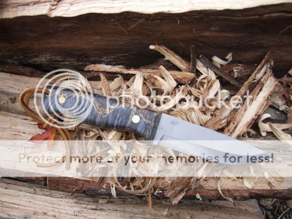

I'm a big fan of kit blades.
Here are some of my completed pieces.
Jantz Appalachian Bowie, full tang.
Buck 119 (rescue)
(Large) Stromeng stick tang with leather
(Small) Brusletto stick tang with leather
Fun and rewarding kit blades (& rescues) are. :D
