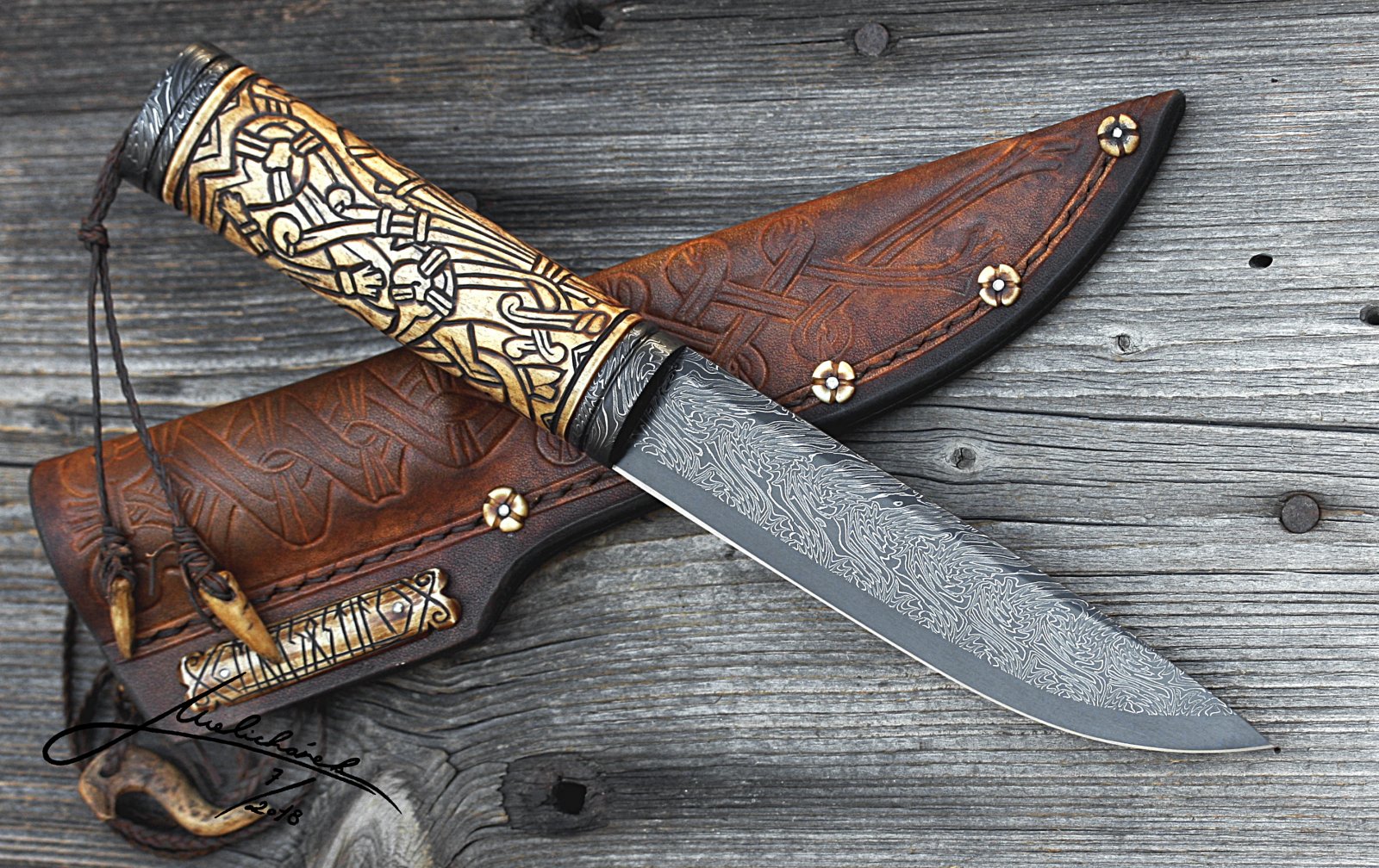

Hi everyone :)

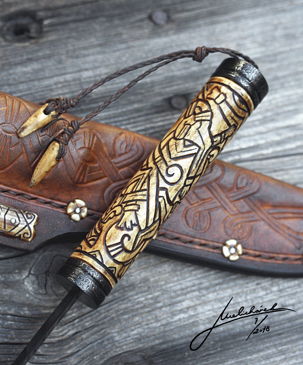

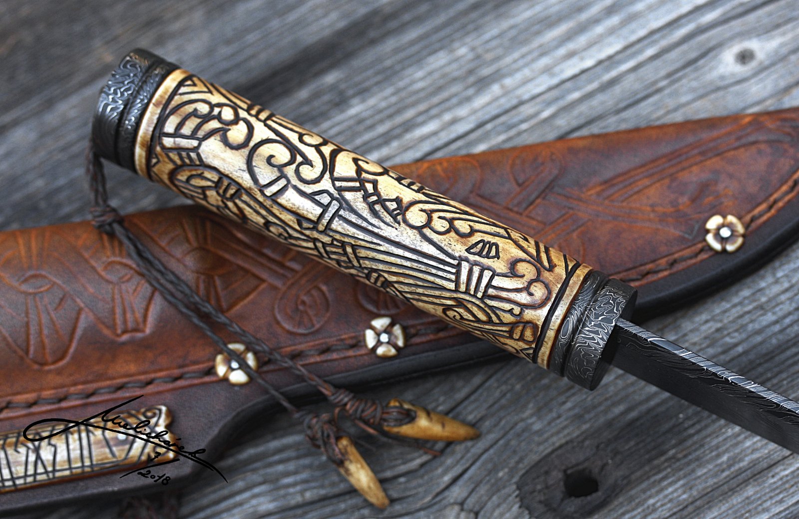

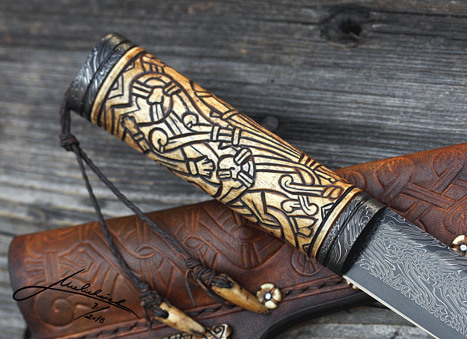

I just finished this knife , inspired by viking era. There is a hunting theme on the handle . It shows the fight between the alpha wolf Naytander and king of the deers Erhyos the Golden , for the crown of the forest .
The theme is just my imagination
Thanks for watching and see you with another knife :) Petr
ERHYOS GOLDENDEER

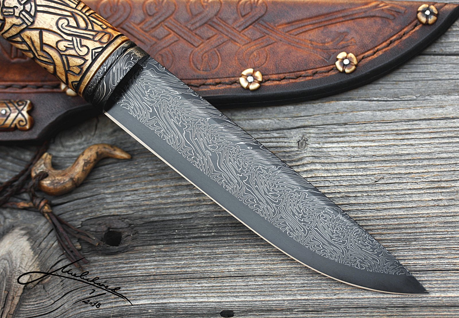

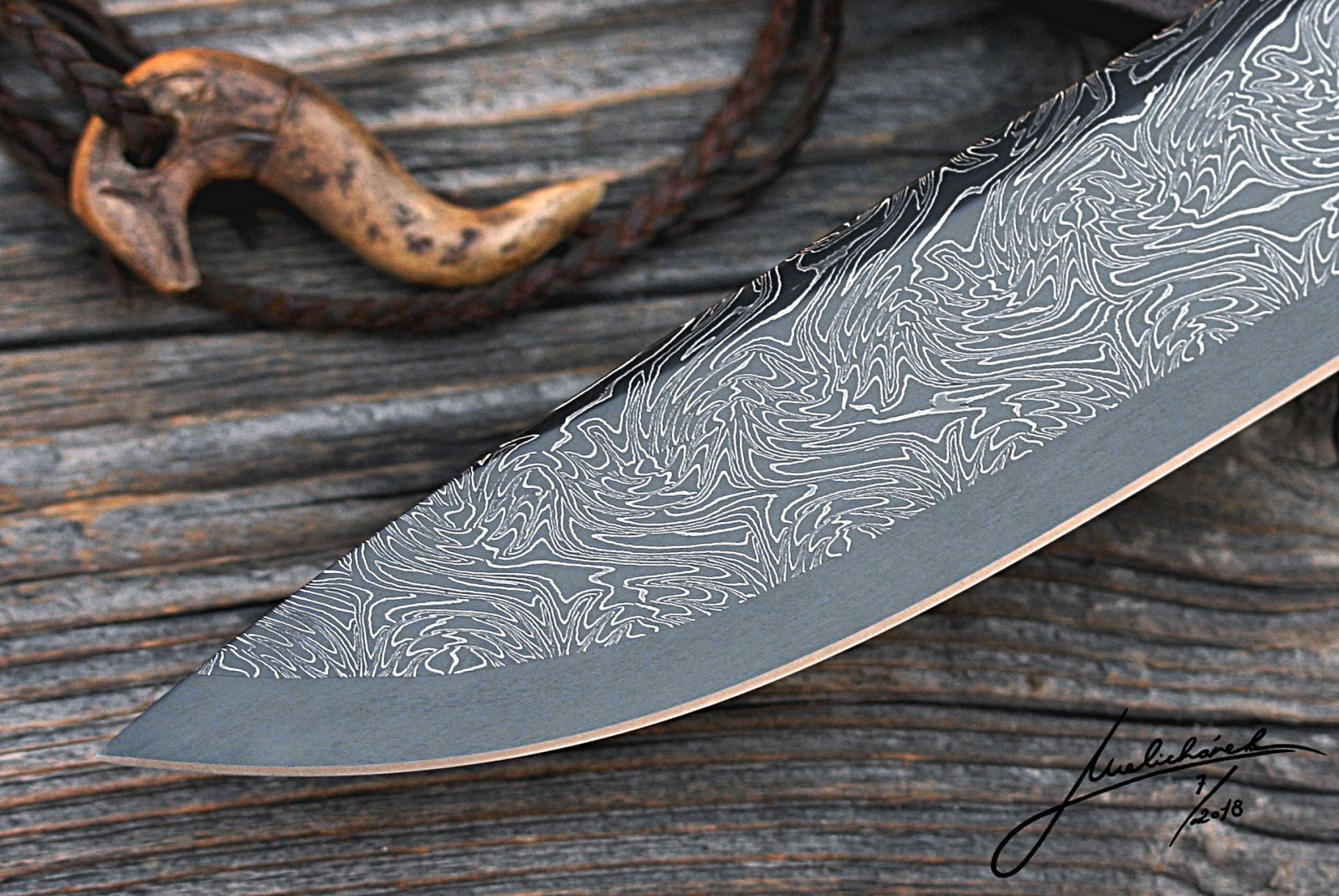

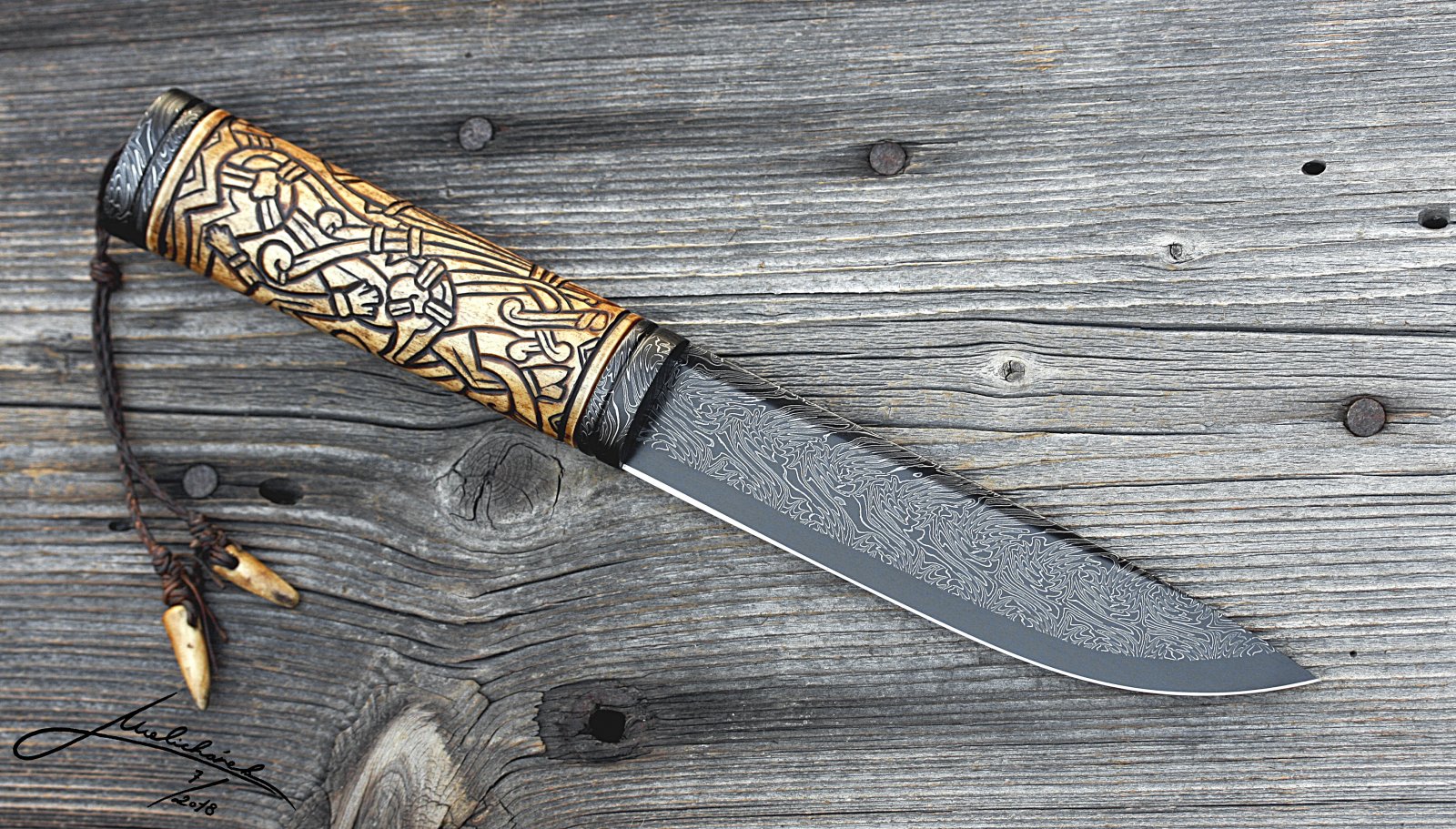

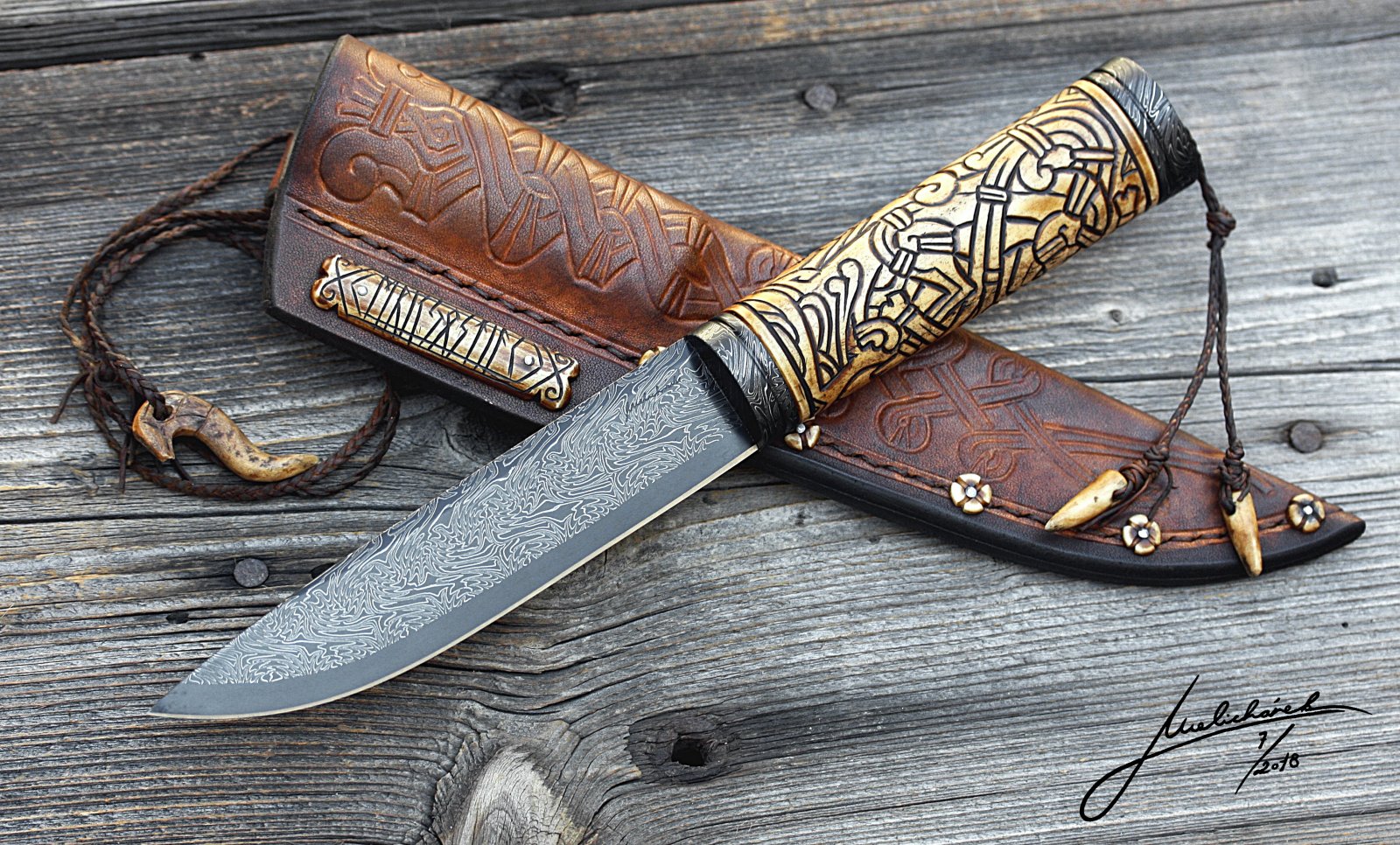

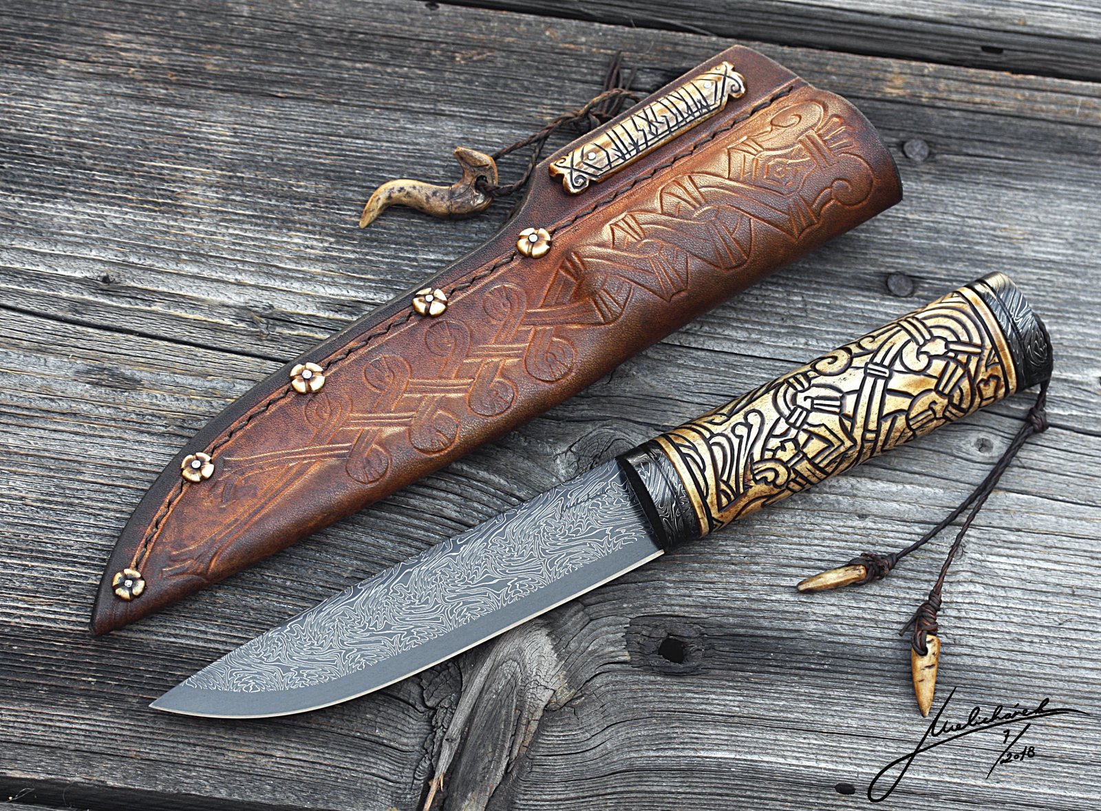

Blade - Multibar twisted damascus- 1,2842 (O2) + 75ni8 Uddeholm (15n20) - edge 1,2842 (O2)

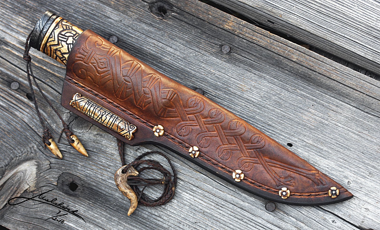

Guard and pommel - 1,2842 (O2) steel + 75ni8 Uddeholm (15n20)
Handle - patinated , carved bone
Average length - 29 cm (approx- 11,42 inches) , blade -15 ,5 cm (approx- 6,1 inches).
Blade width at widest point 32 mm (approx 1,26inches ) mm , blade thickness 5 mm (0, 197 inch)

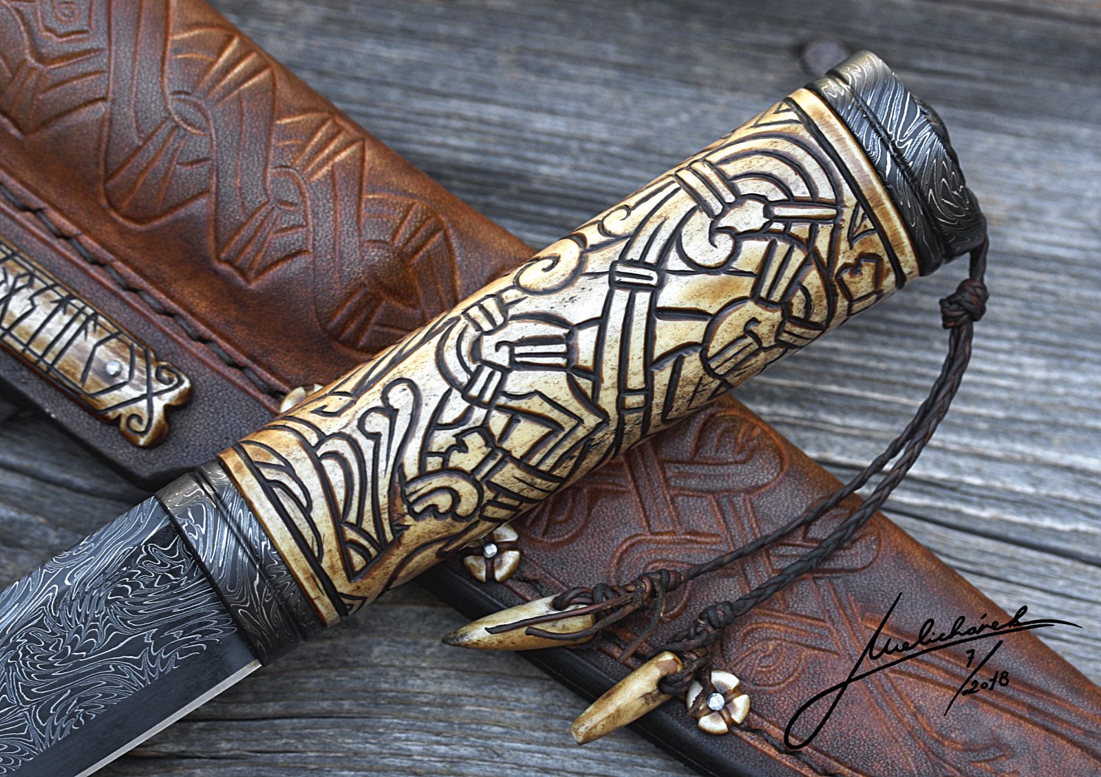

How did you plan the carving for the handle? Did you draw it out first on paper and then transfer it to the handle or do you draw it on the handle and then carve? If you transfer the design can we see what it looks like flat and in 2-dimensions? Thanks

Hi there . I draw to the paper just scatch of both animals . Mainly torso and i left the antlers/tails without details . Just to get basic idea what a want to do. Than i draw the torsos to both sides of the handle an filled the empty space with antlers, foot and tails and so . So basicly i draw it directly on the bone with some preparation :)
WIN HEGER : Thanks :D It is not inspired by him but i took a look on his art and yea .. there is the impesion :D Anyway .. it was inspired by Ringerike style of carving . This knife is for hunter so i wanted to make something different than some clasical snake/dragon viking knotwork :)
