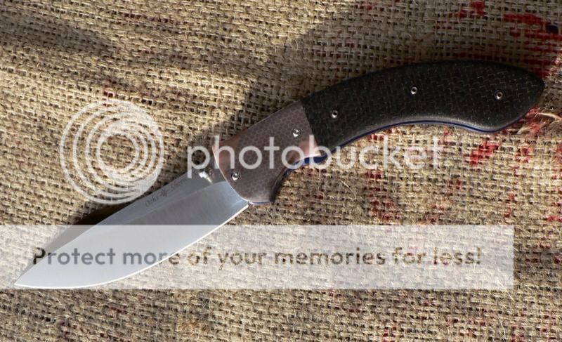

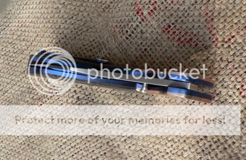

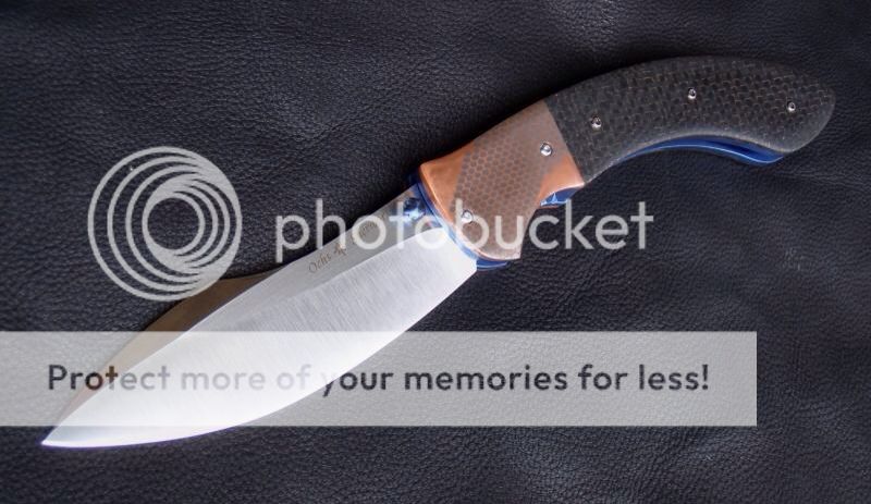

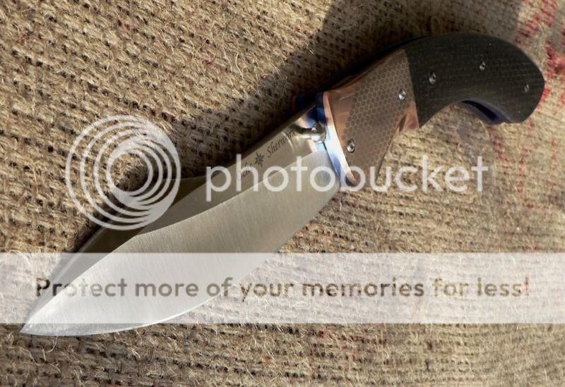

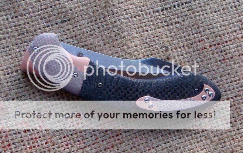

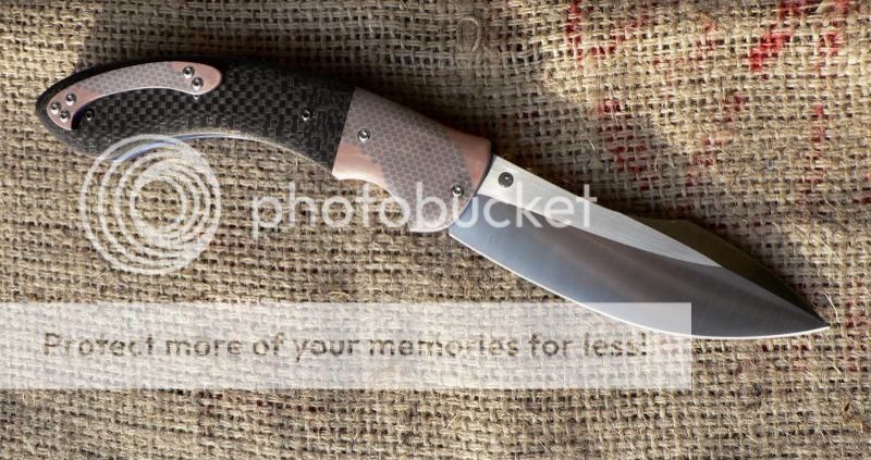

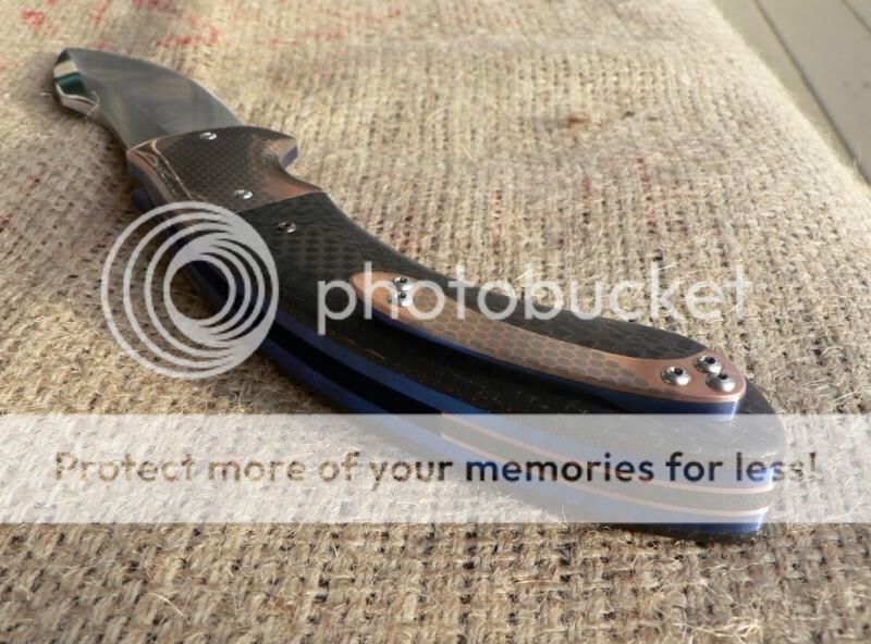

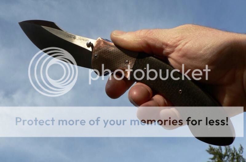

Orca
Diablo
, here has an Elmax blade 4-7/8" flat ground primary and
hollow ground swedge. This .125" linerlock has thrust bearings, Superconductor
bolsters and LSCF scales...and a few extras.
Outstanding!
Eric job well done. Thank you and Much Mahalo. :D:D
see post #8 for picture. Thanks Alphahunter. Chee hoo you the man.
(Photos below)
Great work and materials. Big FAT liners!

Could someone give some background/info on the Superconductor bolsters? They look really cool.
The Superconductor material is salvage material which was bought when the Supercolider project in Texas was stopped and dismantaled. It is made up of Copper and Niobium in a fused solid piece. These have been have then been cut as a cross section. Different patterns come from different size and shape sections which have been cut in a multitude fo different angles. It can be obtained at the Blade Show.
