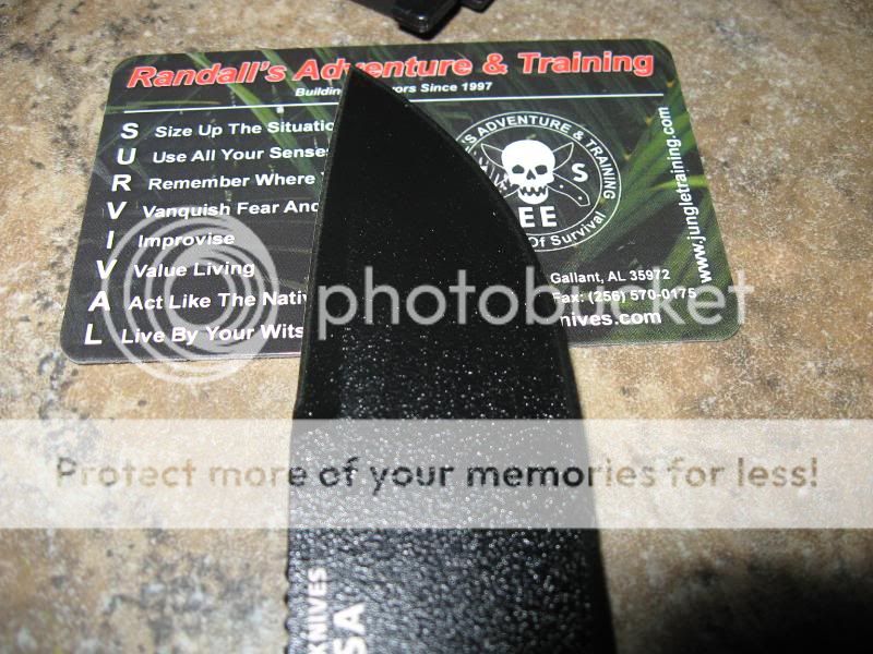

Just in and had to piddle with it in the front yard... I finally picked up a ESEE 3 Clip Point . My initial thought was : Clip Point ESEE knives maybe geared more towards LEO/Military than the average outdoorsman.
ESEE 3MIL CP Specs:
1095 Steel ,56-58RC , Green Canvas Micarta , sharpened pommel, Blade 1/8” thick , Full Flat Grind , OAL 8.3” ,cutting edge 3.38” ,O.A Blade length 3.88” , Knife only Weight 5.2ounces . The Clip Point with a Sharpened Swedge Grind
The CP ESEE3 is aesthetically identical to the ESEE3 except for the partial sharpened forward portion of the Spine.
We all know the Capabilities of the ESEE 3 and then you add the CP portion which for some folks is either a Plus or a minus and some folks could care less yet still provide a opinion on the CP version. I would advise you to check your local laws on double edged weapons . Texas it is Illegal unless you’re on your own land.
Me personally I like the CP on the ESEE3 ,I know a lot of folk Baton with ESEE knives and to a degree you lose that ability but for me you gain a permanent fire steel Striker that to me is a big plus ,no fumbling around with Strikers or where to store my striker on the sheath ? Which my Main Focus on the Sharpened portion of the Spine is a for my ESEE Fire Kit Striker, No removing powder coating for spine striking or making a modification to the 1095 steel for a fire steel striking surface the CP versions is a permanent & ready to go ferro rod striker factory option now without the dulling effect on the main knife edge as a striker. The sharpened spine can be used to shave slivers off of Fatwood & or magnesium fire starter , in my area I used it to shave bark from a Cotton wood tree without damage to the tree or dulling my main knife edge .
Penetration is greatly enhanced with the sharpened spine if that helps you in a self defense mode but I lean more towards outdoor usage and Bumming around the woods. The point Greatly benefits from the Double edge as doing drilling in wood and other bush craft task that require a excellent blade tip like some of the more traditional Bush craft blades out there on the market today. Batoning can still be achieved on smaller diameter sticks/ but not as efficient as a Standard ESEE 3/4/6 being these models come in the Clip Point variety.
Overall I am impressed with this offering from ESEE knives..The Clip Point don’t get a lot of notoriety and If it is legal in your area you ought to try one out . There is a Wow factor that is hard to explain, when you first receive it…but again you either love ‘em or hate ‘em no middle ground on these bad boys !
I am going to go hit a trail soon and piddle with the ESEE 3MILCP more but I just had to play with it in the front yard for a Quickie :D

if you look in the pic my 1st 3mil is stripped and the spine of it throws sparks but not as good as the CP version

that is the whole point :) I was trying to make... If the Clip point version of the 3/4/6 is Legal in your area ,why not try one,you have a great Ferro rod striker available. yes you lose a certain degree of Batoning but in a survival situation your going to use dead fall limbs,twigs etc. anyways your not going to waste energy & calories batoning your only blade thru a log to start a fire (IMO) :D

I really like the idea of having a secondary sharpened edge that doesn't interfere with using the thumb push-cuts. I see it being a great fire steel striker as well as a secondary edge if something damages the primary or it just gets dull through use in a long term situation with no access to a stone.
Honestly I don't get all the comments on the sharpened upper edge interfering with batoning. It actually has very little impact on the amount of energy used considering the physics involved and the nature of wood. The primary edge will penetrate with the grain while splitting much easier than the upper edge will penetrate the baton cross grain. Does anybody out there really have a favorite baton they carry to the field with them? For me it is simply another piece of fire wood in the end anyway on the odd times when I really have to baton anyway. I do it with every knife I get when I first get it just to make sure it will handle it if the need arises, and I do it to teach students how to...if the need arises, but it has only been really necessary in the field maybe a dozen times in the course of my time in the woods.
