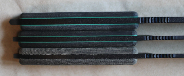

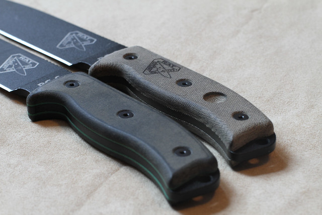

That is too cool man. Always thought about it since before i even bought the 6, now I have a junglas and next in line is an izula II. It would be cool to have all the handles match. :thumbup: Are the 5 & 6 the same handle thickness?? Are the canvas 5 handles any more rounded, i think that would be cool. One more question, are the 5 & junglas handles the same color canvas or a little different? Thanks for your response -Tyler
the scales on the 5 are a little thicker not much than the ones from the 6 enough so that you need to use the spacers from the 6 to fit the 6 scales back on the 5. the canvas is the same color on the 5 the 3 mil and the izula as the junglas.
