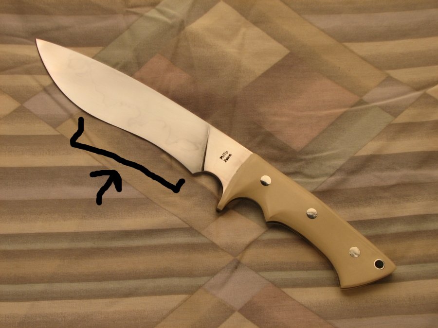

I am not the most knowledgeable knife guy so I guess I don't know exactly what I recurve is. I figured that if a blade is not straight and has a large curve such as the kershaw above, then it is a recurve. From the photos online, it looks like the Izula does have a curve but maybe not as much as the kershaw above.

Ah, gotcha, but no, that's not what it means. A recurve is a curve near the handle, where it goes from down to up then down. A picture probably illustrates it best:
That's a Phillip Patton knife (http://www.bladeforums.com/forums/showthread.php/516959-Recurve-camp-knife ) that I've edited to show what part makes it a recurve.
Anyway, the Izula does indeed curve up towards the tip quite a bit, probably a little bit more than the Kershaw you posted. If you have trouble with that one, the Izula won't be any better I don't think.
