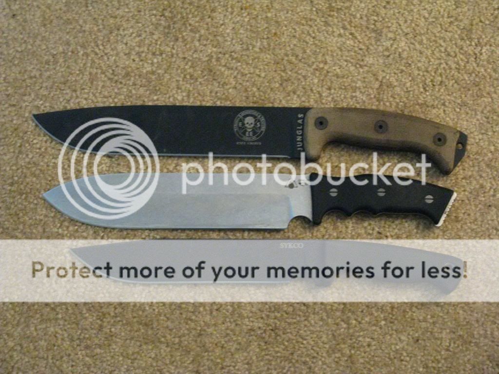

I have both, and really like both, both have good chopping power, yet are nimble in hand being 3/16th rather than 1/4". The GSO-10 holds an edge noticeably longer of course due to the steel, especially in harder wood, I actually have gotten a bit of edge deformation in the Junglas from some hard knots, though due to the softer, lower carbide steel they were very easy to sharpen out too. The finger choil on the 10, does keep one's hand more secure in one or two grips, but also limits grip placement as well. I was lucky enough to get the 10 on the first run at a very deep discount, about the same price as the Junglas actually, the 10 is the chopper I usually take with me into the woods, but I don't plan on getting rid of the Junglas. At the current price of $350 I'd probably just get a custom made to my specs and hand size.
Both with a Scrap yard SYKCO 911
