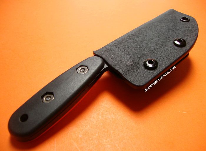

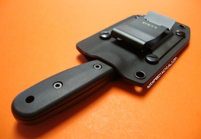

Other than that, there are some good makers on here that will do whatever you want for a sheath. Azwelke, Godspeed, and the710 all do great kydex work. Skystorm, Sagewood Gear, and Hedgehog Leatherworks all make great leather for them.

Will a "Kydex" sheath fix the problem? Not necessarily.. because a poor design is just that, and while Kydex doesnt' have the glass if you get a crappy Kydex sheath you've got the same basic problem and there's a lot of them out there.
