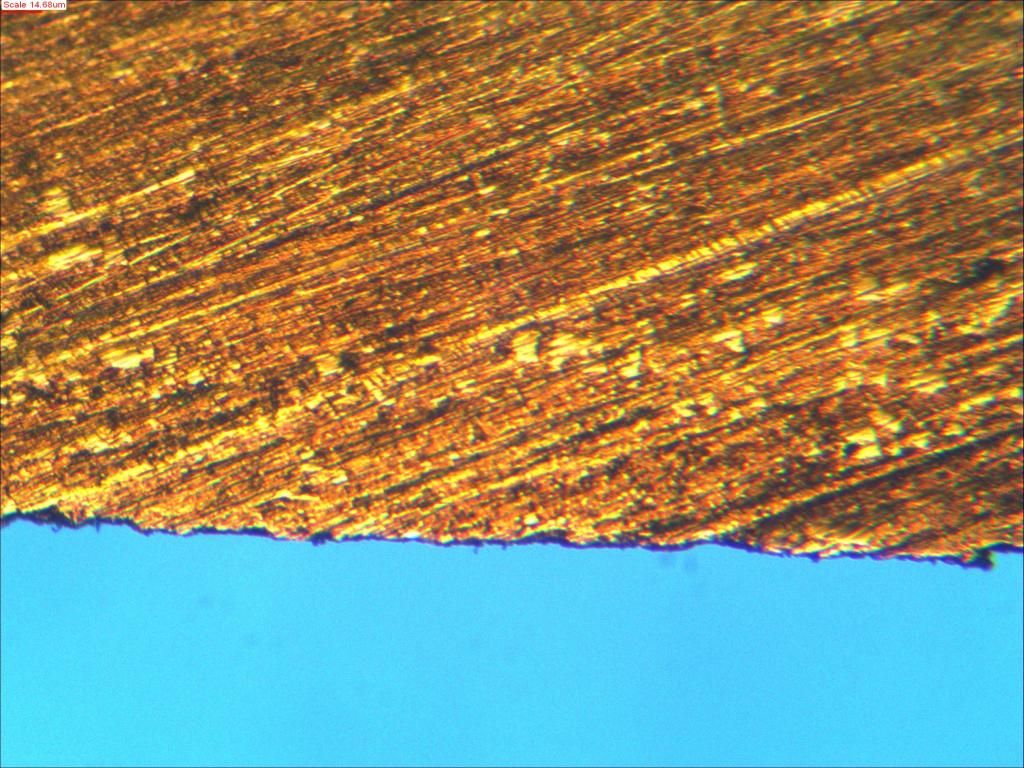

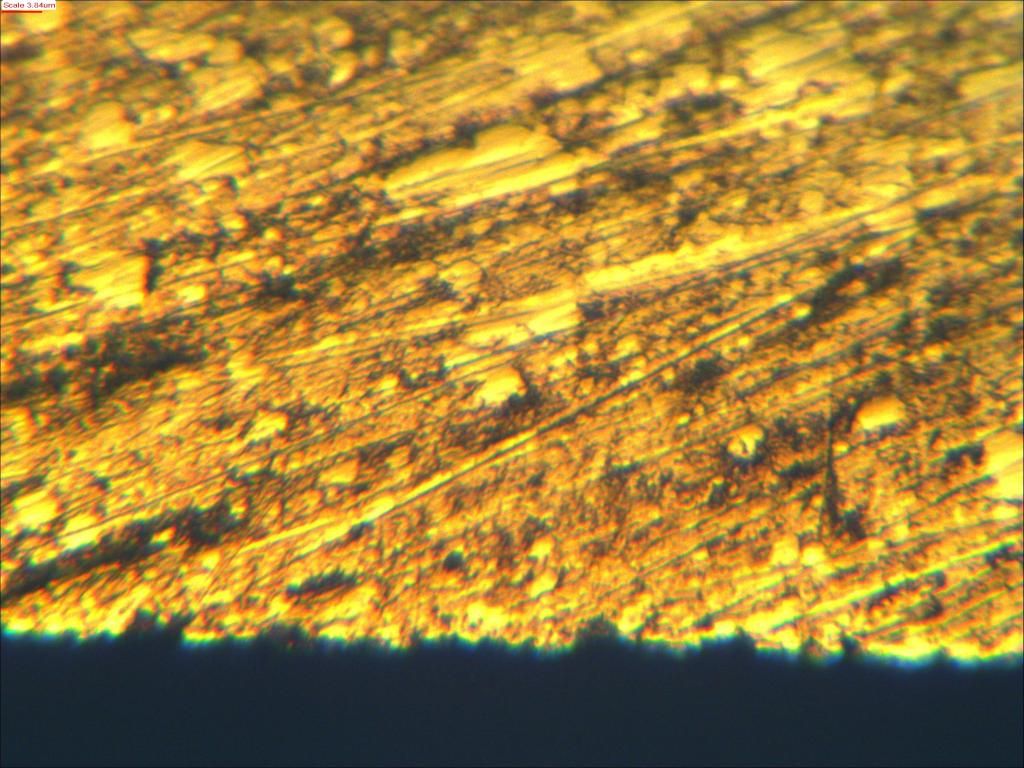

Hello, just tried to etch some D2 with vinegar to see if the carbides could be readily ID'd from surrounding steel. Vinegar soak for 6 hours wound up being way too long, next time will stop at 1 hr intervals. Edge is completely eroded, so carbide presentation along cutting edge is lost this time around. Carbides held onto scratch patterns - sharpened on SIC. Carbide size runs from low 20u down to single digit microns, most in the 5-12 range.
Will have to time the soak so most of the edge stays intact. All pics at 100x, started out sidelit and backlit. I dialed up the surface illumination slowly.
Pretty cool, have often wondered if this could be determined at relatively coarse finish values (real metallurgical sampling is generally done at polish levels in the submicron range, this was finished with my compound, approx 3-4u finish.

Am pretty sure they will have a big positive effect at any grit value, what remains to be seen is how they look with a much shorter soak. I have no reason to believe they won't be incorporated into the edge at fairly close intervals, and with grind patterns included. So while I prefer a relatively coarse finish on this steel, I have also run it up to a pretty high polish on diamond stone and it performed very well. Did seem to lead to a shorter life, but is all anecdotal, I did no actual testing.

So long as the carbides are abraded with finer abrasives capable of honing them (think: diamond/AlOx/SiC at sub-5µ grit sizes), their size won't matter much in how fine the edge can be. If anyone's ever shaved smoothly and comfortably with a polished D2 edge, they've already proven this point to themselves; maybe without realizing it. A smooth-shaving edge is usually regarded as having an apex less than ~1µ wide and appropriately thin geometry behind it. This means that any of those 10-20µ carbides (and even larger in other variants of D2) would had to have been 'honed' down to comfortable shaving thinness, to make that happen.
D2 does great at a polished finish (depending on use, as always), though it takes longer to get it there. The main impact of hard carbides that big is, they're just much, much slower to hone down to size with enough finesse to avoid knocking them out of the edge. That's what I've consistently noticed about the character of (non-PM) D2, over any other of it's attributes; it just takes longer to refine. I'm sure this is why most will 'prefer' a coarser edge on D2, as it's just plain easier to get it done; something like a Fine DMT would leave a great working edge on it, and do it quickly.

My speculation is that the larger sized carbides very well might break out of the edge in use. When you think about it, some amount is almost inevitable. The larger size means less surface area in contact with surrounding steel to begin with (the smaller the object, the larger its surface area becomes relative to its dimensions and vise versa). It would be theoretically much easier to bust out than smaller carbides in the same steel. Is interesting that in the images I took, and in inspecting the entire edge, I saw very few carbides at the actual cutting edge, maybe four or five along the entire length, yet there should have been some there based on the overall density of the carbides in the steel.
Speculation is that the etch removed enough steel for them all to fall out, and this implies there is a minimum amount of steel support need per carbide, beneath which the carbides fall out. The knife wasn't used after being sharpened. While it is certainly possible to refine this sample of D2 to a high degree, my experience is that edge life suffers no matter wat abrasives are used, so my experience would lead me to conclude your edge prep is a pretty good choice. I usually stop at approx a 600-800 grit edge, in practice I've gotten better longevity from stopping closer to 300 grit but the edge struggles with pressure cutting at that finish so I go a little finer.

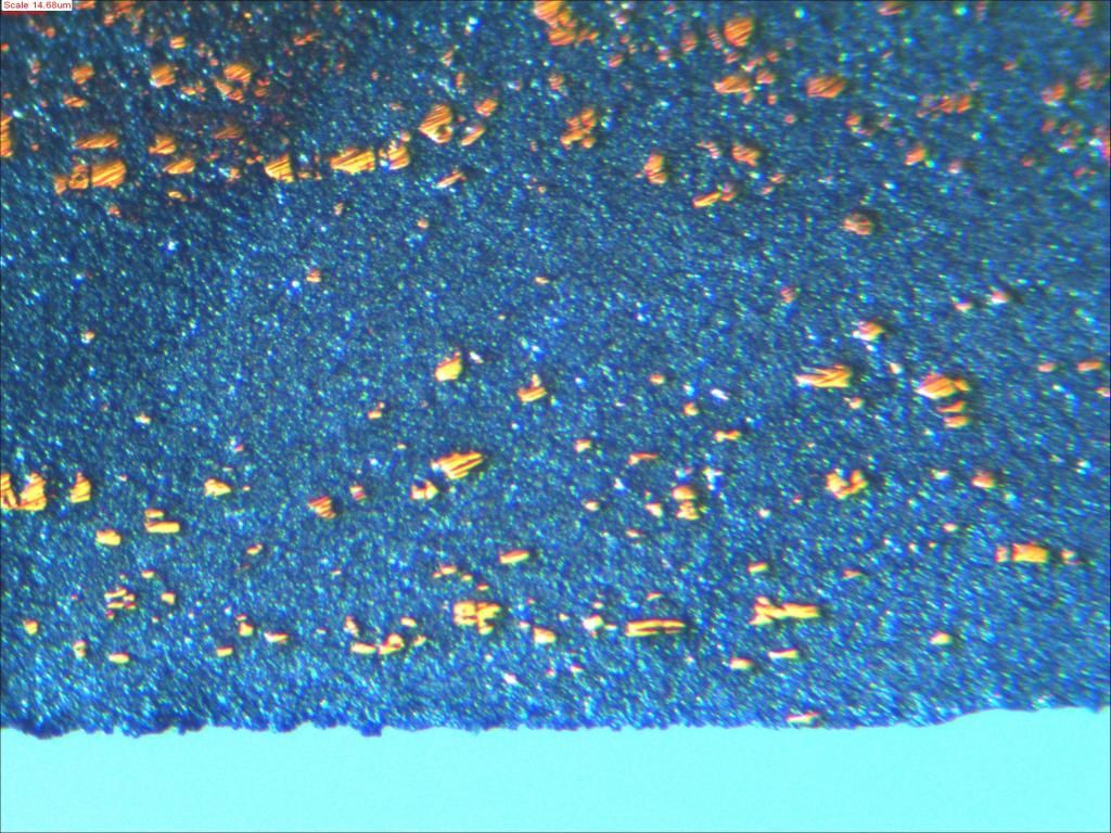

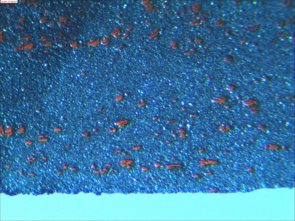

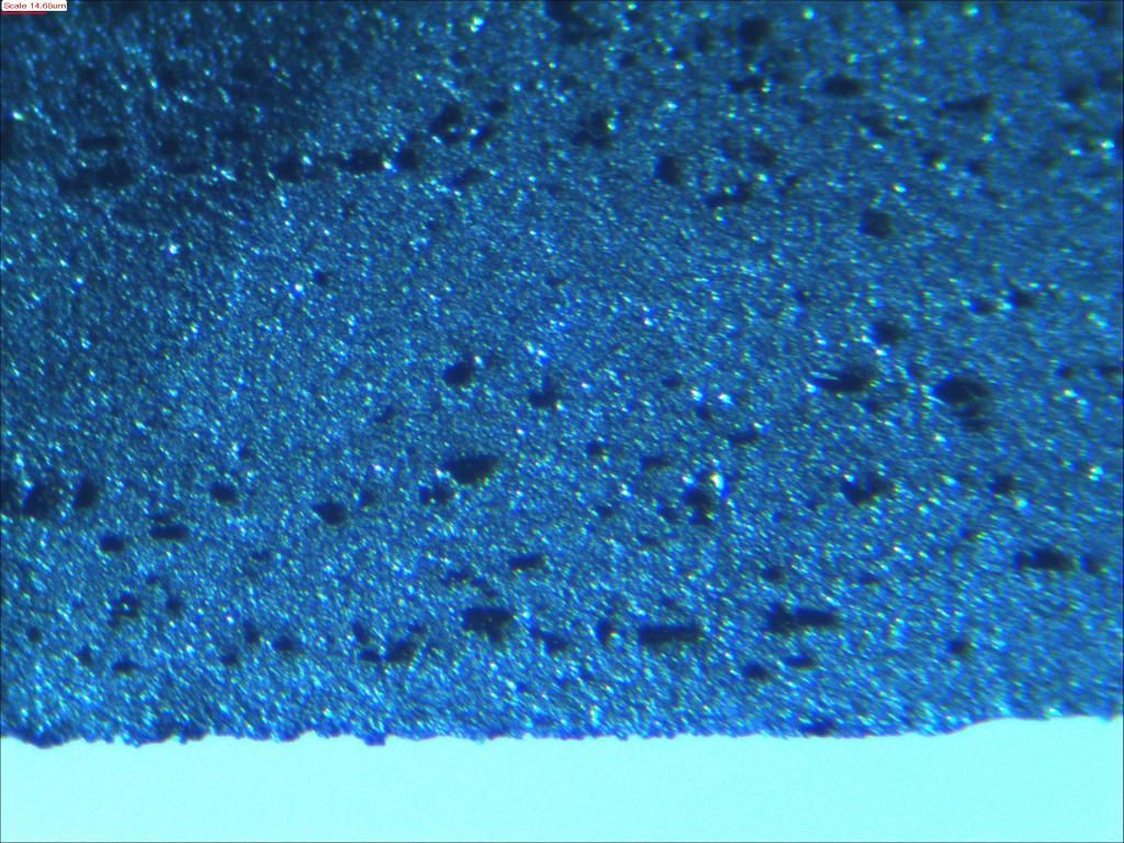

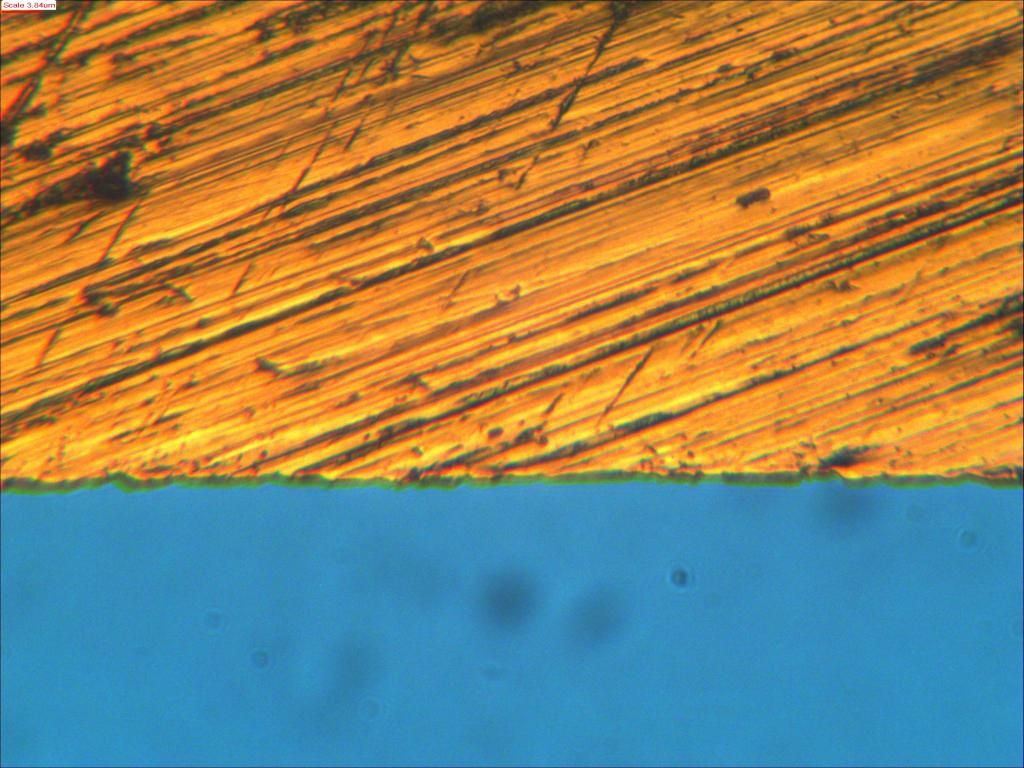

OK, took a few new pics. As suspected, the etch quickly ruins the original morphology to some extent, and makes it very tough to ID the carbides in their natural state. Am wondering if instead of an etch, some sort of extremely thin stain can be used to ID the carbides based on fine porosity (really reaching here)?
Anyway, here are the pics at 100 and 400x. It is apparent that there is a much greater concentration of carbides than is visible in the earlier series with heavy etching. This go round was a half hour soak, maybe could have gone another 15 minutes without too many of the finer carbides falling out, and maybe a bit more contrast. Mean carbide size still looks to be in the range of 30u and 1u. They pack in tight right to the edge
I also thought I could make out some banding or striations to the carbide formations, but am unable to get the camera to image it. For reference (and to put in a plug for the WB) I included a pic of the edge reconditioned afterward using only WB with compound on paper. I likely did not start out looking like that prior to the soak, was a good deal rougher - the 10u jointer stone makes a good edge, but not as refined as that. Clean up your edge!
I have some work to do if I want to really be able to tell what the carbides are doing, especially after some use - considering how many there are in the steel, there is scant evidence of them following the paper strop. A few pits where I suspect a larger carbide could no longer hold on.

100x
400x
400x, post Washboard
Edit to add: this explains in clear detail why I don't recommend really trying to paper burnish high carbide steel, even the non-Vanadium stuff...
400x pic - lumps/bumps we are seeing, I don't think they are carbide. Carbide density can't be that high, since D2 has only 2% carbide volume. Google a few D2 carbide images, clearly carbide distribution is more sparse.
