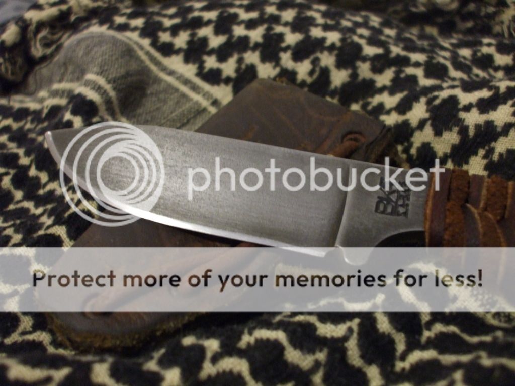

Etched my 14 this weekend and I decided to take a hike with some friends today. Just a short day trip up a nearby peak. snapped a few pics; enjoy.
Thanks guys
The 14 looks great. What process did you use to get that look ?
I did a gun blue bleach etch; matted it on with a cotton ball did one 20 min' dip in the bleach cleaned it up and reblued then another 30 min' dip and cleaned it up with the buffing wheel on my dremel.
