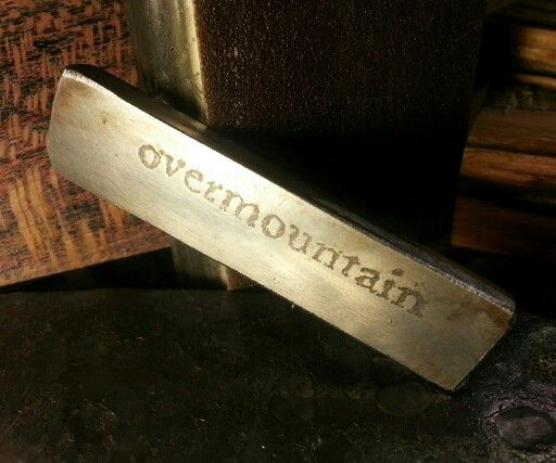

Here is a kinda purposefully rough etch from pinroll on mild steel. For the shop logo, etc...
I don't have pics of the etcher. Away from the casa at the moment... If you search for the build on here I copied it right down to the project box from radio shack. I will get some pics when back home...
I ordered some photoreactive stencil stuff to try out. The pinroll is OK but can blow out easy...

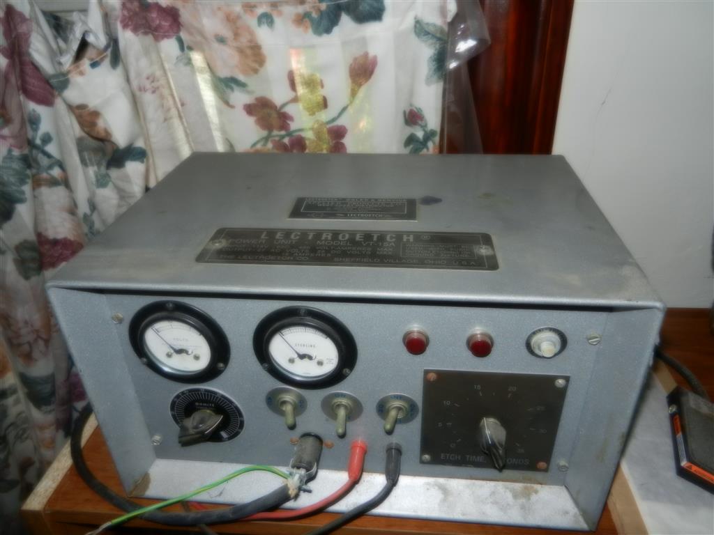

My LectroEtch VT15A unit is fantastic, I can get the same exact etch, depth, clarity, color, etc 100 times in a row with a foot pedal triger, timer, etc. What you need for an etcher depends on the final results that you want to achieve. What I really like doing is first a DC etch, and then to follow it up without moving the stencil with an AC etch to give it durable color.
The stencils that you get are important too. The stencils I got from TUStech in Mass. are fantastic and combined with my professional quality etcher let me put tiny little logos on things with perfect clarity
