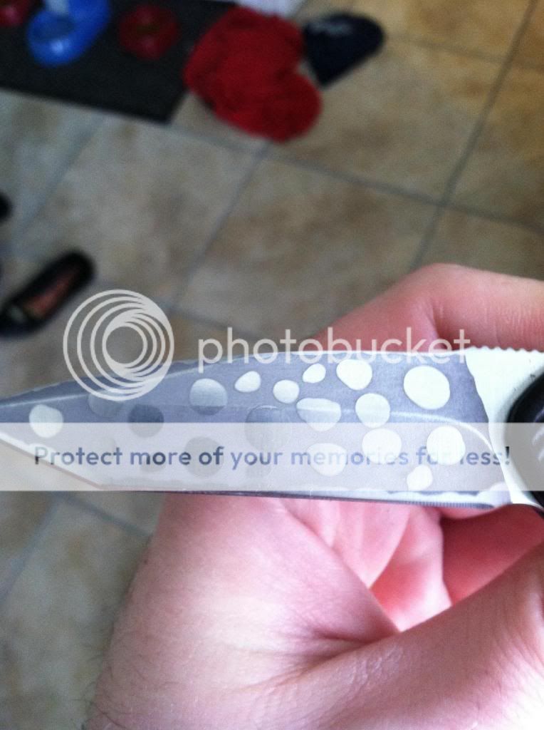

I use a mix of nitric and muriatic acid to etch all my steel, including D2. And yes ‘Toxic’ is it’s middle name. It’s like saying you want to reload ammunition and wondering if it sounds a tad explosive. I did it indoors once, and the fumes killed every plant in the house . Imagine what it does to eyeballs, lungs, and fingers. Part of the beauty is what it cost to get there. Part of why not just everyone does it, why you do not see it around a lot, and why it cost when you buy the finished product and need a nuclear permit to mix it. Yes. I suggest everyone else choose the easy way (smile). I wear a mask, use a fan. But suspect some nerve damage after 40 years. Rats. But probably done more damage to my eyes looking at women. I got no complaints. How can anything eat steel and be safe? I mean geez. Yes the radio shack PCB etchant works, but not as well. Yes, I suppose I expect dead silence at my comments, but figured I’d toss in how I do it.
here is a link to the etching part of my web site http://www.milesofalaska.net/Custom_knives/custom_etching.html
Above is etched D2
