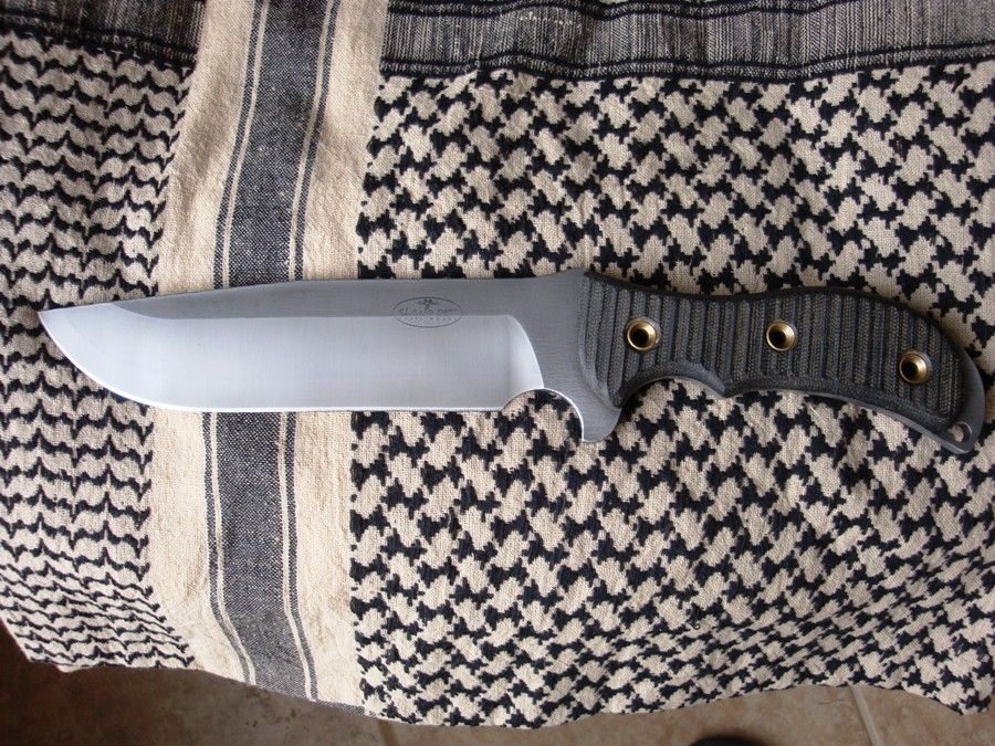

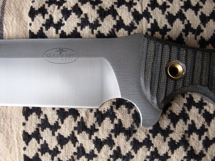

Here is a Ratweiler that I etched, blued the logo, stripped and applied a scotchbrite finish to a few months ago. :
When you etch the stamped SRKW logo you just pool/rub the PCB Etchant onto the logo and allow it to soak for awhile? Is that the etching process? Then after the blades stripped the etched logo remains correct? If so at what point does the blueing process take place?
I let the etchant solution simply set in a pool on the exposed raw steel logo. That is the etching process. It reacts with the metal and begins to basically eat away at the raw steel. Once I get it to the depth that I want it, then I blue it which only take a few minutes. After it is blued, then I strip the paint. The bluing is not effected by the paint stripper so it remains blued after the paint is removed.
