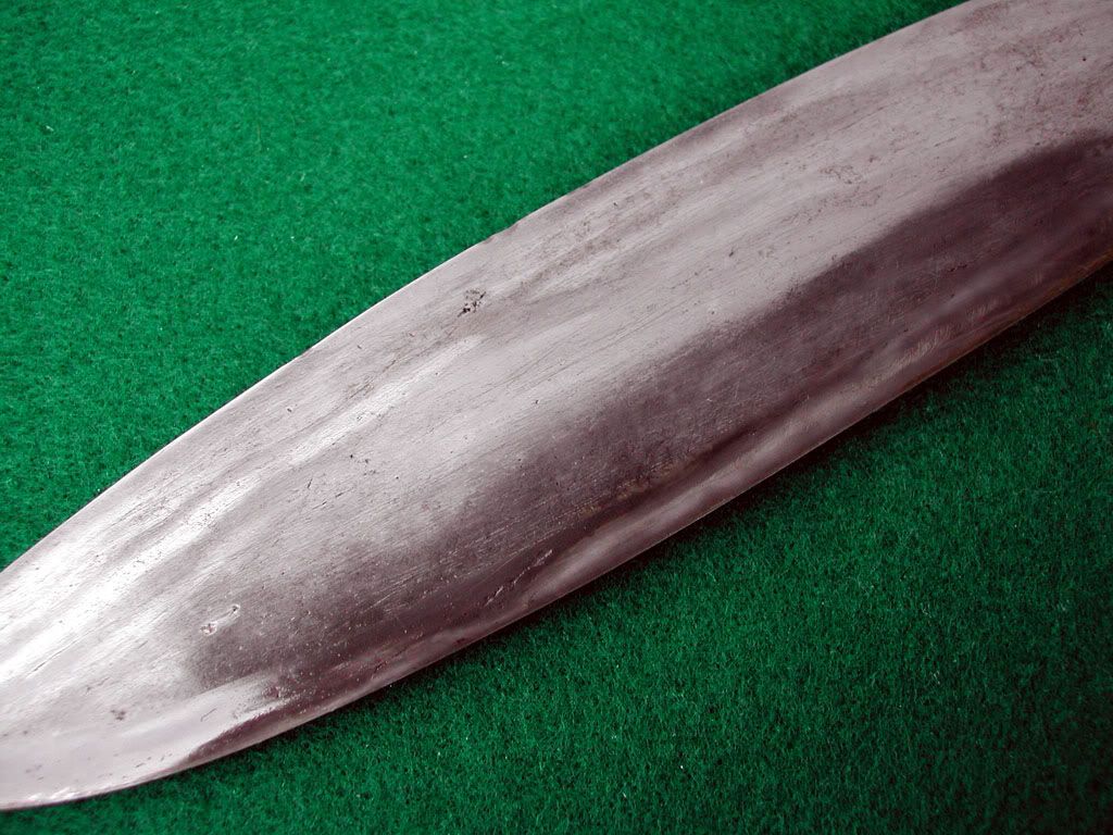

Here's an antique khukuri that has been etched.

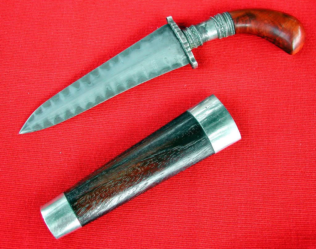

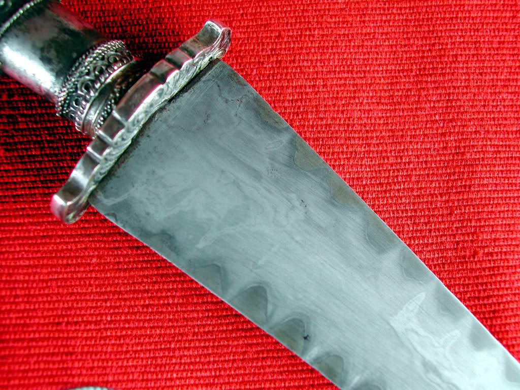

Here's a Philippine gunong that amazed me when etched. The most beautiful "horse tooth" pattern I've ever seen. The knife was a gift from a very good friend.:thumbup:
That's why I etch.:)
When you etch an HI blade, you see what portion of the blade has been hardened.

WOW! Steve, the pattern on the gunong is fabulous.
