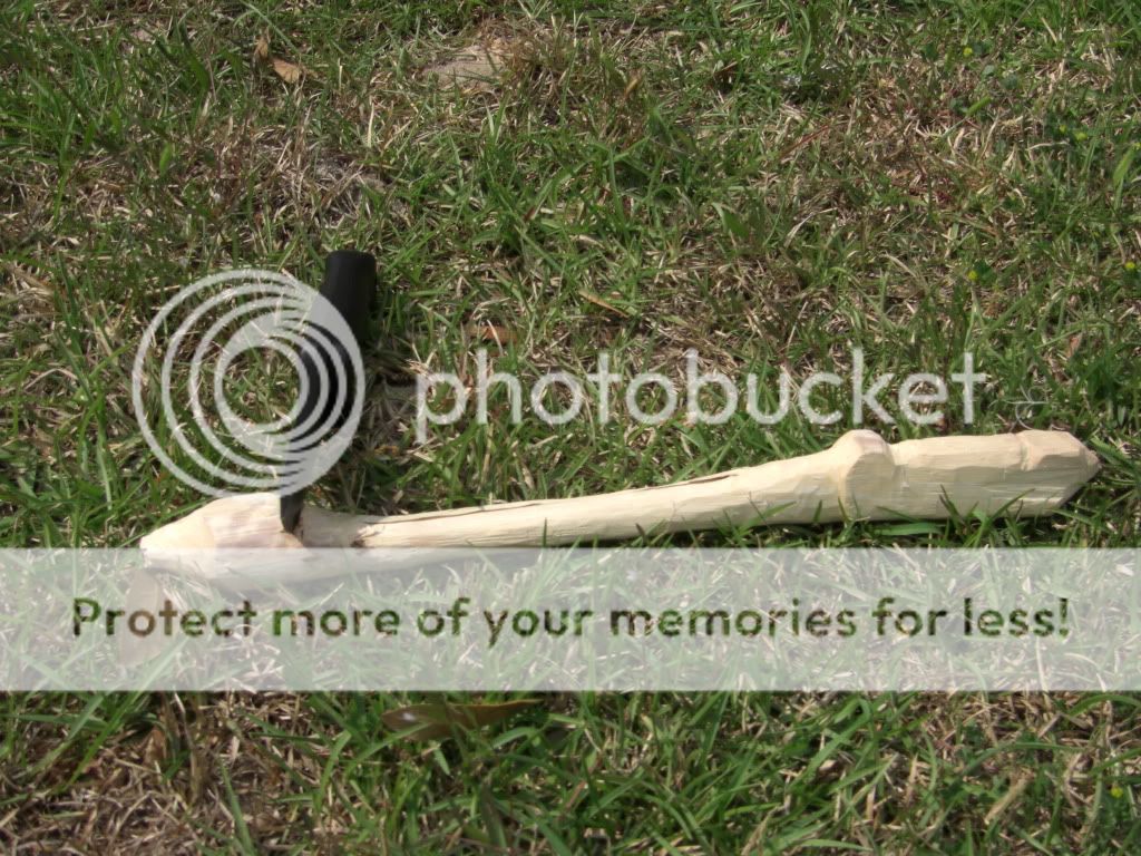

The idea was that I would be able to fit the end of the dar tin here, and have the length of the atlatl hold it flat and steady. The curved down handle keeps the fist out of the way, but lets you steady the dart with your fingers.

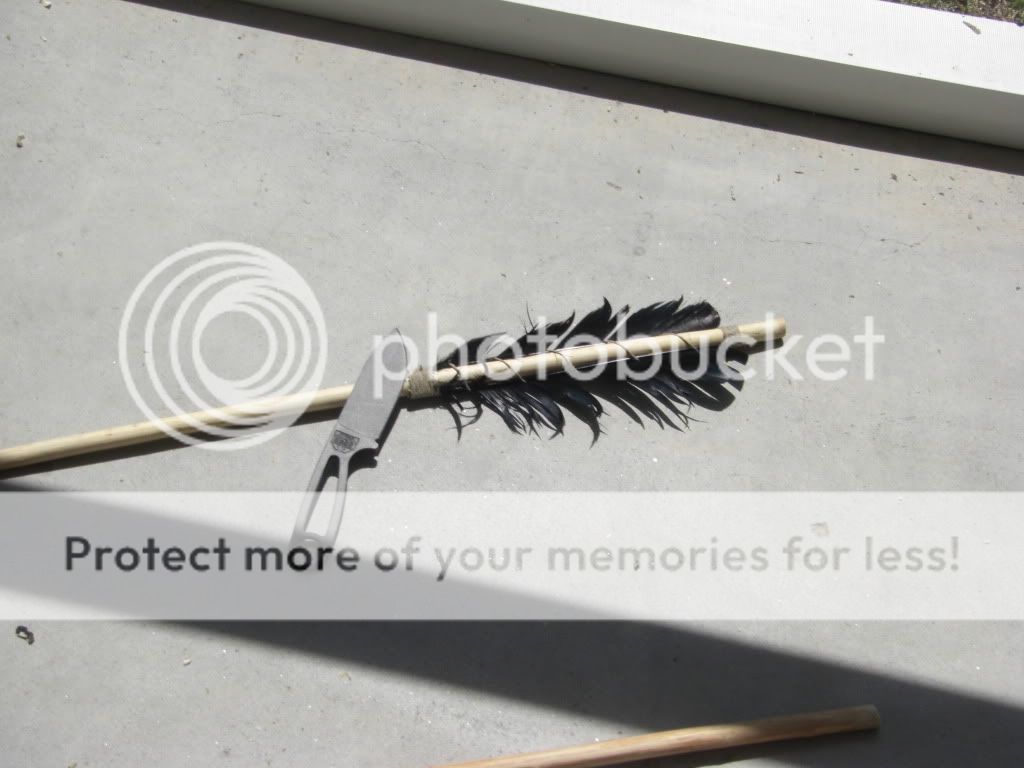

No flint, no obsidian. A sharpened tip would have to do for my purposes. A few throws in the dark proved that it would stick. It won't take down any deer, but if you're not careful, it will put your eye out. The feathers are from a recent pheasant hunt my father-in-law had.

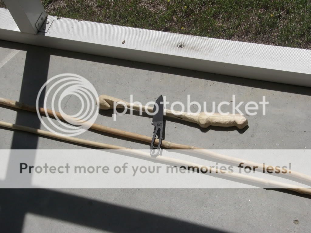

A final shot of the device. I think in the end, a more traditional shape would have been better. I would also have liked to get a hold of some obsidian and try my hand at a head. I certainly got the shape that I wanted. The physics behind it seem fairly sound, but then again, I never took physics in school.

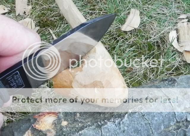

I started with three branches chopped down with the BK9. Two were from my neighbor's Beech tree and one was Red Oak. I selected the beech because it was green so it would be the fastest to work.
I stripped the bark and then shaved both sides down by chopping deep marks and then planing them away.
Then I switched to the Eskabar to give it some more shape and smooth it all out by scraping with the edge turned 90deg.
Shaping the inside and outside of the shoulder curve was really easy with the thin polished edge of the Esky.

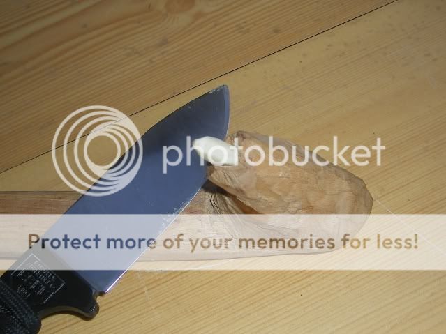

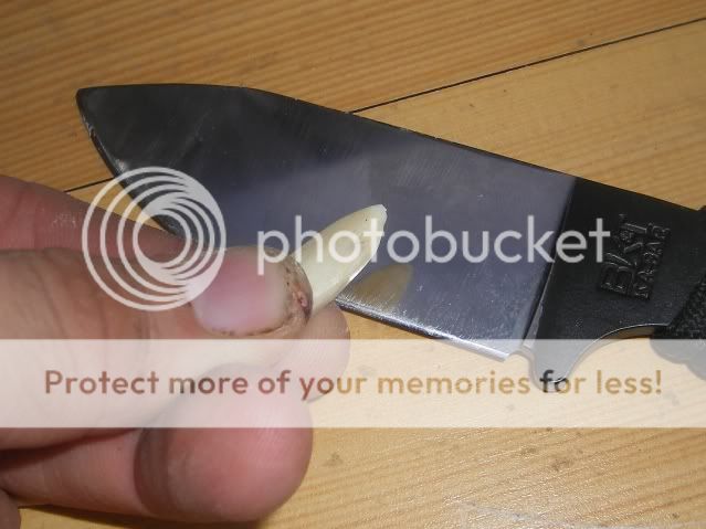

Drill shallow hole with tip
Use spine to break bone, then scrape on concrete to shape
Now, use squirrel gut cordage to bind crack in atlatl head from pushing the spur in to far

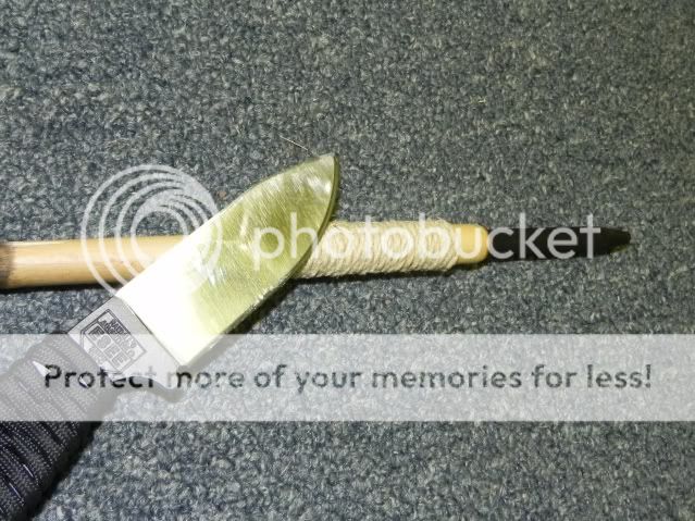

Time for the dart!!! I used a 5ft long shaft of Phragmites that was growing at the end of my street. I wrapped the head with yucca cordage and made a field point of fire hardened oak

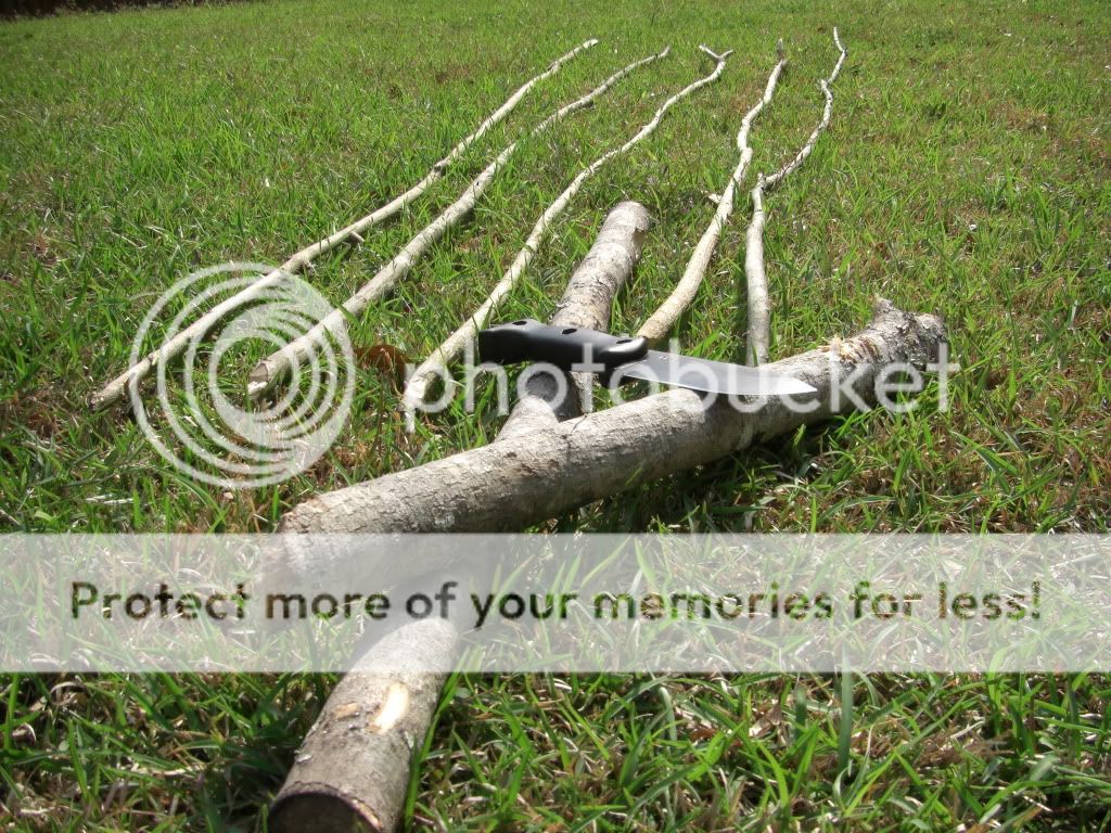

Here's some wood harvested from the woods just past the fence.

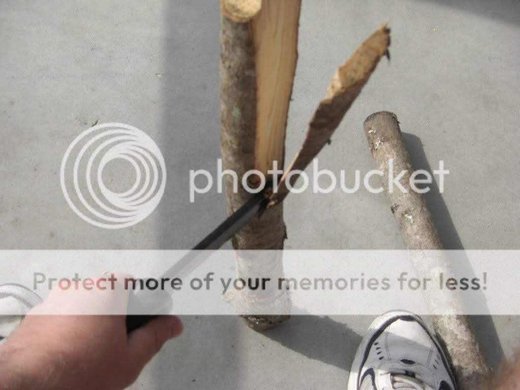

Getting started with some batoning.
I had to do some choppin'(this bk9's debut photograph)

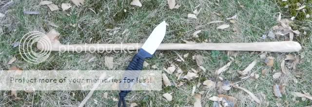

Here I've thinned the shaft to reduce weight...also worked on the "ergonomic handle".

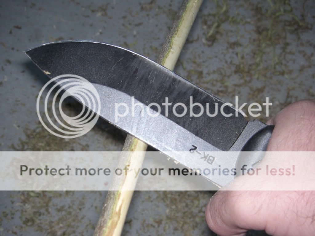

I'm scraping the bark from this green piece that came from a swampy area of the woods.
all of the bark is gone, and posing with the atlatl and ESKabar
