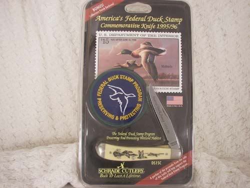

Even I can tell the Date this one was made
Oct 23, 2003
157
I have always envied you guys who can remember all the details of when a knife was made, how many, and so on. This one I just picked up from an estate sale solved my problem. The blade reads Federal Duck Stamp 1995-96. That gives even me a pretty good clue.
I love dated blades or handles. Takes the fun out of it for some of you but for me it is a great find.
Great find. Anything to make the dateing easier is a plus.
TTYL
Larry
Even without the dated package and blade etch the logos and markings on the package give good clues. That corporate logo on the bottom left for instance. First noted use was circa 1990-91, but they added the tiny "est. 1904" circa 1992. The papers and rear of the package have the Schrade website after mid 1998.
By the way there are some knives in this series you still need. :D

That is a lot of great back ground information. I did suspect that there was a good chance that knives were made before they were packaged for sale. When you mentioned the change over to Duffy I pulled out the loop and could see that this one is signature dated J Duffy 93. The one you have pictured? Is that the same signature date too?
I do not collect these so this one will mostly end up filling out someone else's collection.
Looking over the Schrades R us site I see the name of the pattern changes with the design on the handle. The one with Crappies is called the 503SC crappie, ect. Is the basis pattern called a Slimline Trapper?
Your response was greatly appreciated. I have printed it for reference.
Thanks,
Ed
