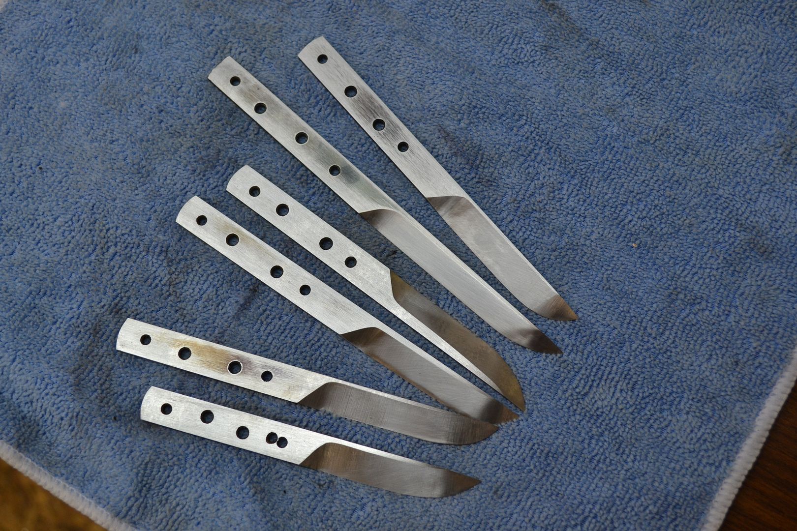

I'm slowly getting there on the Kogotanas.

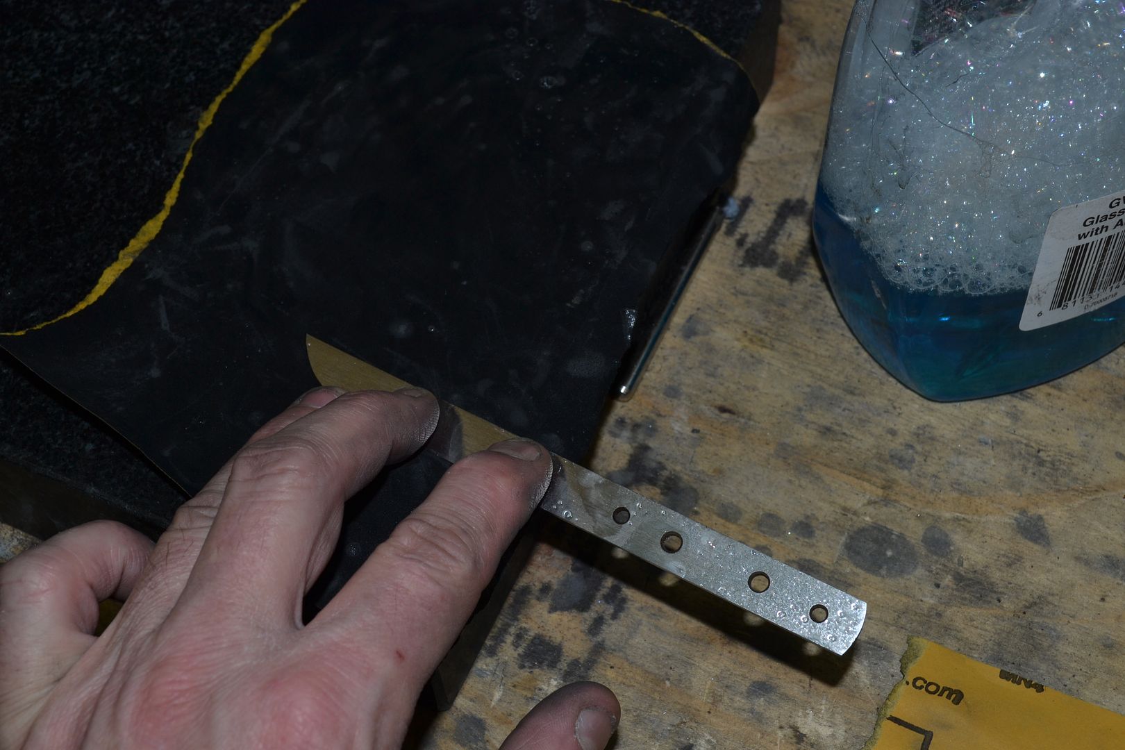

Hand sanding setup - granite surface plate, windex, sandpaper... gets a flat grind very flat! I'm also using stones on some for finishing.

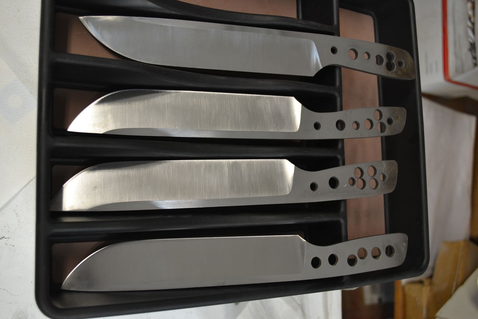

Camp Knives! I'm thinking about doing a sign up for these, let me know if you are interested! They are saber chisel ground.

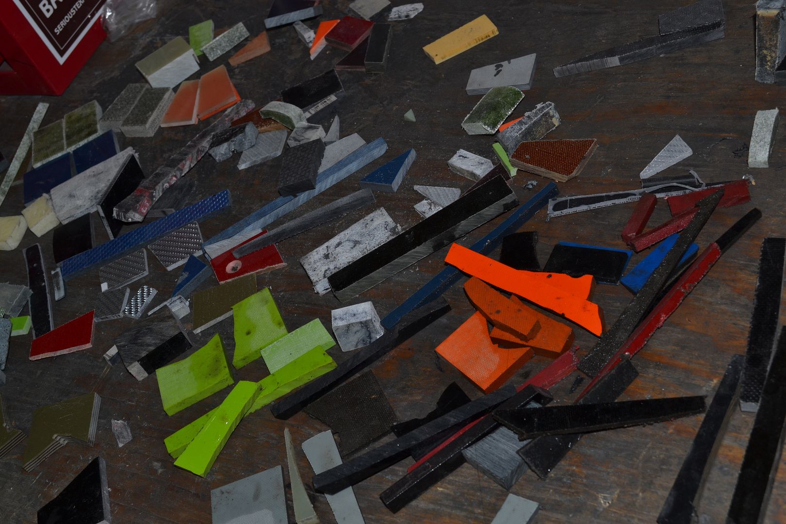

Just a fun pic... I was gong through my scraps thinking of bolster and liner ideas
Those Kogotanas look like they are going to be wicked little slicers! The camp knives ,well.....I'm just kinda speechless.:thumbup:

Which steel are these? I'm not a steel snob but I couldn't help myself from asking.

Thanks! I sharpened one of the kogotanas for testing and it was nuts!
make backspacers from the scrap too. maybe even thin scales for the kogotanas.
Will do! I have one set of twill scales with bolsters in thee!

.125" A2 for the Kogotanas and .187" O1 for the Camp Knives...

I consider doing G10/micartaon most, maybe copper on the large one.

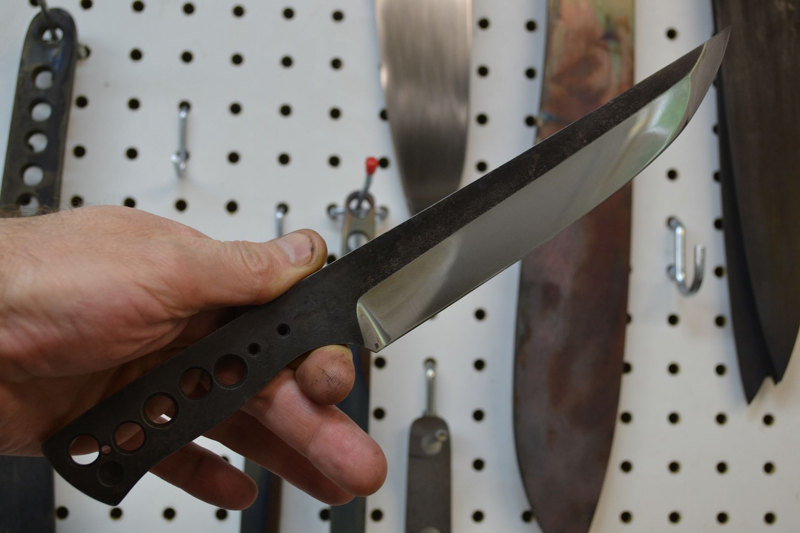

Trailing Point in .27" 5160 steel!
Wabocho money shot... the heel profile.

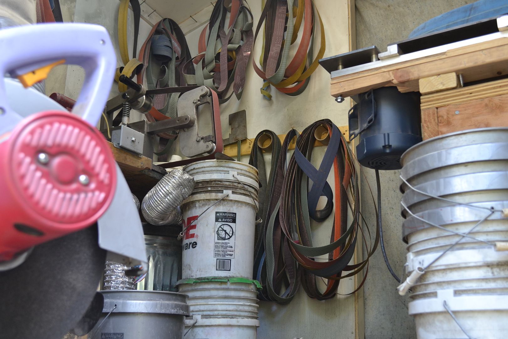

The Control room!

WANT that trailing point, bad!:D I'm loving that point design. And one of those behind your hand in that pic. And...
