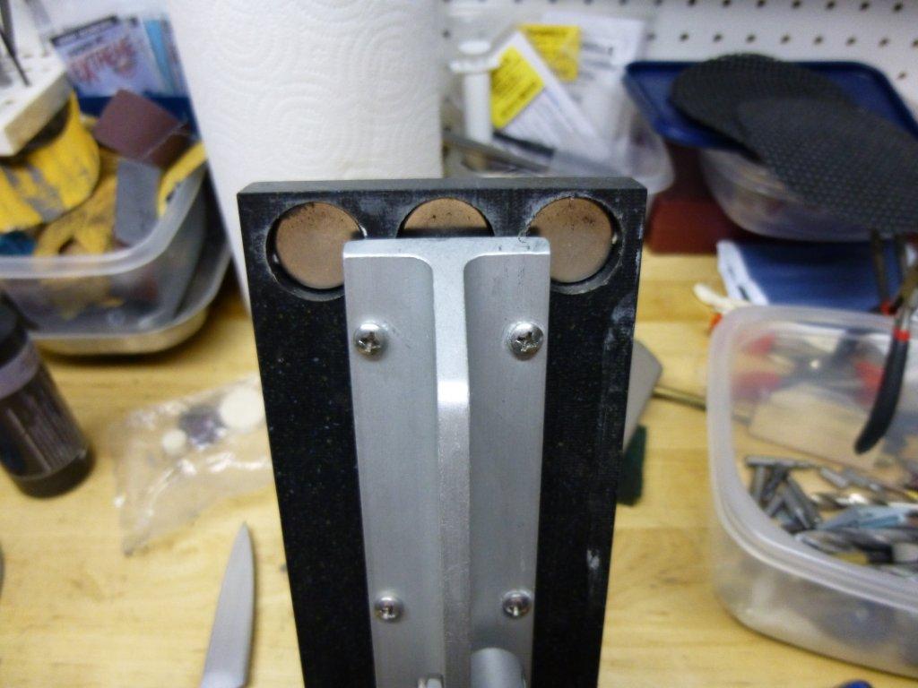

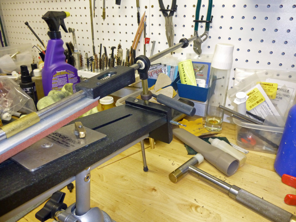

This lead me to, rather, brought me back to the Edge Pro. I've purchased the spring, shaft collar, Angle Cube, and several EP and Congress stones. I'm sure that everyone has their sweet spot between a smooth river rock and a $2000 motorized sharpener, and I think that mine is the Edge Pro. I enjoy the entire process of sharpening edges on this thing. The amount of time that it takes to progress through the stones paired with the actual switching of the stones/blade position is right up my alley. I've been looking for ways to get better results via mods/hacks/upgrades, and here's what I've found so far:

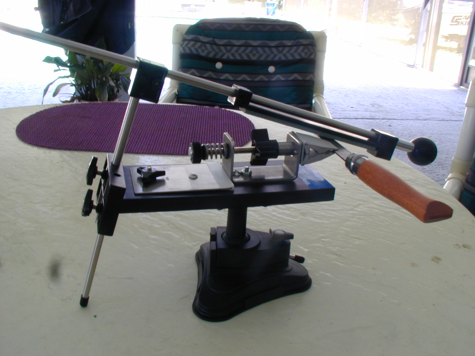

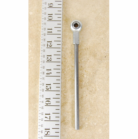

Different take on the spring mod:

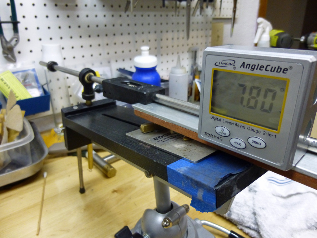

The Angle Cube - I use this with every stone change.

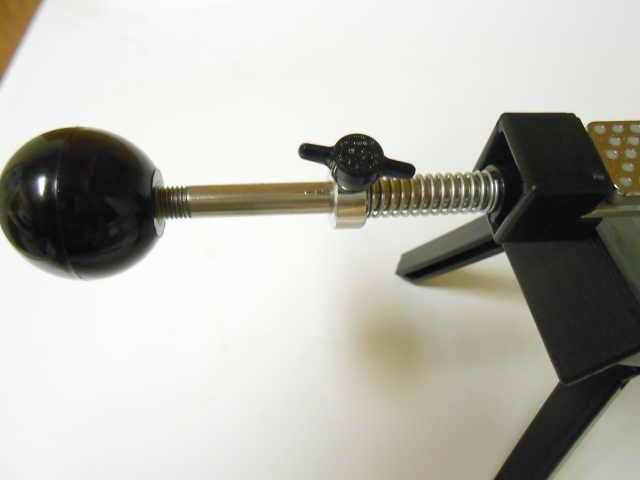

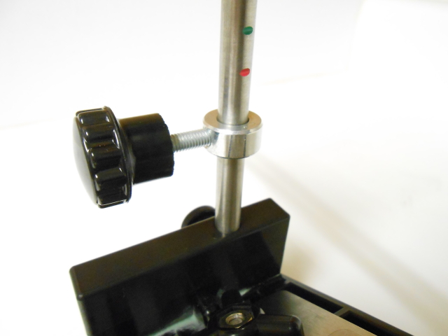

A sort-of quick release for the drill stop collar.
A turning knob for the same effect.

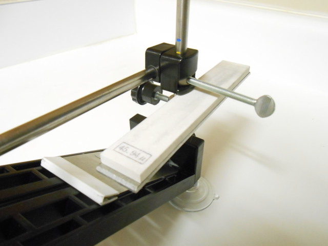

A stand alone photo of the stone arm pivot that is no longer available from CKTG.

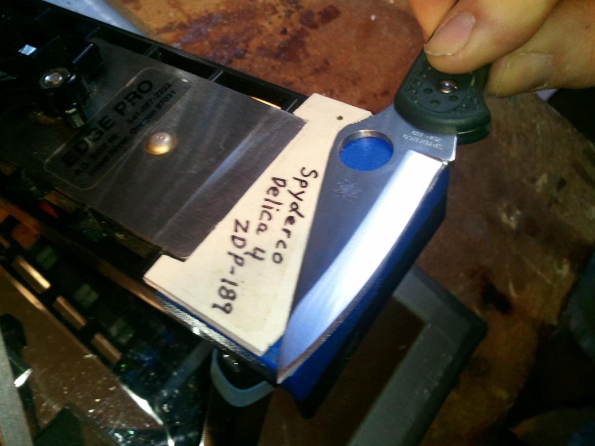

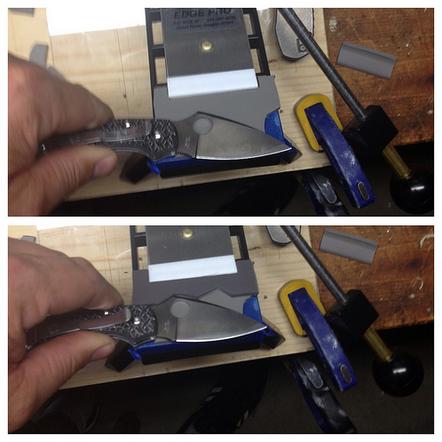

A mod for keeping the edge of your knife aligned with the edge of the blade table.
A variation from above. The outline of the blade is mirrored on both sides of the guide.
A home for the neo magnets on an EPP.

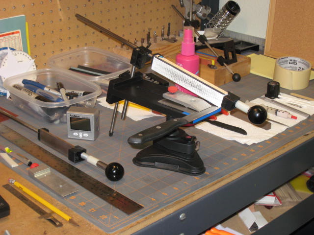

After seeing so many different homemade variations of the system, I've decided to make my own. The last thing left to order is the blade table and the upper base/shaft that it sits on. I'll keep you posted.
