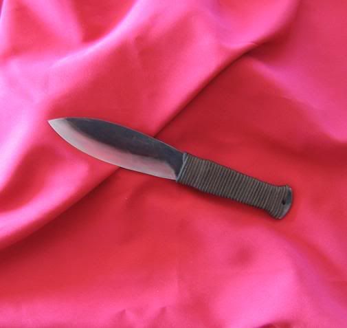

I am a beginner at knifemaking and would like to share with you the evolution of my "Bushknife". This is only the seventh knife I've every made but this one in particular has alot of meaning to me as you will see.

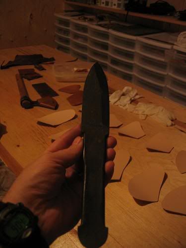

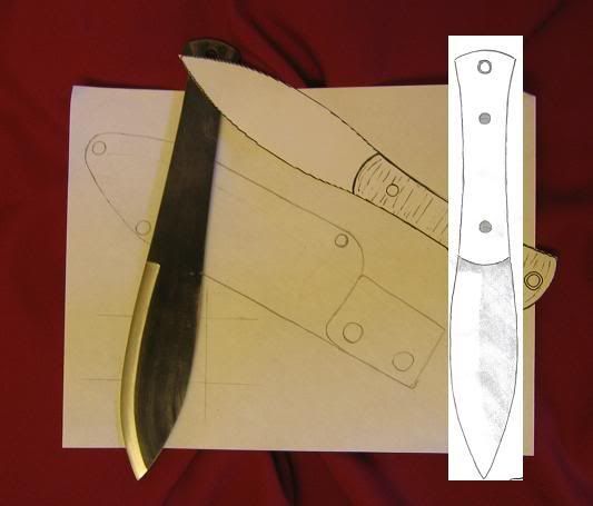

The descision to make my own Bushknife started out as a few drawings. I wanted it to be a little beafy but not too clunky. Eventually, I cut out a blank to get the feel for the knife...
Unhappy with the flow of the knife I decided to blend the lines in and make it more organic. It was at this point that I made the descision to go with a cord wrapped handle. This was going to be a survival knife and I wanted every component to have multiple uses. It was going to be my carver, chopper, prybar, digger, thrower and striker for traditional "flint and steel".

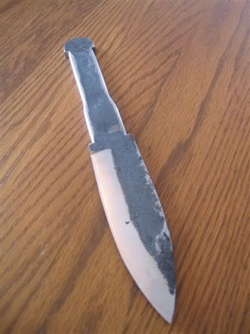

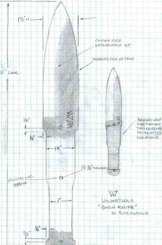

My first intention was to harden the spine of the knife for use with flint and steel... but because it needed to be strong and flexible I had to change my design and incorporate the striker into the pommel of the handle. This way I could fully draw back the hardness on the spine to make it felxible and tough as nails. The cord wrap was slipping after heavy use and a few throws and since glueing would render the cord useless for survival scenarios... It was back to the drawing board....

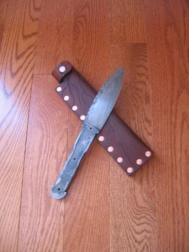

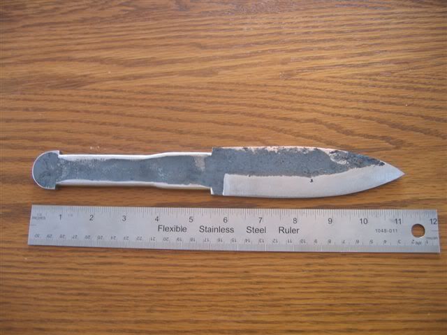

I made a handle channel for the wrap to seat itself and get locked into position. I also included a palm swell toward the front of the handle to improve grip. The ends of the cord would be fed through the holes and melted in place. With the help of Master Bladesmith and new found friend, Wally Hayes, I forged the knife and began what I hope to be the final design for the Buskknife..... we'll see.

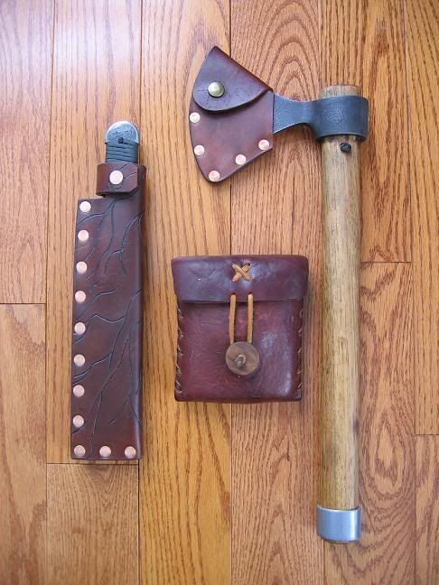

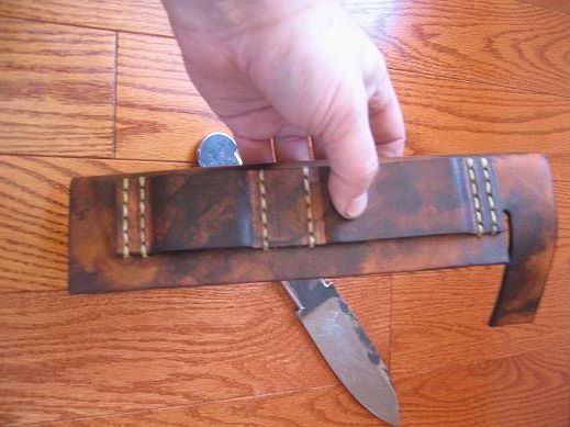

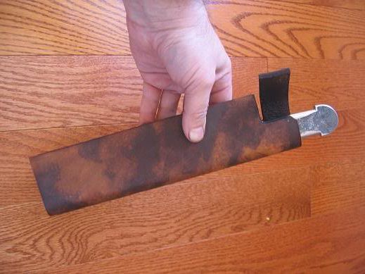

Here are some pics of the sheath I made for the knife... After lots of measuring, cutting, dyeing, glueing, sewing and riveting... I totally SCREWED IT UP when I applied the hot wax dip ... Yes.... I had the mixture WAY to hot and the sheath shriveled up like a raisin ... You learn from your mistakes... That was the first time that ever happened to me.... snif, snif.

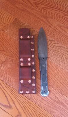

At this point the knife has been heat treated and is ready for finish grinding... a NEW improved sheath (totally riveted) was made with a successful hot dip this time ... whew...
